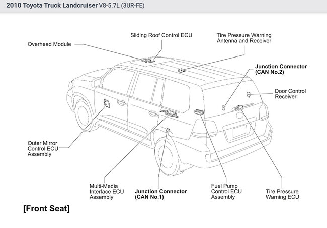

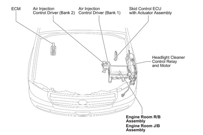

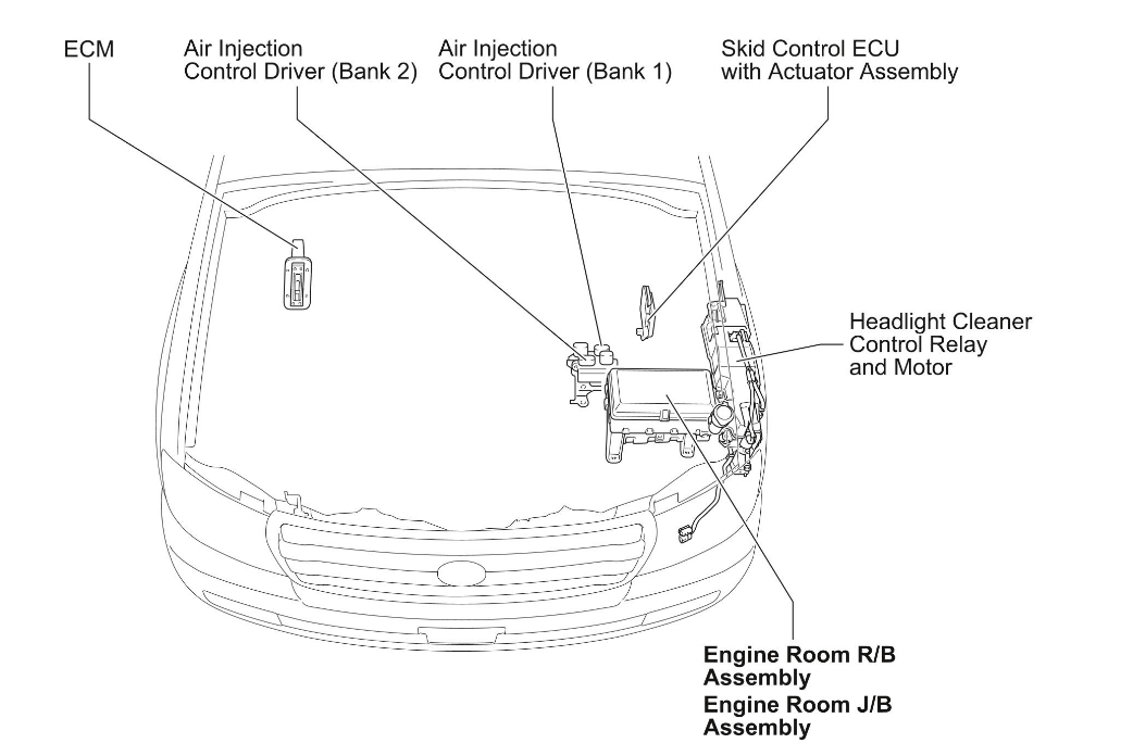

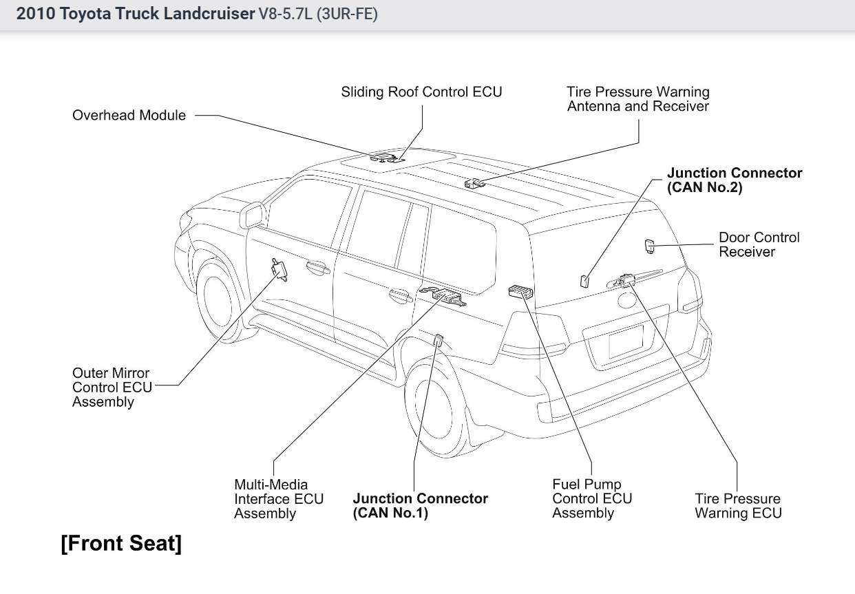

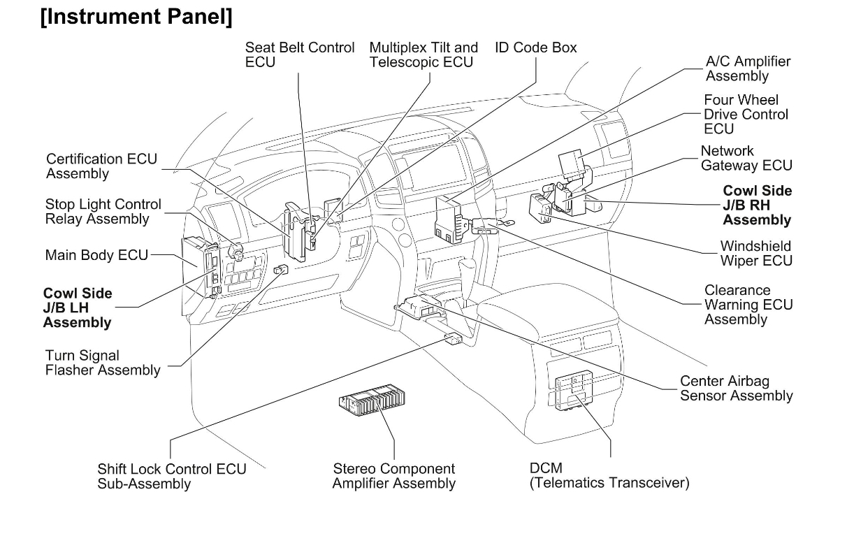

It sounds like the PCM when out or you have a turbine shaft speed sensor that has gone out, but we need to run the codes to see what comes up to help fix the problem. You can get a CAN scanner (Controller Area Network) which will work on most cars from Amazon.
Here is a video to show you how:
https://youtu.be/u-4syLc-ifQ
and
https://www.2carpros.com/articles/can-scan-controller-area-network-easy

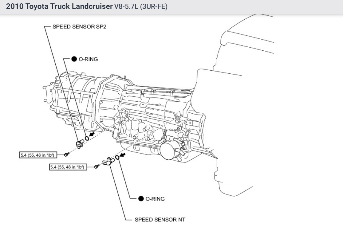

Here is the location of the shaft sensors so you can check it out and replace the sensor if needed if that code comes up. Also, check the fuses with the system on.
Check out the images (below). Let us know what happens and please upload pictures or videos of the problem so we can see what's going on.
