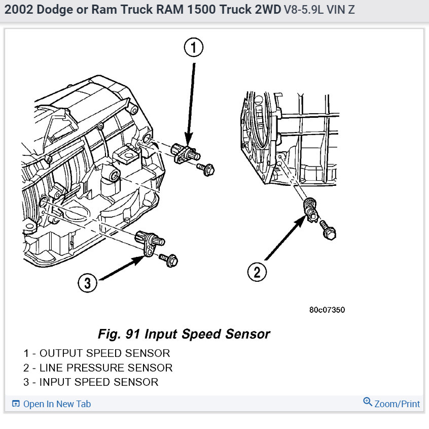

It does not sounds like it. Do you have a check engine light on? Because it sounds more like the turbine shaft speed sensor is going out. Lets run the codes to see what comes up. Can you please shoot a quick video with your phone so we can hear the noise? That would be great. You can upload it here with your response.
Here is the location of the sensor so you can change it.
