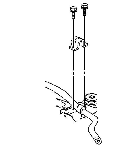

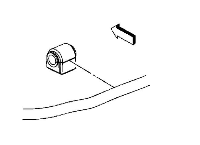

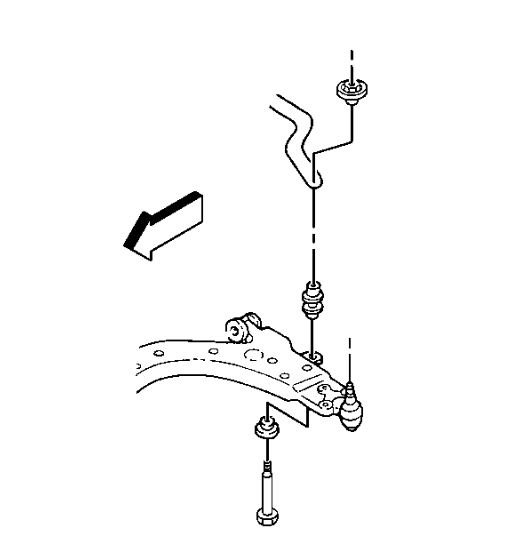

Every time i go over a bump i hear a knocking noise coming from the front and back end of my car. I've had all struts replaced with KYB strut plus and the issue still remains. My sway bar has a crack in it so i don't know if that is my issue for the front or not but the back i still have no clue. Would my car happen to have both shocks and struts that i need to check out?

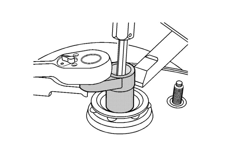

Were the strut mounts replaced when the struts were installed? That is common.
Yes, the sway bar can be the noise. Replace that.
