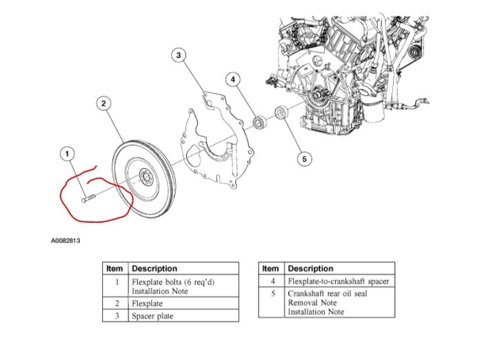

Okay, this noise may be coming from the flywheel. It may be loose or the bolts attaching the torque converter may be loose.
https://www.2carpros.com/articles/how-flexplates-work
this video shows the job step by step on a similar car with diagrams below for your car.
https://youtu.be/3vJAojsrfuU

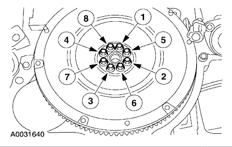

1. Install the flexplate. Tighten the bolts in two stages in the sequence shown.
^ Stage 1: Tighten the bolts to 13 Nm (10 ft. lbs.).
^ Stage 2: Tighten the bolts to 71 Nm (52 ft. lbs.).
The torque converter bolts are 20 pounds to tighten up.
These bolts being loose will cause the noise. Check out the diagrams (Below). Please let us know what you find.
