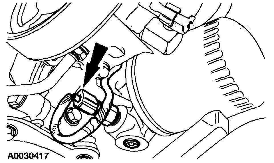

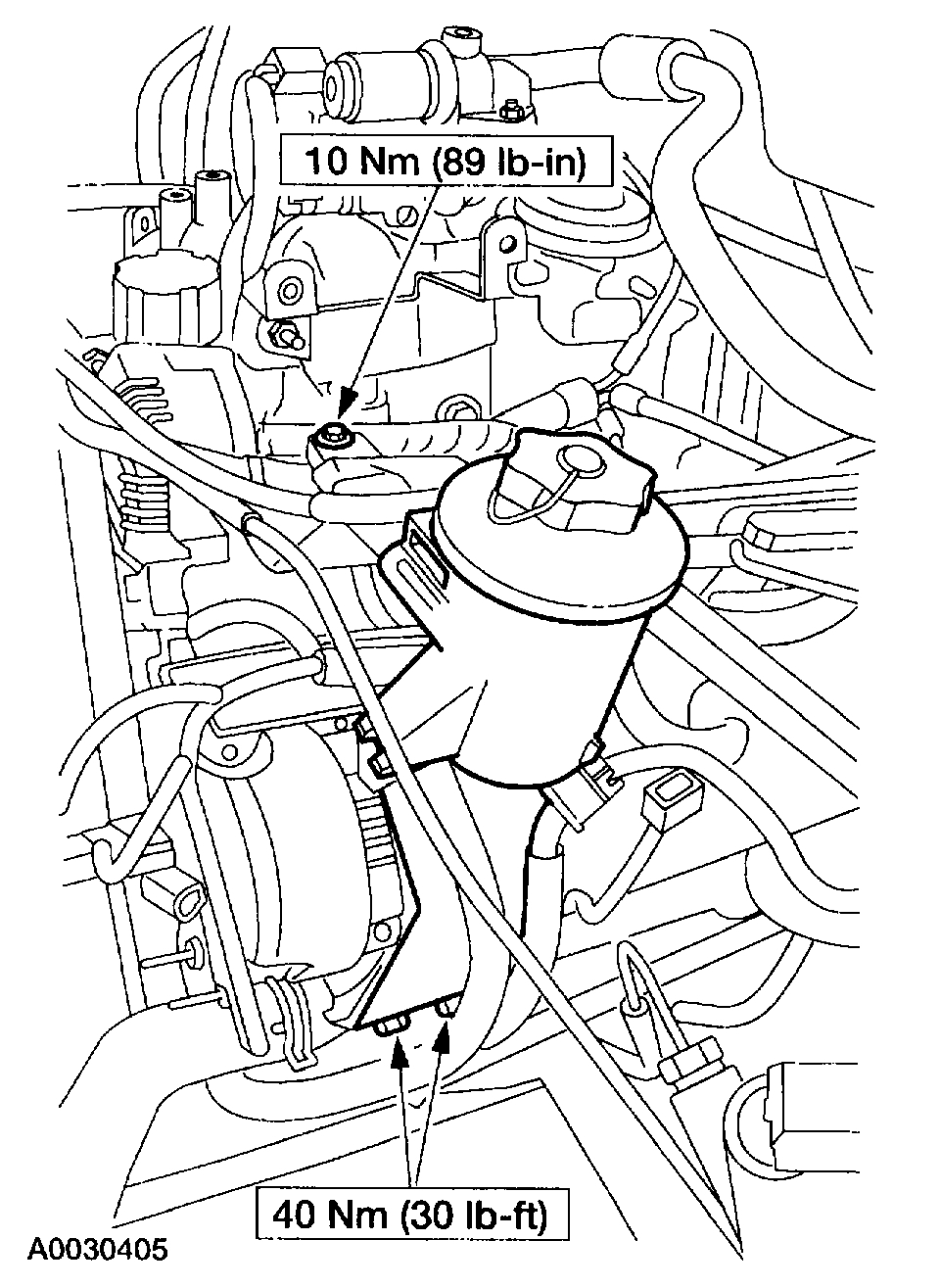

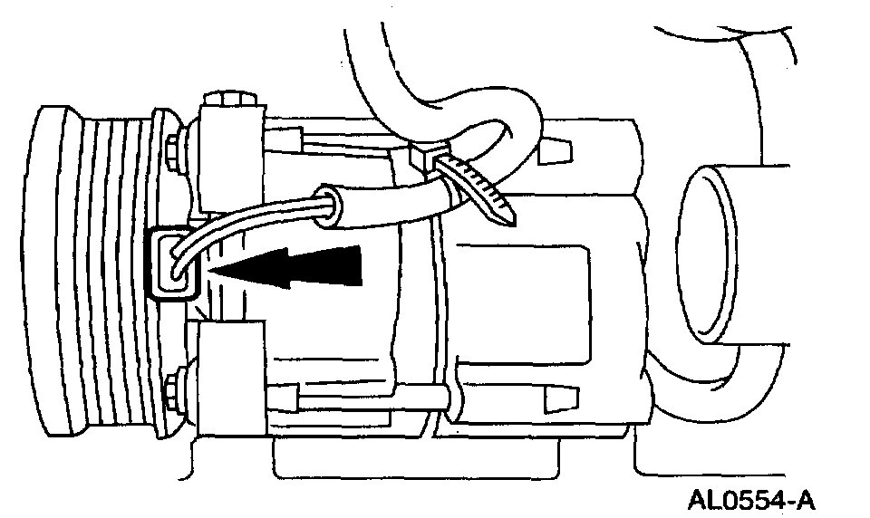

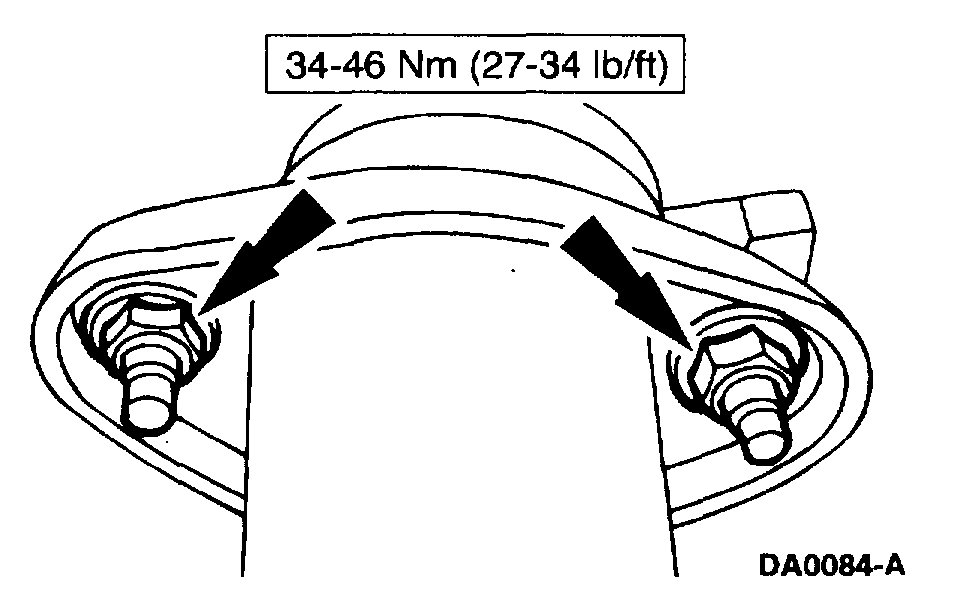

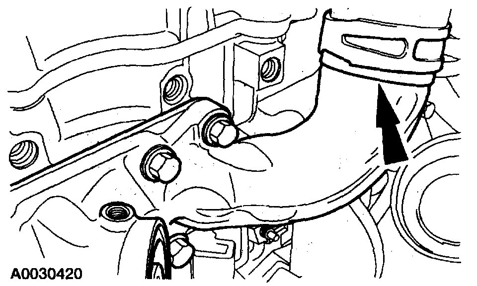

If you decide to do this, here are the directions for the removal and replacement of the engine. The attached pics correlate with the directions.

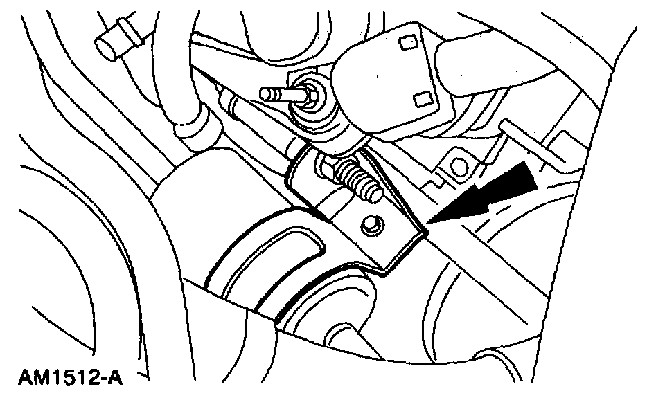

pic 1

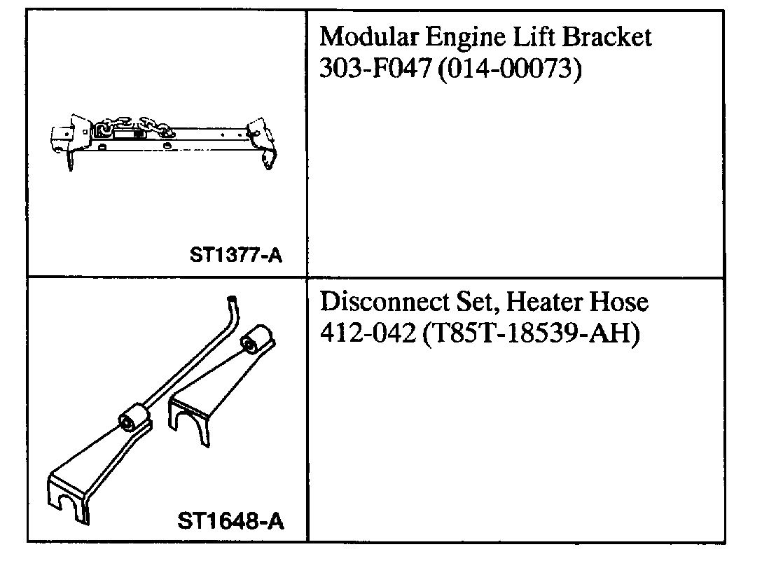

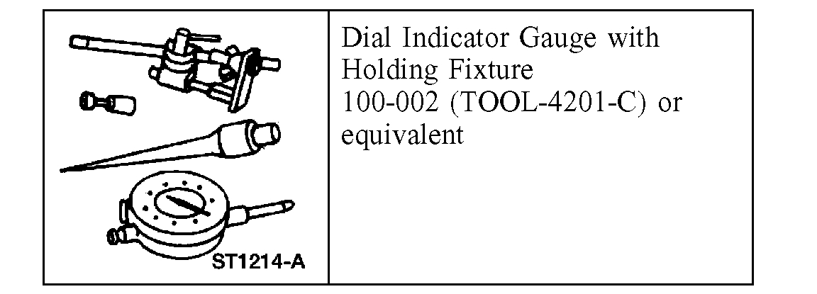

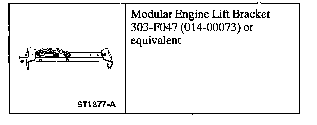

Special Tool(s)
Removal
1. Disconnect the battery ground cable.
2. Remove the hood.
3. Remove the engine air cleaner.

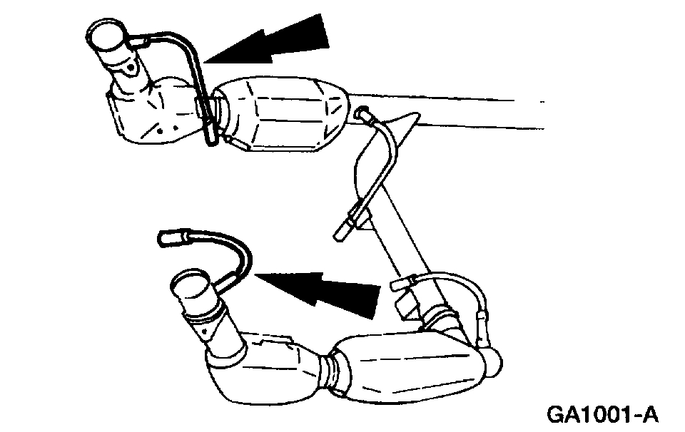

4. Remove the A/C condenser core.

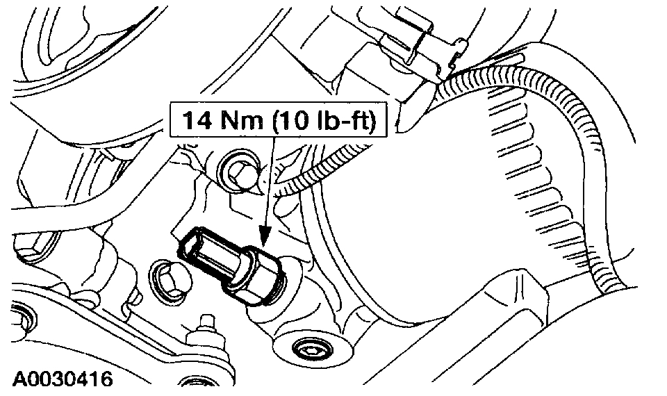

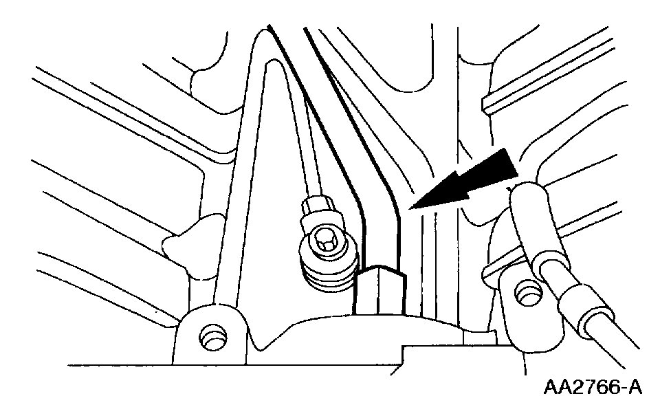

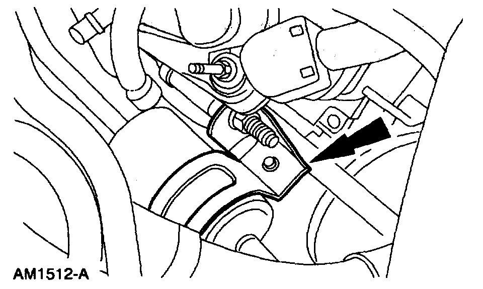

pic 2

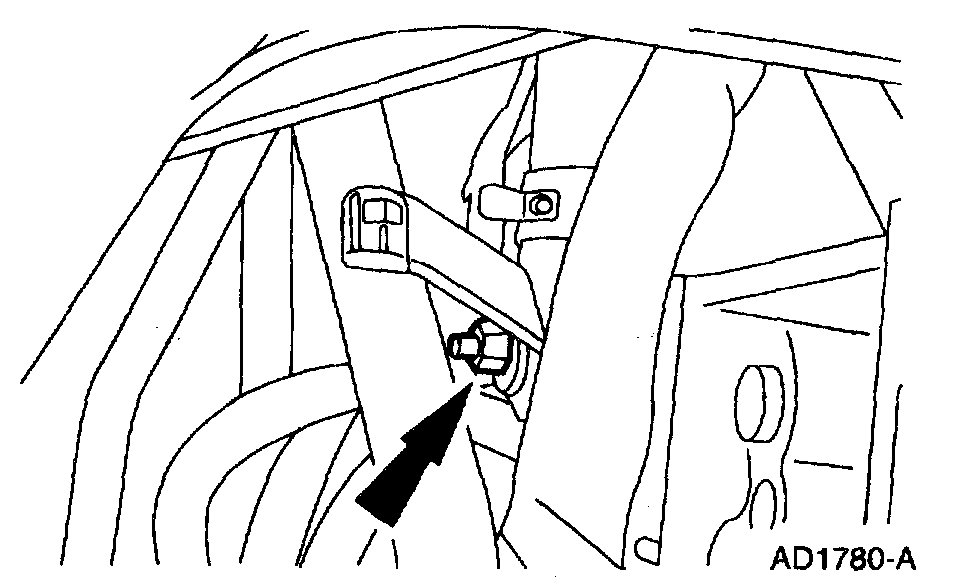

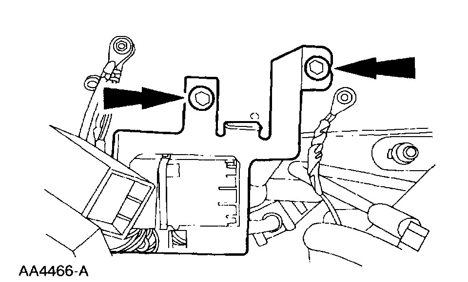

5. Disconnect the climate control vacuum connector.

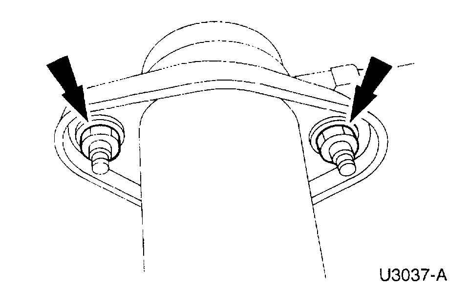

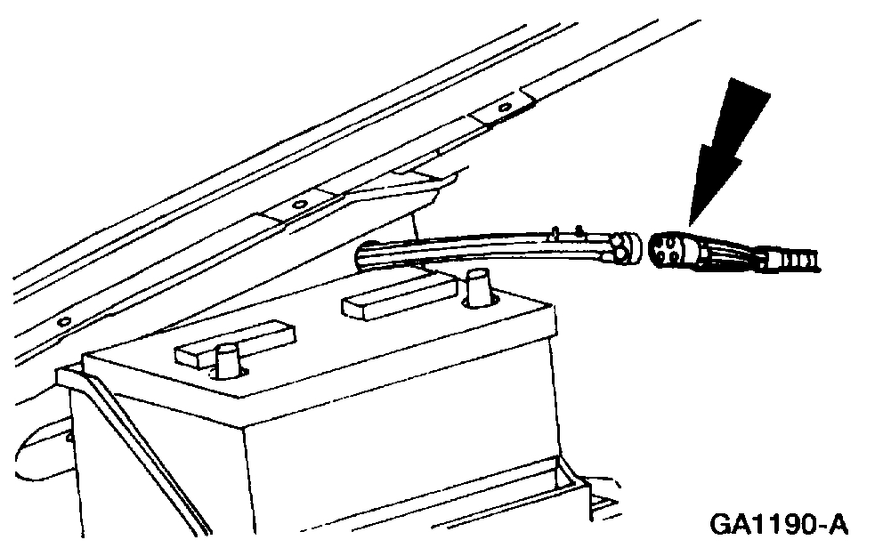

pic 3

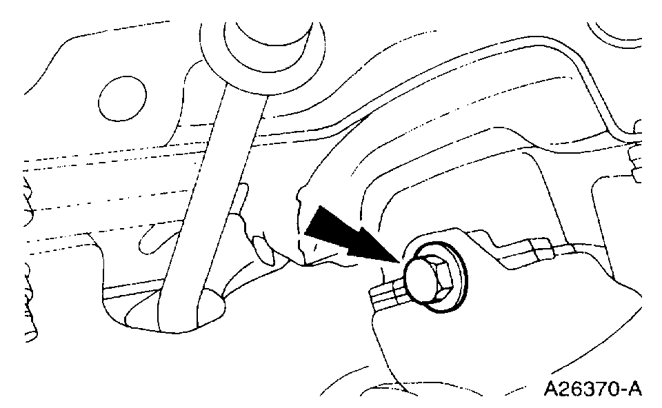

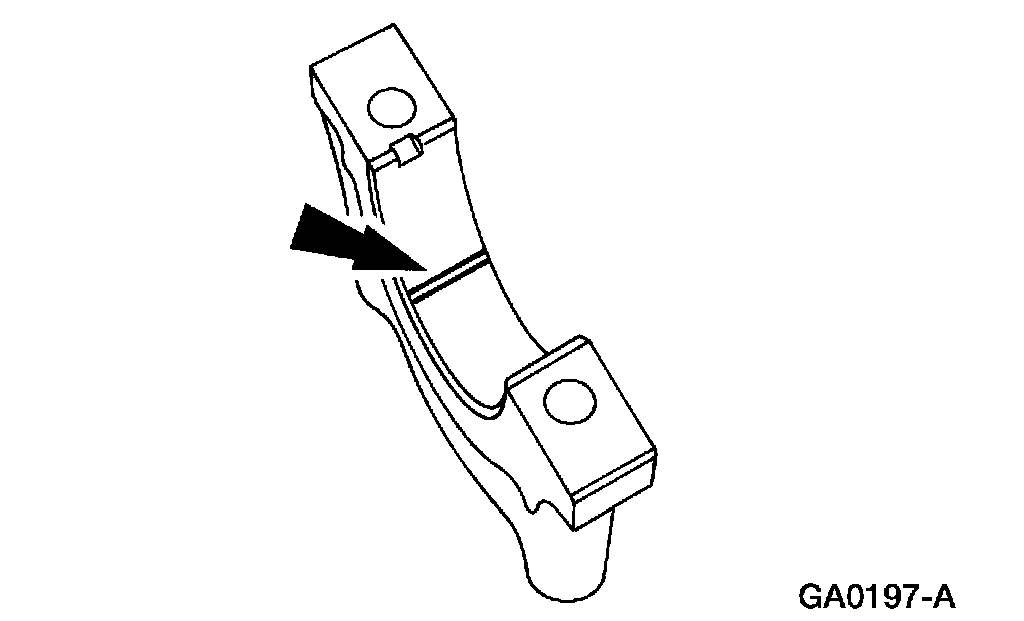

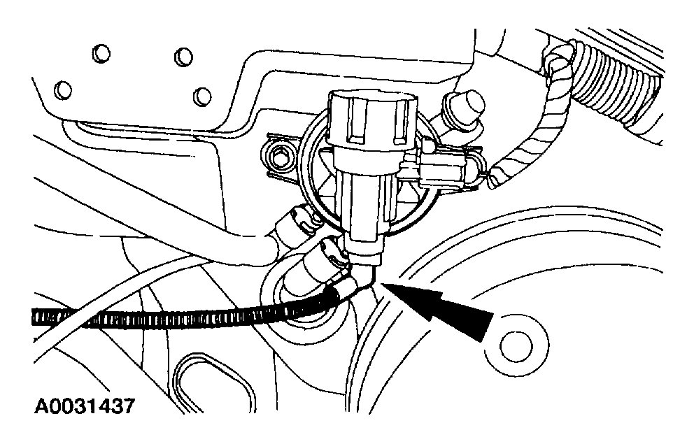

6. Disconnect the evaporative emission canister purge valve vacuum connector.

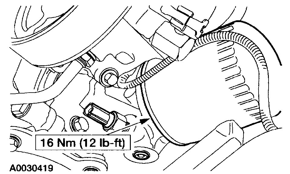

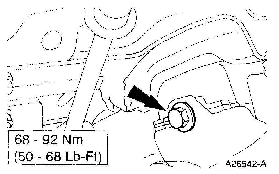

pic 4

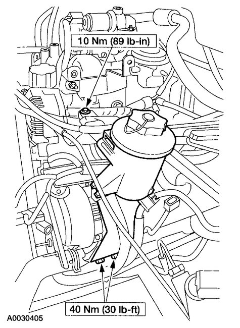

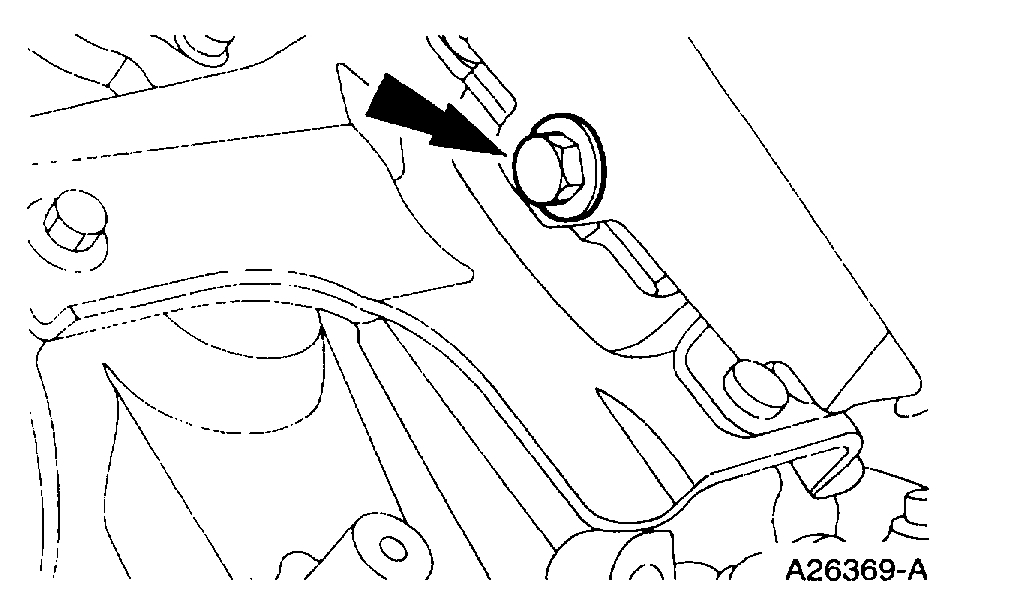

7. Position the power steering reservoir aside.
^ Remove the upper bolt.
^ Remove the lower bolts.
^ Position the reservoir aside.

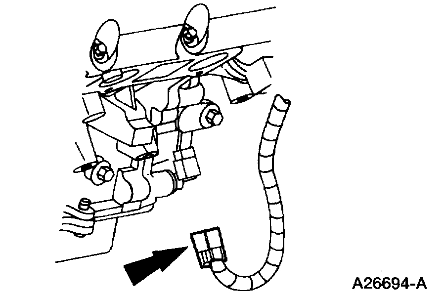

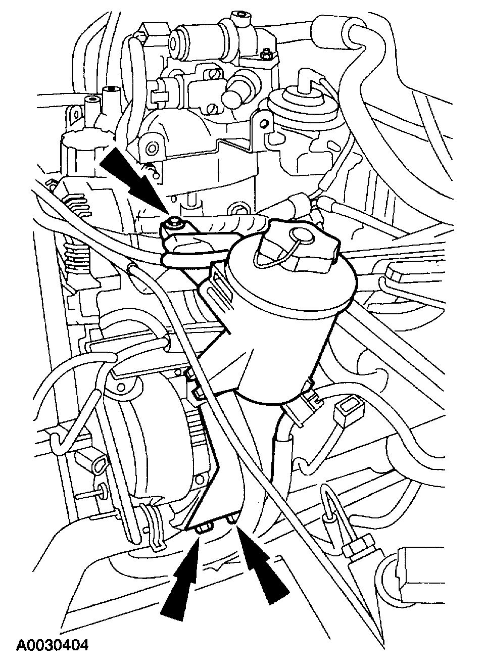

pic 5

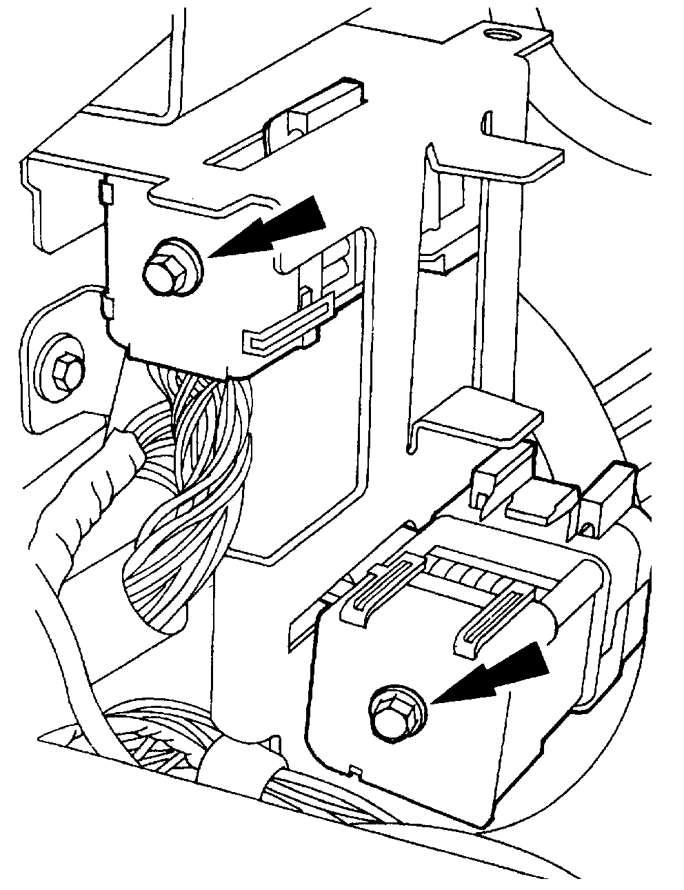

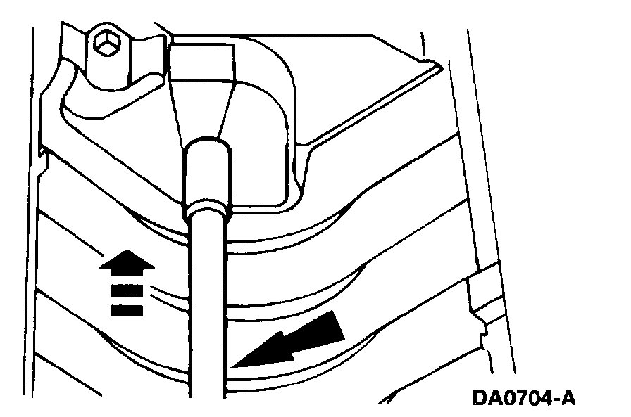

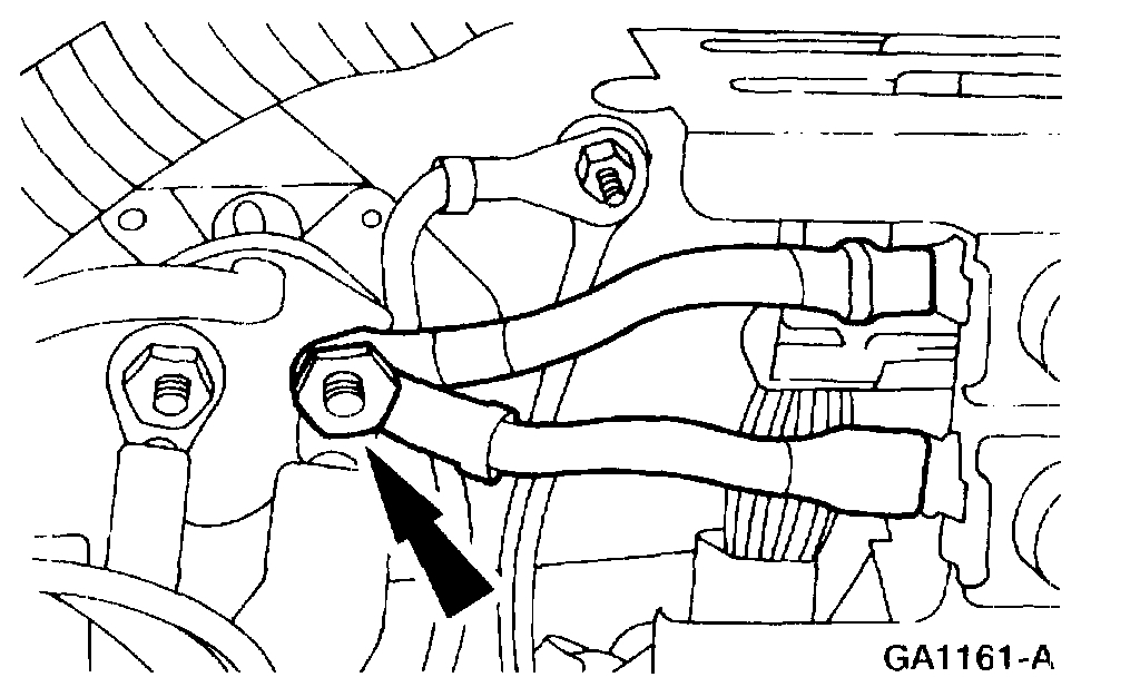

9. Disconnect the two starter cable leads from the starter relay.

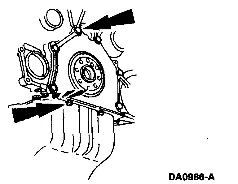

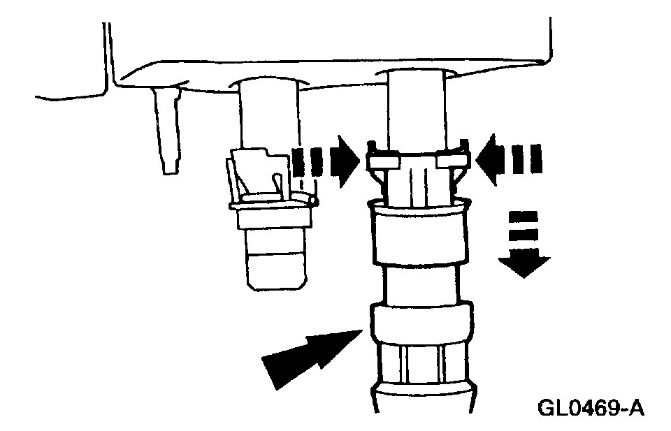

pic 6

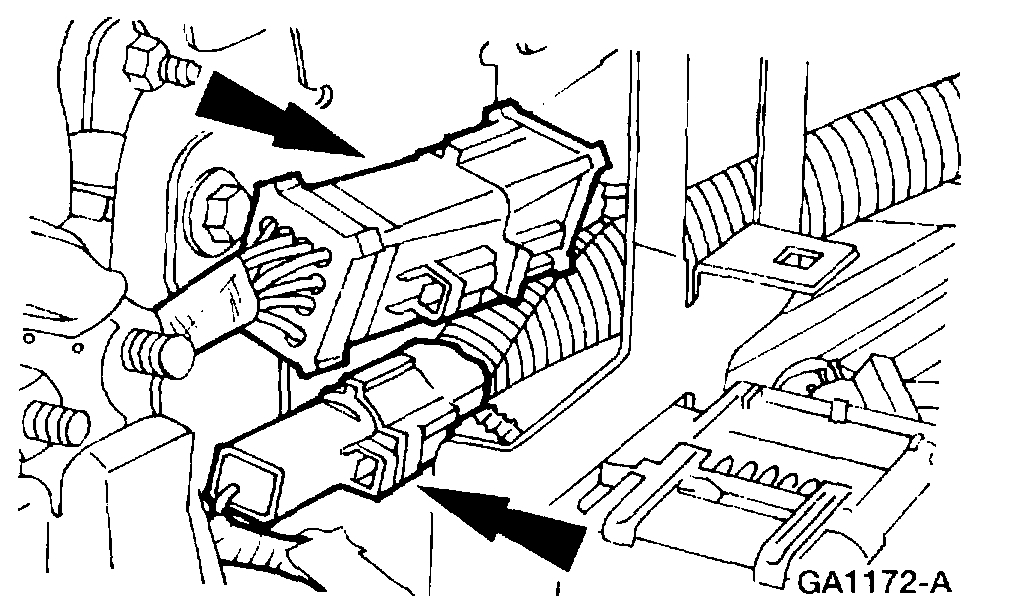

10. Disconnect the two 42-pin connectors and the single pin connector.
pic 7

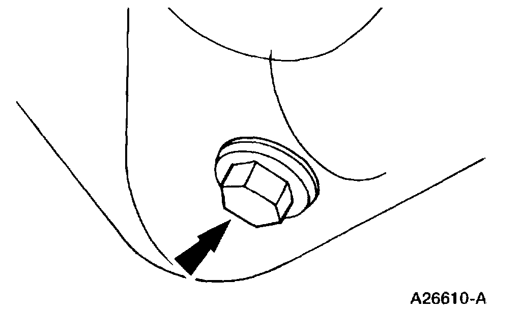

pic 10
15. Remove the drain plug and drain the engine oil.

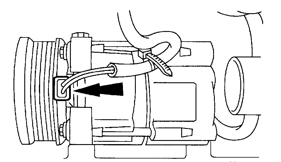

16. Disconnect the A/C compressor electrical connection.
pic 12

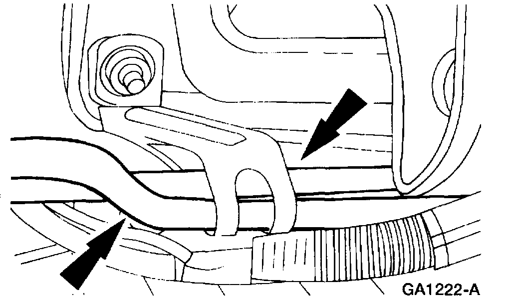

20. Remove the A/C line (muffler) bracket and position aside.

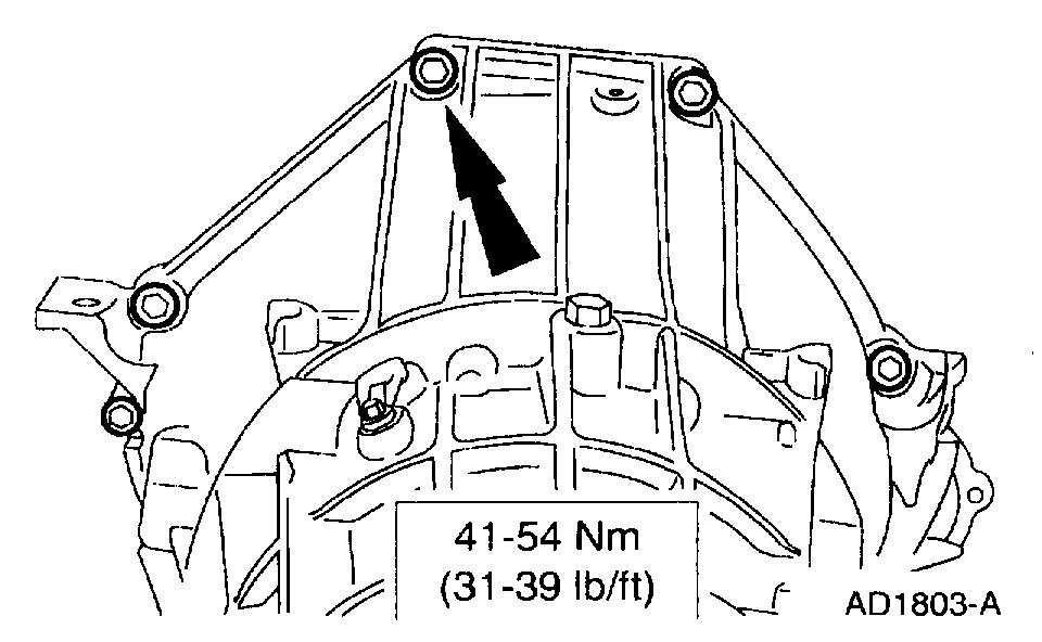

22. NOTE: The upper two transmission bell housing bolts will be removed later.
Remove the transmission inspection cover, torque converter bolts and transmission-to-engine block bolts.
pic 15

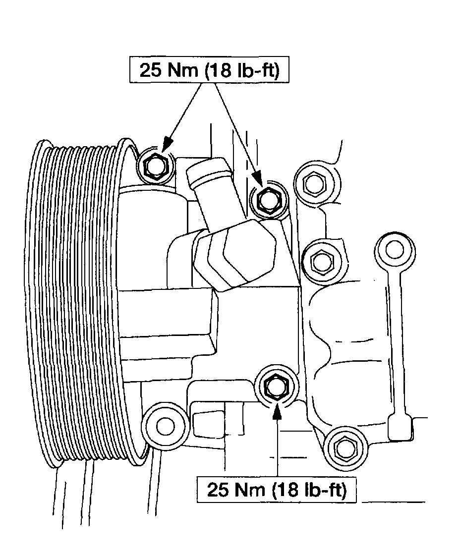

pic 16

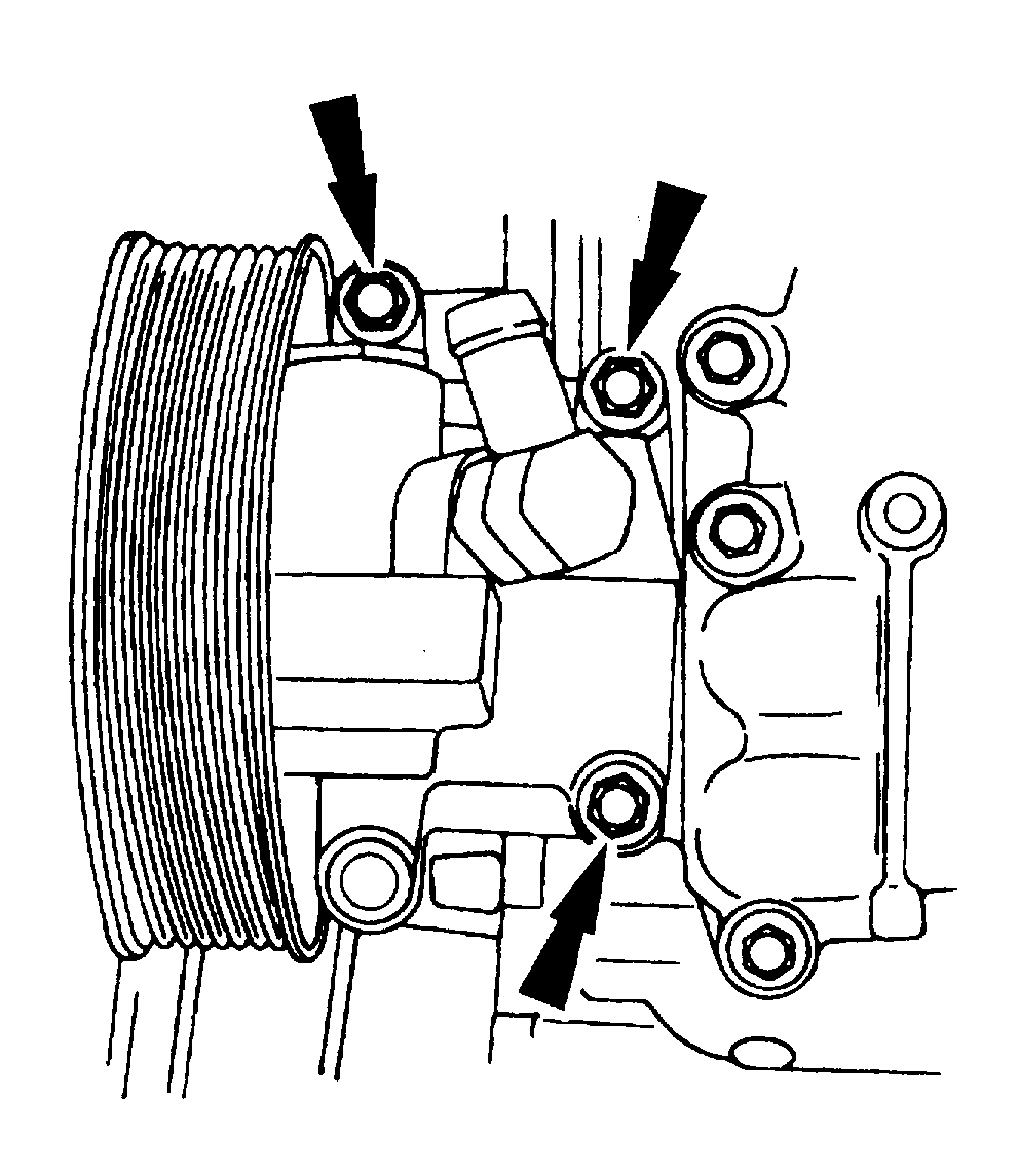

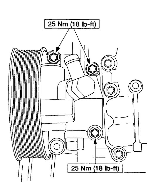

24. Remove the bolts and position the power steering pump aside.
pic 17

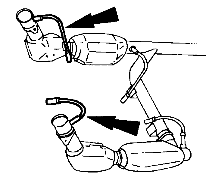

26. Disconnect the heated exhaust gas oxygen sensor electrical connectors.
pic 19
27. Remove the RH exhaust manifold to three-way catalytic converter nuts.
28. Remove the RH exhaust manifold studs.
pic 20
29. Remove the LH exhaust manifold to three-way catalytic converter nuts.
^ Position the Y-pipe aside.

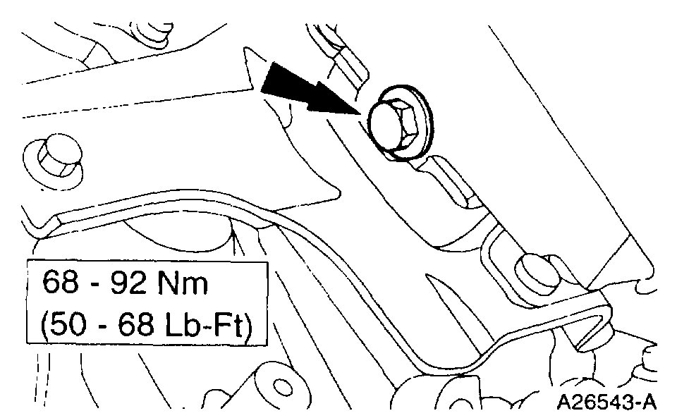

30. Remove the RH motor mount bolt.

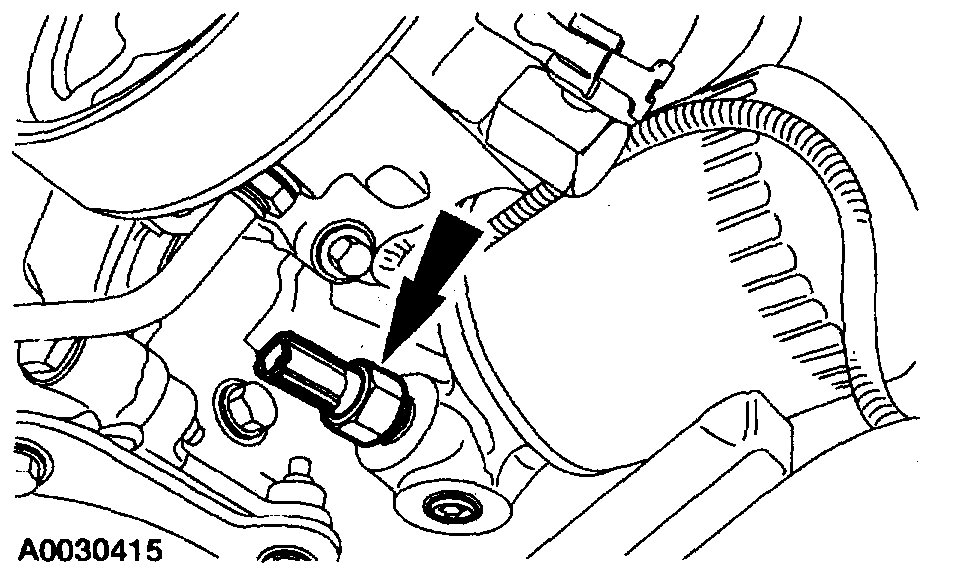

32. Remove the oil bypass filter.
pic 24
33. Remove the oil pressure sensor.
pic 25

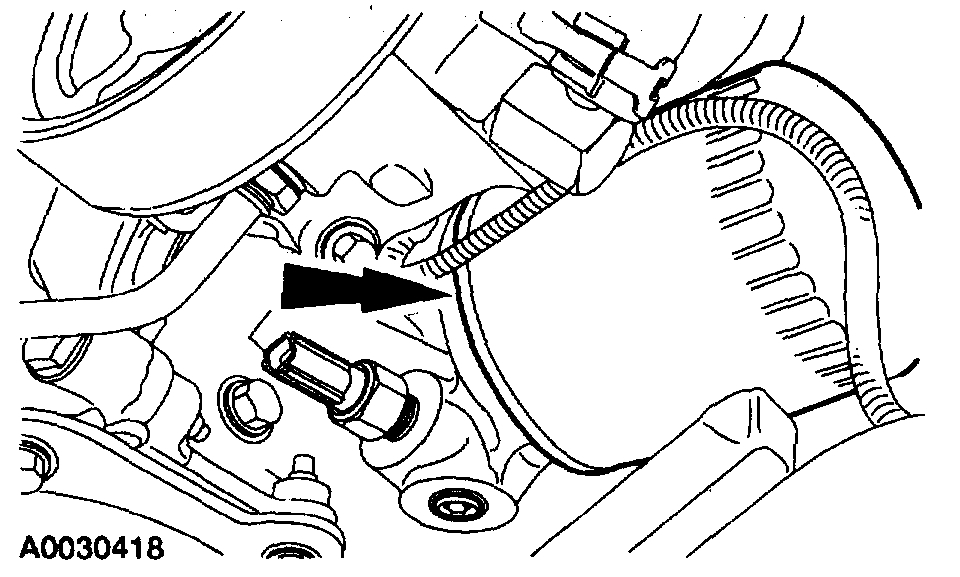

34. Slide back the hose clamp and disconnect the lower radiator hose from the oil filter adapter.

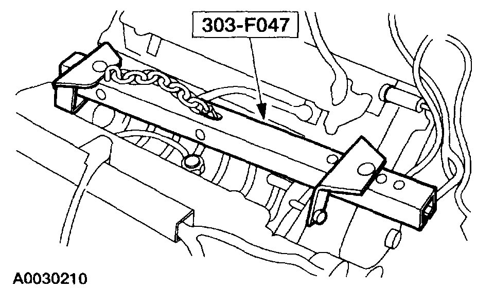

39. Install the special tool.
40. Remove the engine.

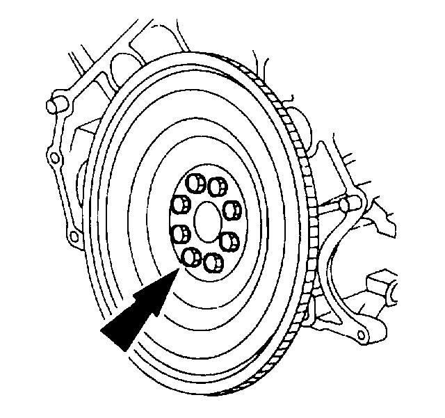

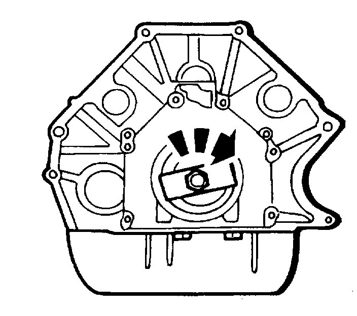

NOTE: If engine disassembly is to be carried out, remove the rear crankshaft oil seal slinger and the crankshaft rear oil seal.
Remove the flywheel.

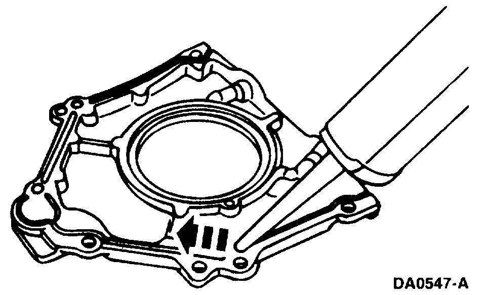

3. CAUTION: Do not use metal scrapers, wire brushes, power abrasive discs or other abrasive means to clean the aluminum retainer plate. These tools cause scratches and gouges, which make leak paths. Use a plastic scraping tool to remove all traces of old sealant.
If removed, clean and inspect the mating surface.
pic 31
4. NOTE: If not secured within four minutes, sealant must be removed and sealing area cleaned with metal surface cleaner. Allow to dry until there is no sign of wetness, or four minutes, whichever is longer. Failure to follow this procedure can cause future oil leakage.
If the retainer plate was removed, apply a 4 mm (0.16 inch) bead of silicone gasket and sealant around the rear oil seal retainer sealing surface.
pic 32
5. If removed, install the crankshaft rear oil seal retainer and bolts.
pic 33

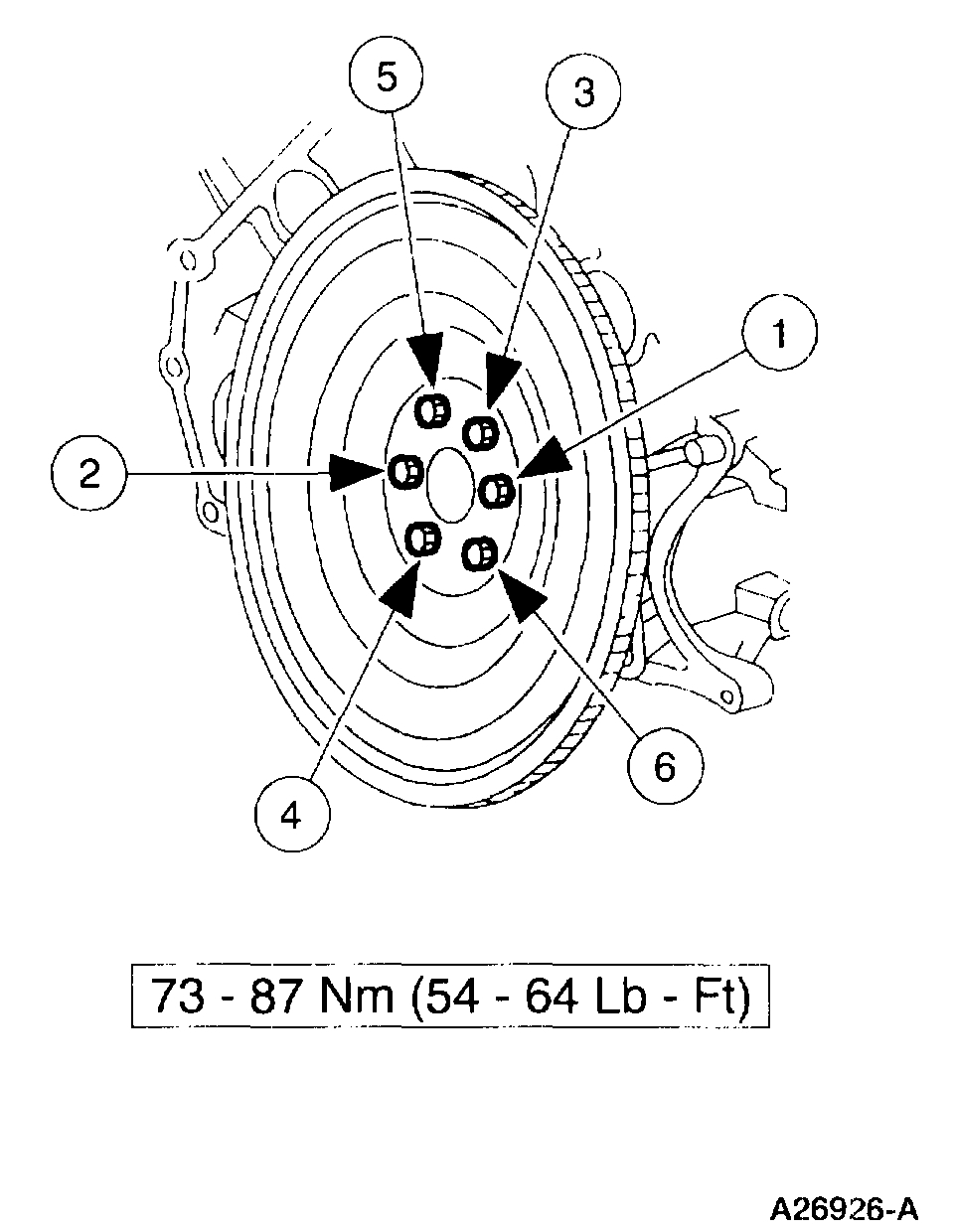

pic 34
Romeo engine (4.6L)

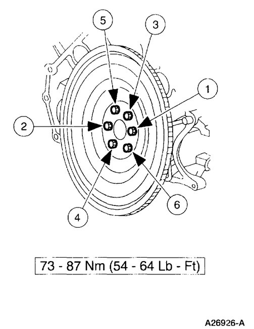

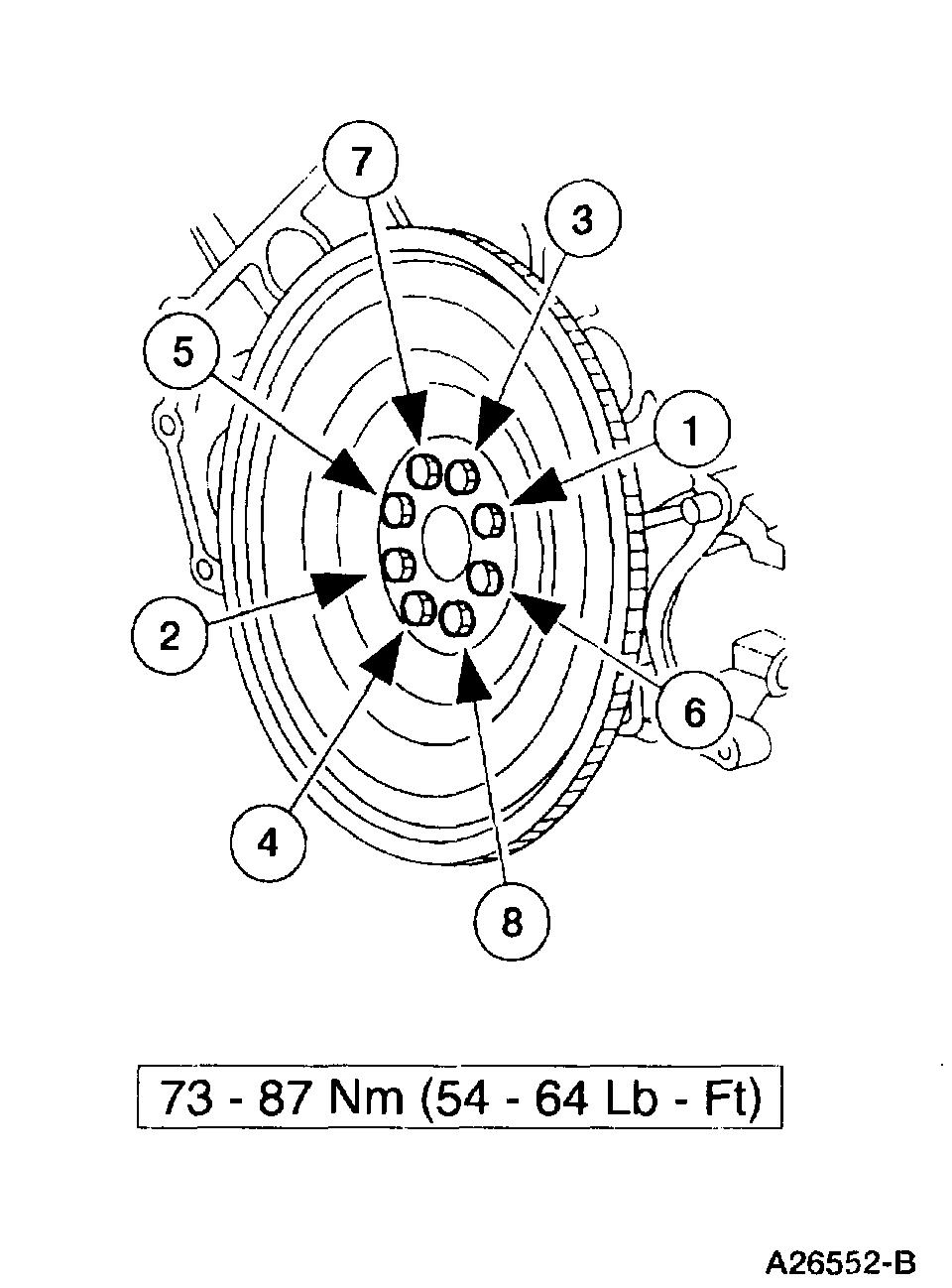

8. Install the flexplate and the bolts. Tighten the bolts in the sequence shown.

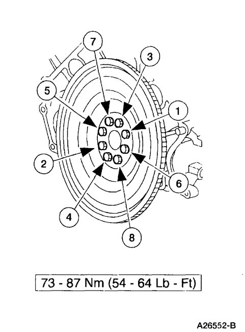

pic 35
Windsor engine (SAL)

12. Position and install and the LH engine mount bolt.

20. Install the oil bypass filter.
pic 42
21. Install the oil pressure sensor.
pic 43

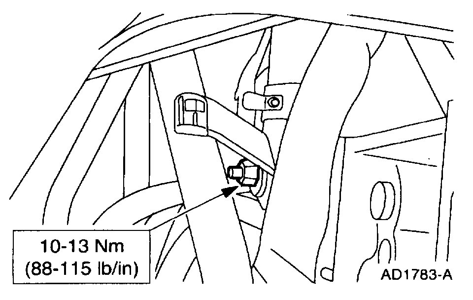

23. Install the transmission fluid cooler hose in the clip.
pic 45

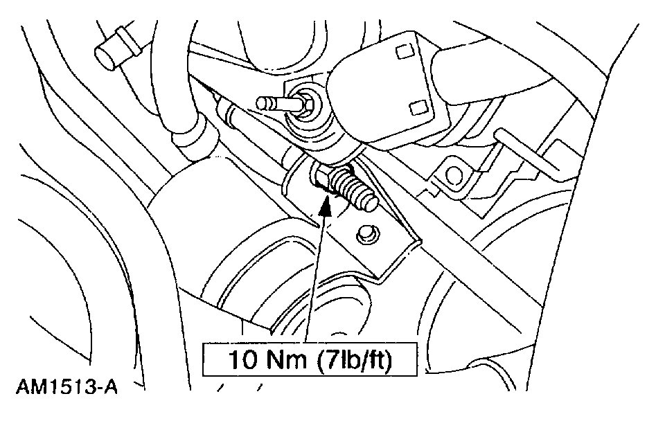

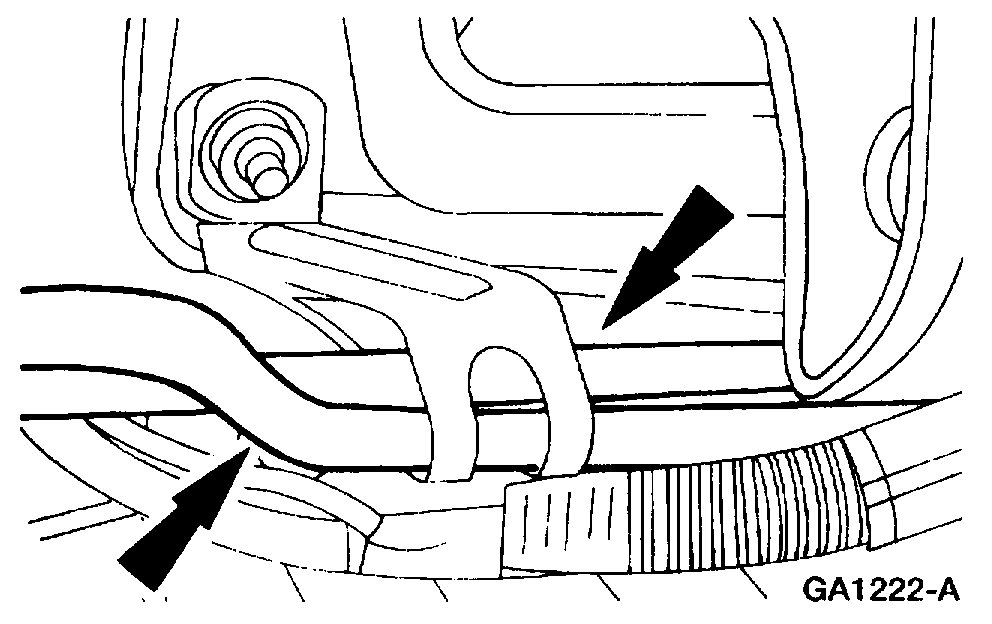

24. Install the A/C line (muffler) bracket.
pic 46
25. Connect the A/C compressor electrical connector.
pic 47

pic 52
37. Install the power steering reservoir.
^ Position the reservoir.
^ Install the two lower bolts.
^ Install the upper bolt.

I hope this helps. Let me know if you have any questions.
