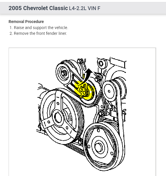

Do me a favor, since you indicated the belt skips, I'm questioning if it is a belt-driven accessory that is making the noise.
If you look at pic 1 below, I highlighted the belt tensioner. Turn that in a counter clockwise direction to loosen and remove the belt.
Once it is off, start the engine to see if the noise is gone. Only run the engine long enough to see if the sound is gone. 10 to 20 seconds.

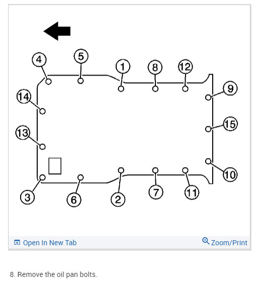

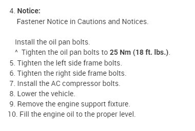

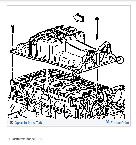

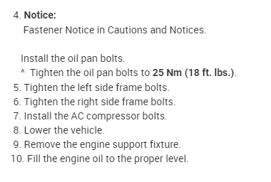

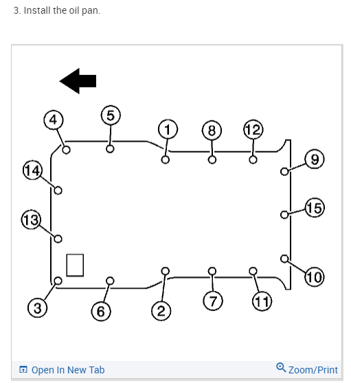

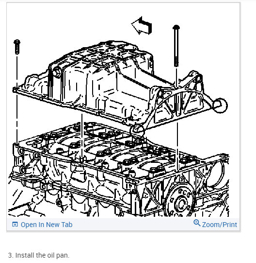

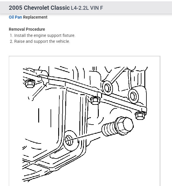

As far as the oil pan, nothing is ever easy. You need an engine support to prevent engine movement when you loosen the left and right frame bolts and lower them to have room to remove the pan.

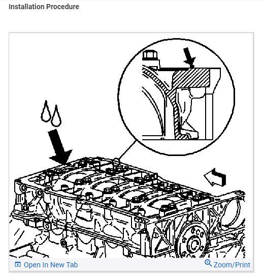

I attached the directions below. Take a look through them and let me know if you have questions.
See pics below.
Apr 2, 2023 at 7:07 PM
