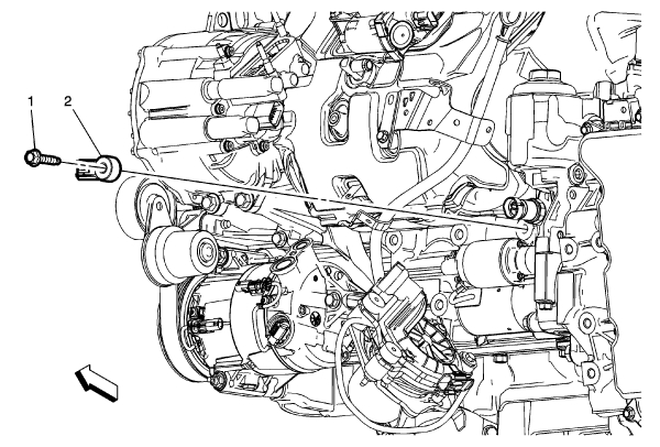

location for the knock sensors on the car listed above.

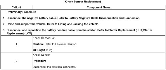

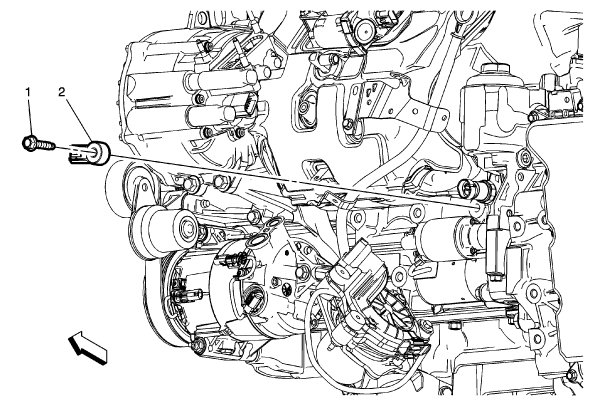

This is what ALLData has on the 2.4L Hybrid Malibu knock sensor. The non-hybrid options are 2.0 and 2.5, so let me know if this is the right one or not.

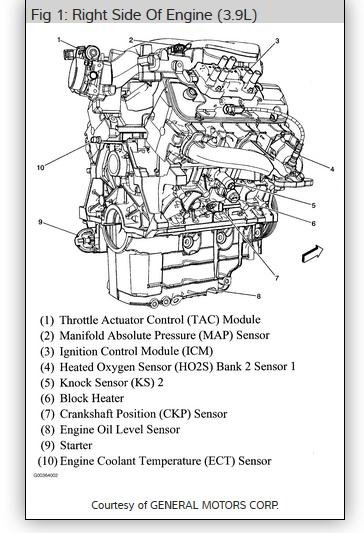

knock sensors locations. there are two. thanks

See picture. item 5 should be the same other side of engine. Check out the diagrams (Below). Please let us know if you need anything else to get the problem fixed.
