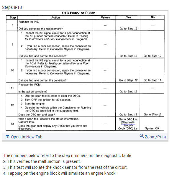

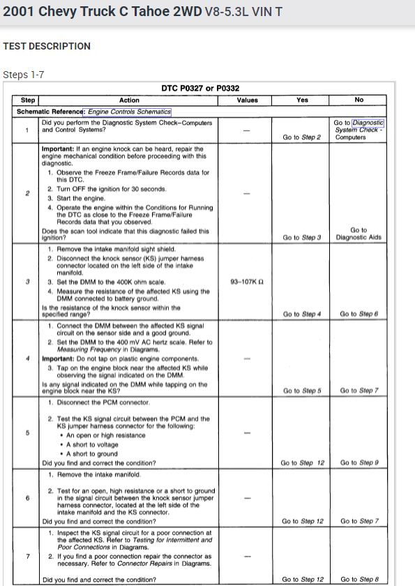

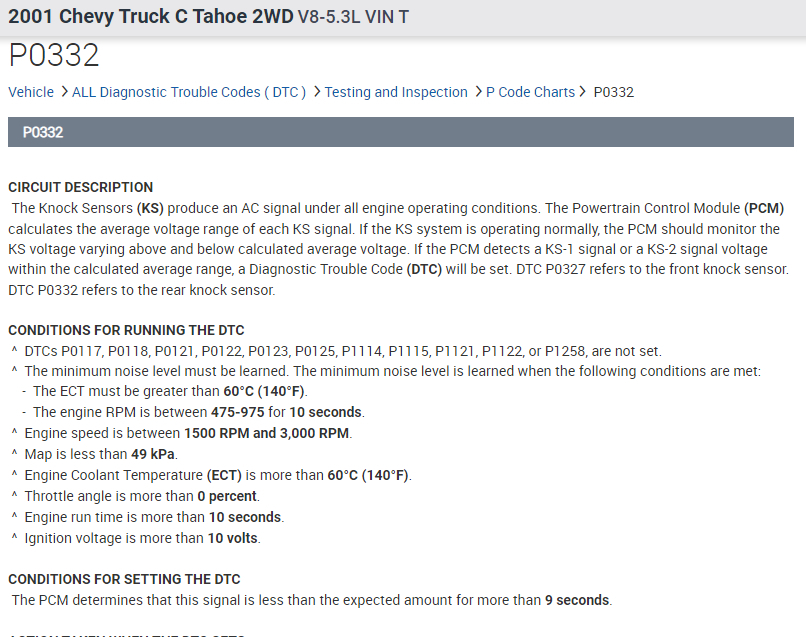

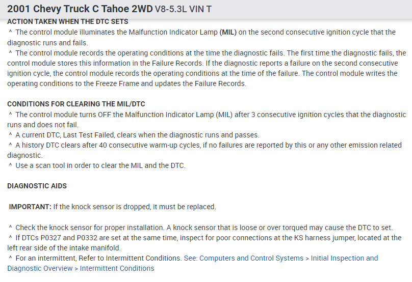

I have attached the diagnostics for the code P0332 (see below).
Go through that diagnostics and let me know what you find.
