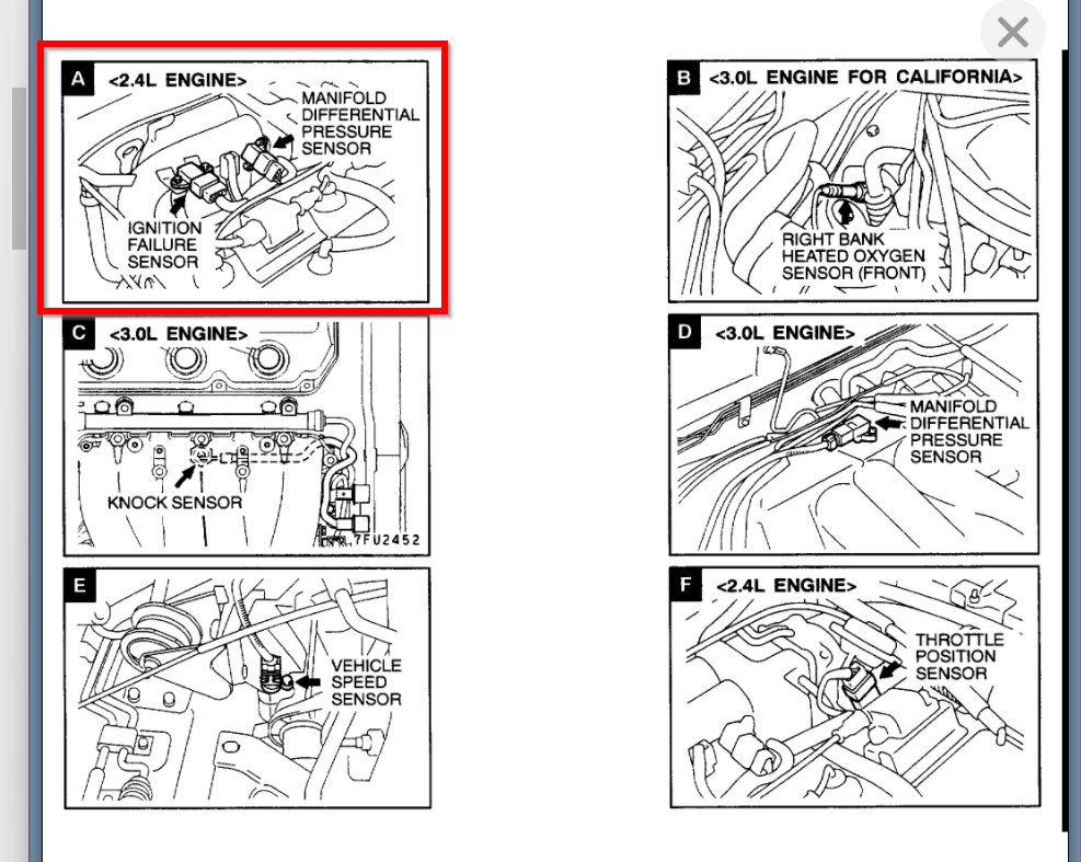

Did not sensor wire pigtail connector. I don't know what connects to it. Mine is missing and I need to know what connects to the pigtail to the knock sensor and where does it come from so I will know where to look.
Dec 20, 2021 at 5:22 AM

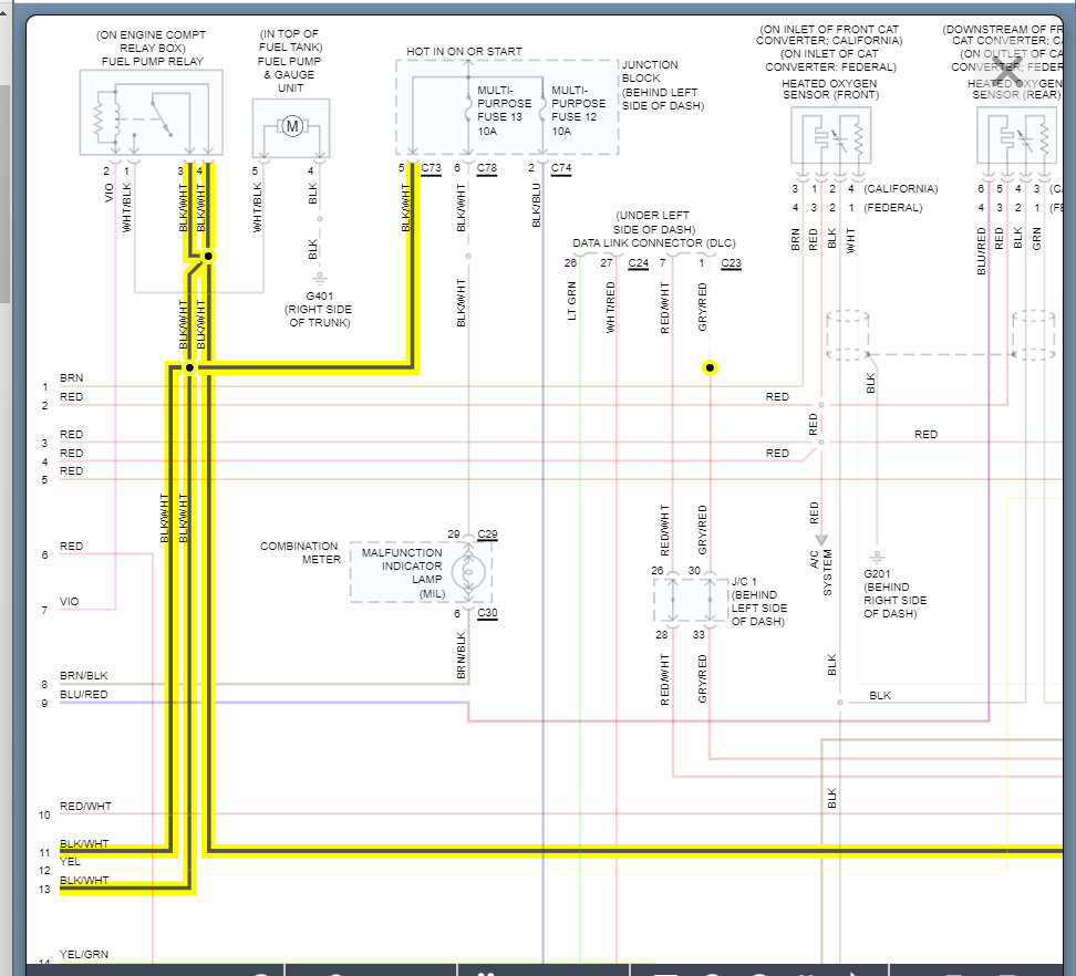

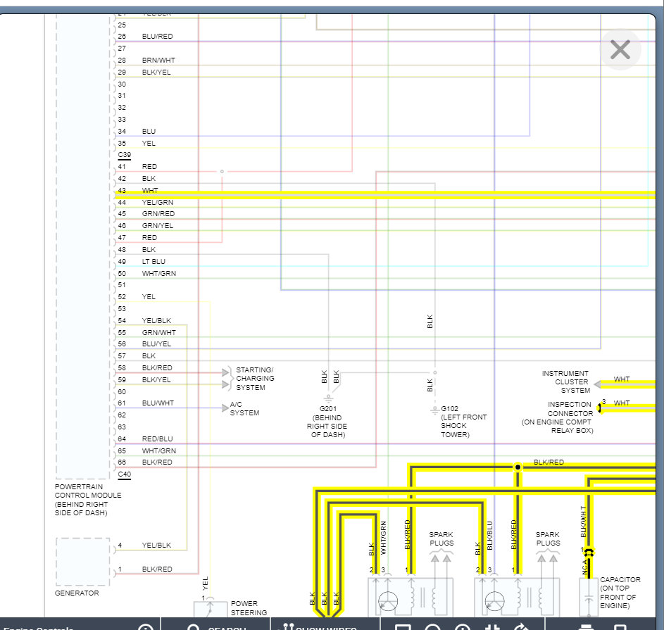

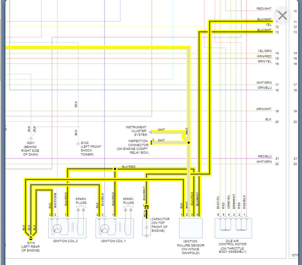

I am attaching the info from the manual that we need to use to help figure this out.
Here is a guide that we may find helpful:
https://www.2carpros.com/articles/how-a-knock-sensor-works
If you are not able to find the harness, then you may just want to run new wires, but this is not called a knock sensor. It is called an ignition failure sensor which is fancy but the same thing.
