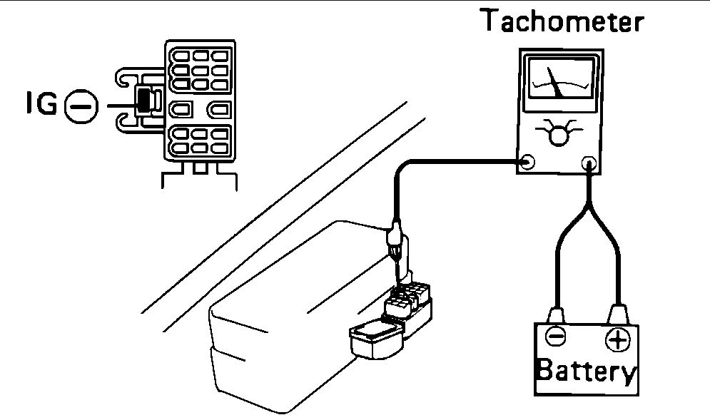

Tachometer Hookup
imageZoom/Print
2. Attach a timing light with advance indicator and a tachometer.

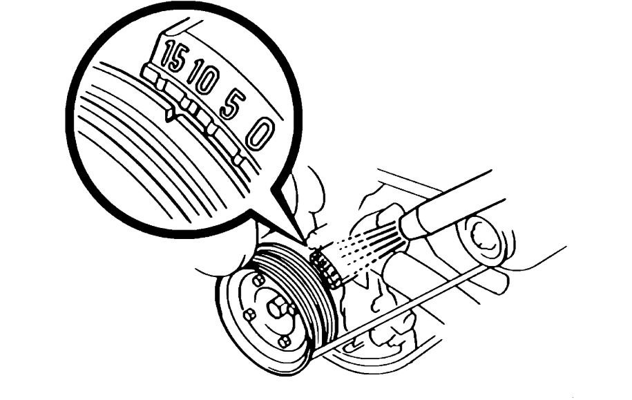

Fig. 223 Ignition Timing (10)
imageZoom/Print
3. While operating the engine at 2,000 rpm, check the ignition spark advance and calibrate the timing mark to 0° TDC.
4. Using a wrench or small hammer, tap the exhaust manifold and observe the timing marks.
5. The ignition timing mark should move in the retard direction, depending on the intensity and speed of the tapping.

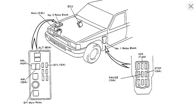

my truck kept popping EFI fuses so I check o2 sensor. When new engine was put in the mechanic never supported the wire going to the o2 sensor. Needless to say the exhaust melted the wire coating on all four wires to the o2. I have repaired the wires and so far no fuses have popped but the check engine light is still on. I unhooked the battery for 10 minutes and check engine light still on. The only thing I can thing that might be wrong in the carbon scoring in the wires from being in the exhaust. Maybe I didn't cut back far enough on the wire before reconnecting. Could this be it? A poor connection of the o2 wires?
Thank you,
Rich
Nov 15, 2020 at 9:21 AM (Merged)

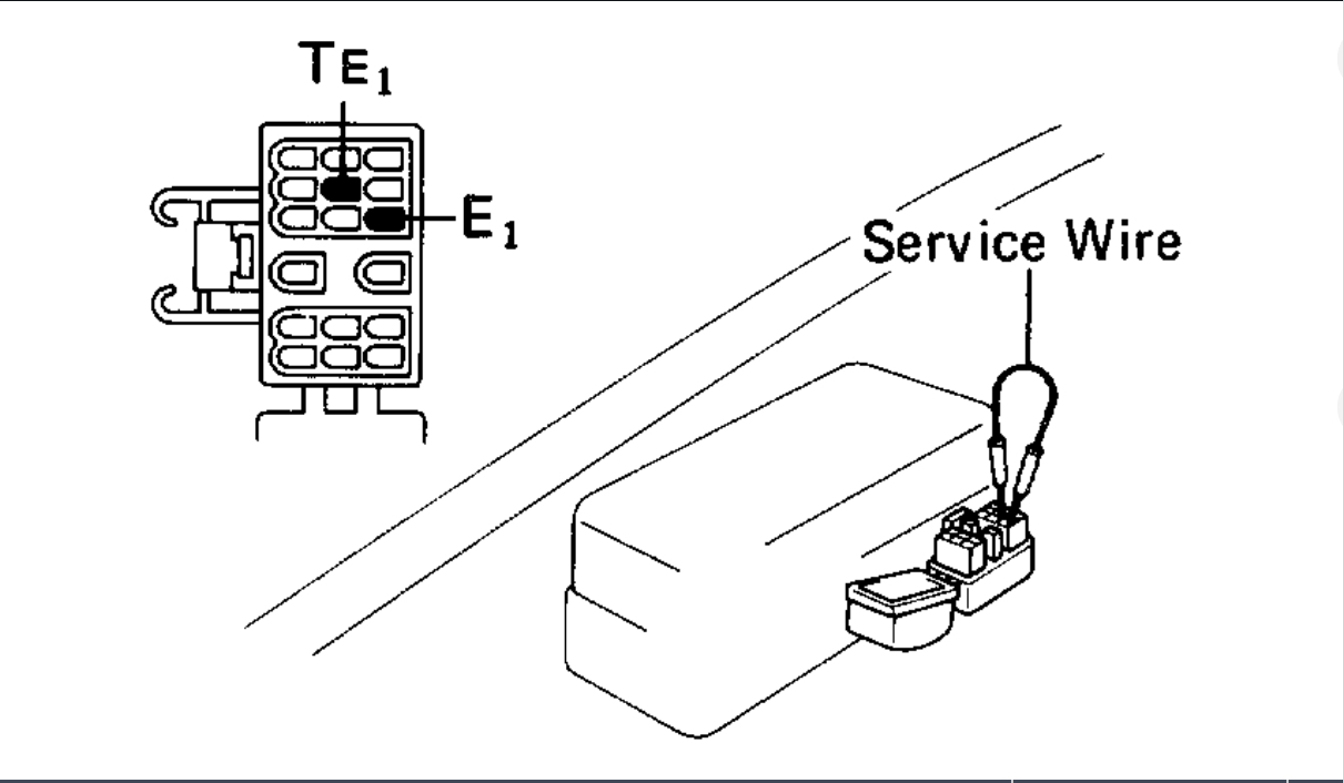

DOCFIXIT
  • 18,828 POSTS

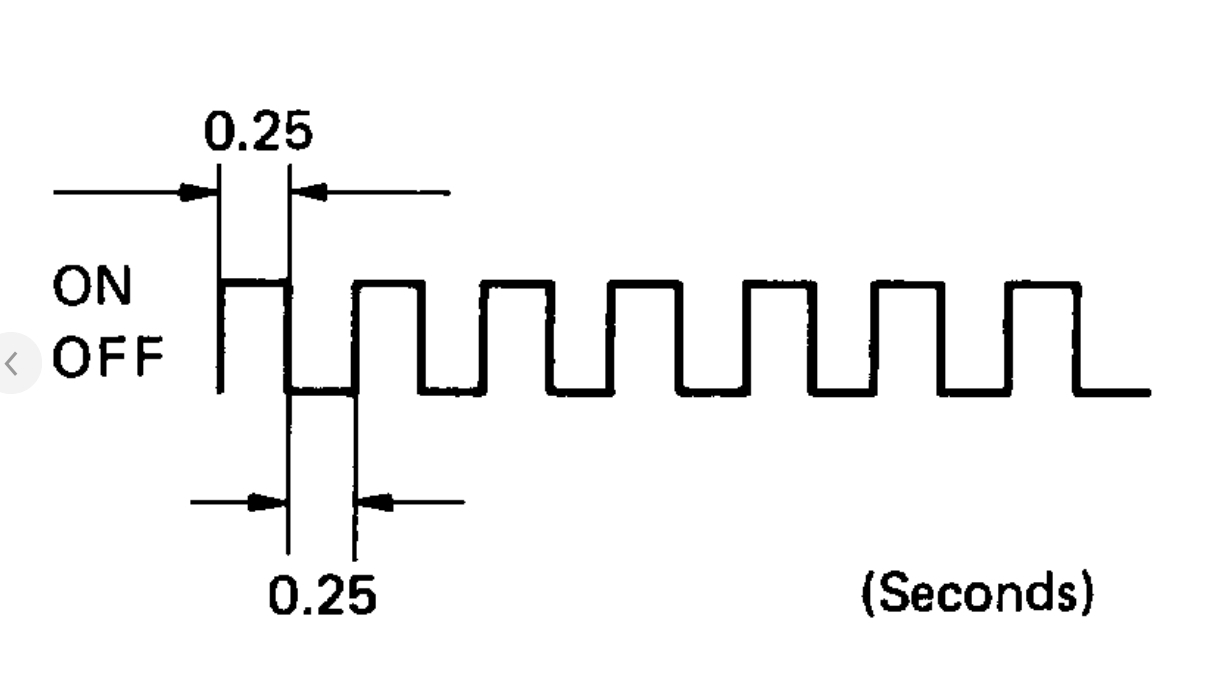

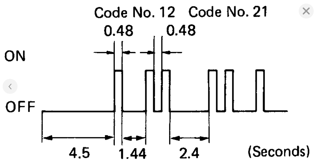

HI Find test connector near fuse box key on jumper wier from TE1 to E1. Check engine light will flash see diagram on how to read
https://www.2carpros.com/forum/automotive_pictures/198357_Graphic_522.jpg
https://www.2carpros.com/forum/automotive_pictures/198357_Grafic_3_133.jpg
Then post codes will advise. Wires to O2 neeed to soildered any increased resistence can cause trouble. Thanks for donate

**_*___*****_* I think it is 21 then 51.
Does this sound right?

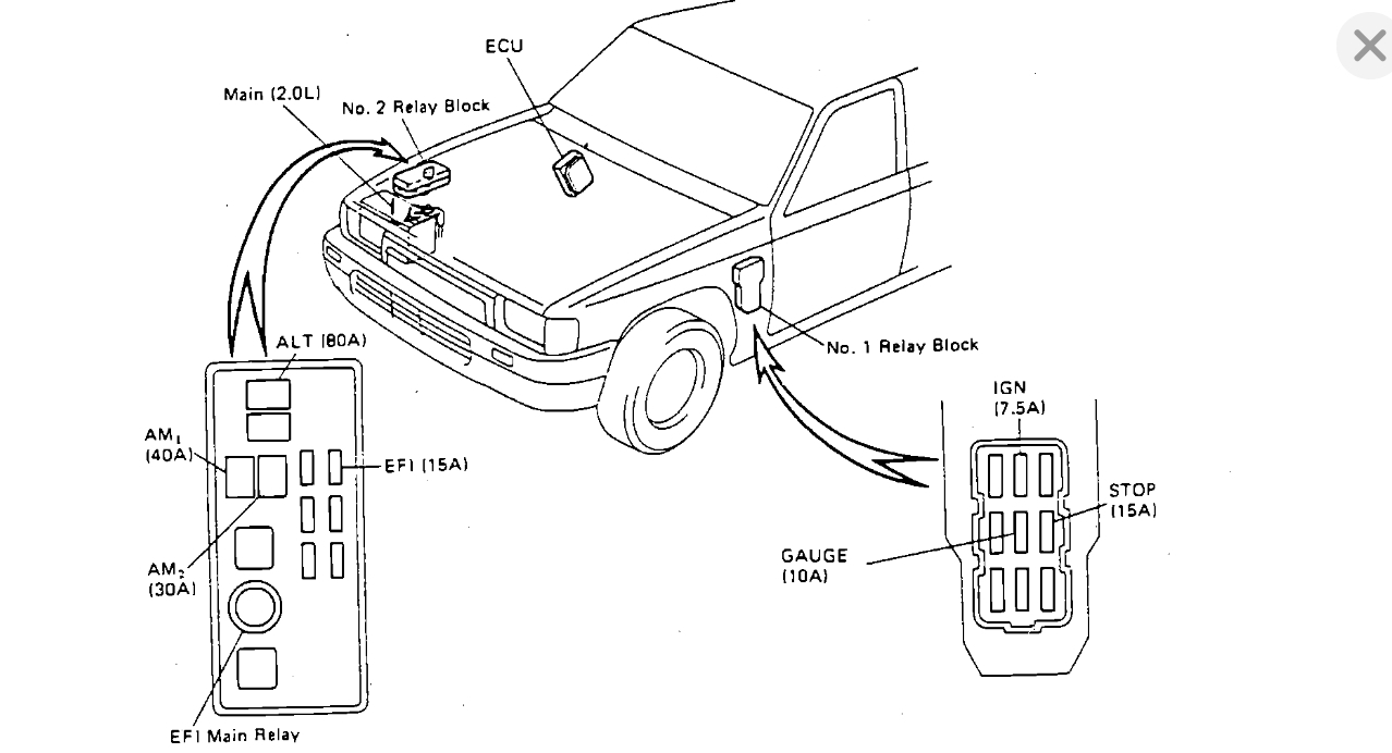

The check engine may have been on before and the light was burnt out. When you replaced the light bulbs it showed up. If the vehicle has a hard code the light will stay on until fault is corrected. The emissions codes like the evaporated system with have a error and the vehicle will function normally. Regardless you need to check the diagnostic trouble codes and here is how you do it. Turn the ignition switch to on. Do not start the engine. Connect terminals TE1 and E1 of the check connector located near the No.2 relay block schematic is showed below. Read the diagnostic code as indicated by the number of flashes of the "Check Engine" warning light. Normal system operation the light will blink 2 times per second. . Malfunction Code Indication the light will blink a number of times equal to the malfunction code indication with a 2.4 second interval between each code indication.After all codes have been output, there will be a 4.5 second pause.
The code display will be repeated as long as both check engine connector terminals are connected. Hint: In event of a number of trouble codes, indication will begin from the small value and continue to the larger in order. After the diagnosis check, remove the service wire. Please check out the guide and schematics below. Pull all troubles codes and write them down in case they get erase by accident. Start diagnostics in the order each code is pulled. Repair the malfunction and erase and erase the codes.
Here is how the erase codes without a scan tool safely: Cancellation can also be done by removing the battery negative (-) terminal for 10 minutes, but in this case, other memory systems will also be cancelled out. If the diagnosis code is not cancelled out, it will be retained by the ECU and appear along with a new code in event of future trouble.If it is necessary to work on engine components requiring removal of the battery terminal, a check must first be made to see if a diagnostic code has been recorded. After cancellation, perform a road test to confirm that a "normal" code is now read on the check engine warning light. If the same diagnosis code appears, It indicates that the trouble area has not been repaired thoroughly. If you need more information how to diagnose the codes you pull. Please make another post and we will get it for you. Let us know if this information was helpful.
