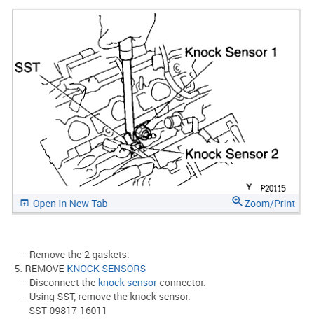

Are the knock sensors on the inside of the intake manifold or are they on the bottom of the motor by the oil filter?
Jun 22, 2023 at 11:37 AM
CERTIFIED EXPERT
110,175 POSTS

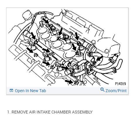

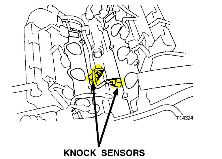

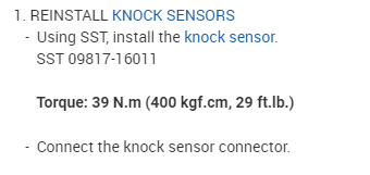

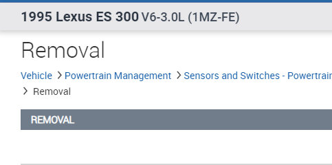

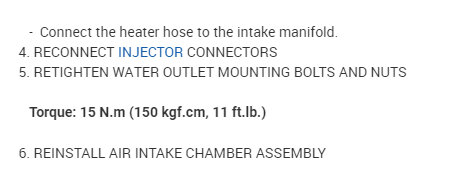

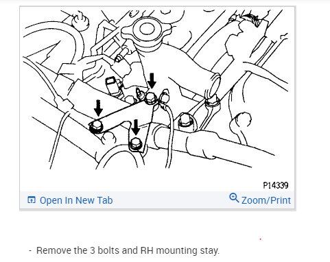

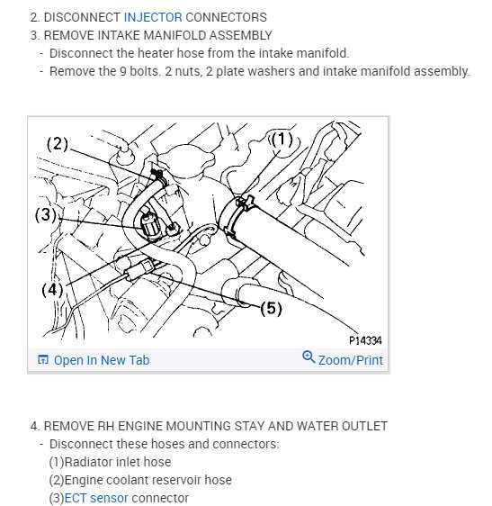

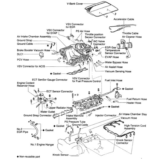

The knock sensors, two of them, are both located under the intake manifold. See pic 1 below.

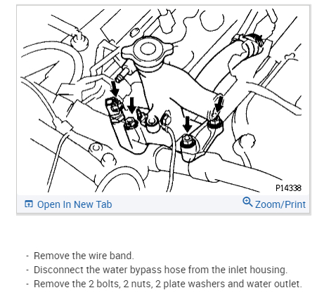

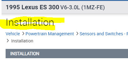

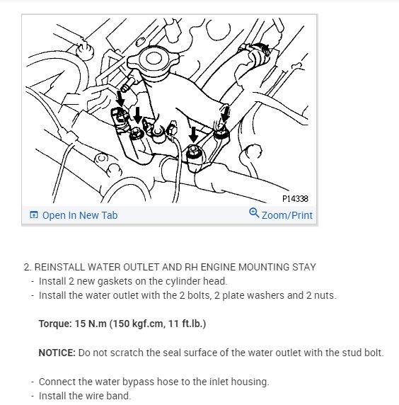

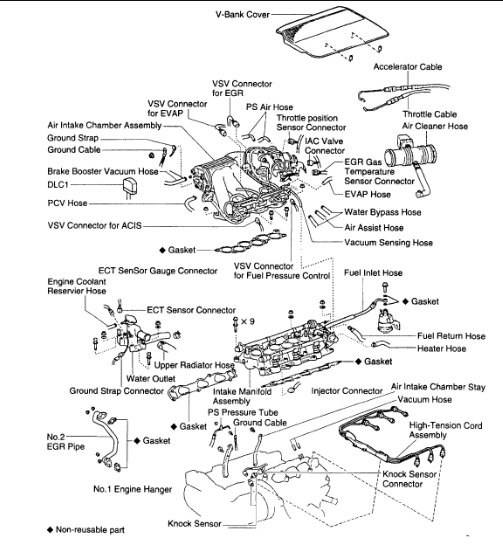

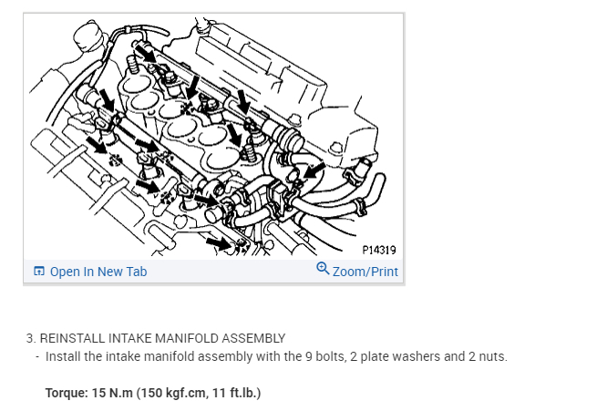

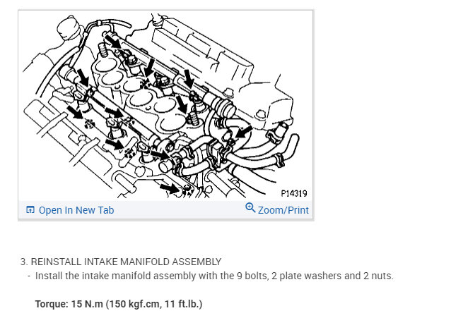

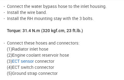

The remaining pictures are the directions for the removal and replacement of the sensors.
Let me know if this helps.
joe
See pics below.
