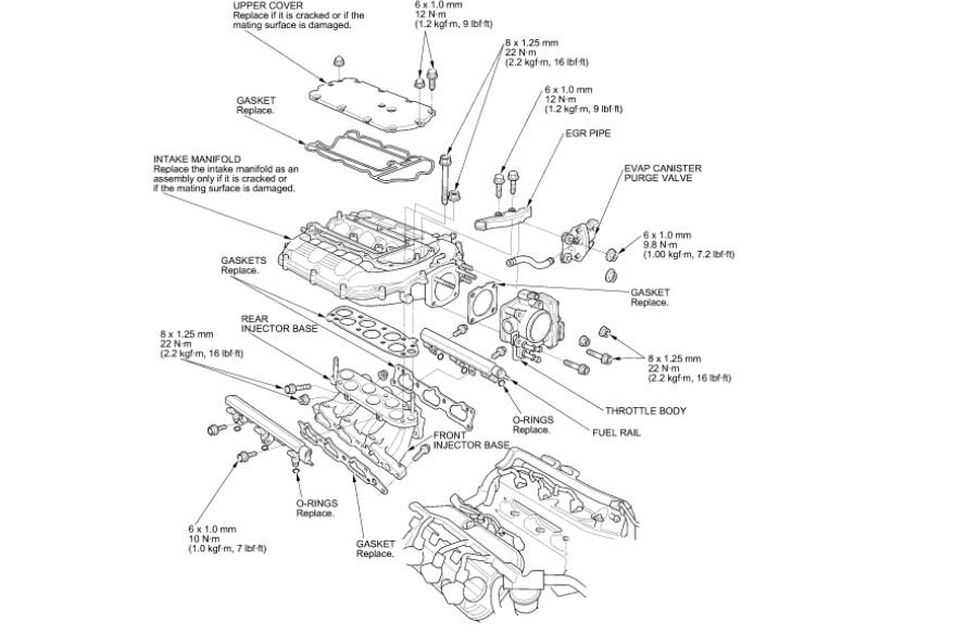

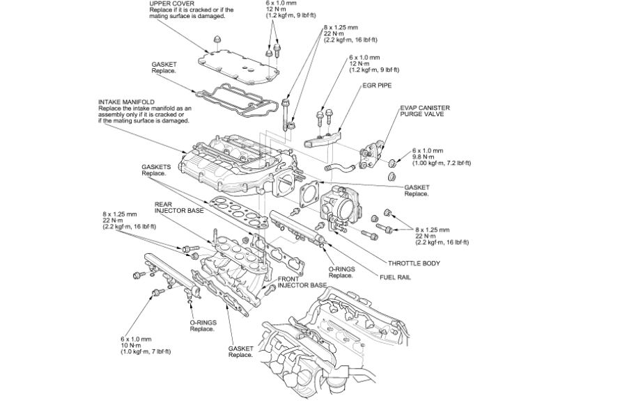

1. Remove the engine cover.
2. Disconnect the breather pipe (A), then remove the intake air duct (B).
3. Disconnect the throttle actuator connector (A), the EVAP canister purge valve connector (B), the water bypass hoses (C), the MAP sensor connector (D), and the EVAP canister purge hose (E), then plug the water bypass hoses.
4. Remove the harness clamp (F).
5. Disconnect the PCV hose (A), the brake booster vacuum hose (B), and the IMT actuator connector (C).
6. Remove the upper cover mounting bolts and nuts sequentially in three steps, then remove the upper cover (A).
7. Remove the intake manifold mounting bolts and nuts sequentially in three steps.
8. Remove the intake manifold.
