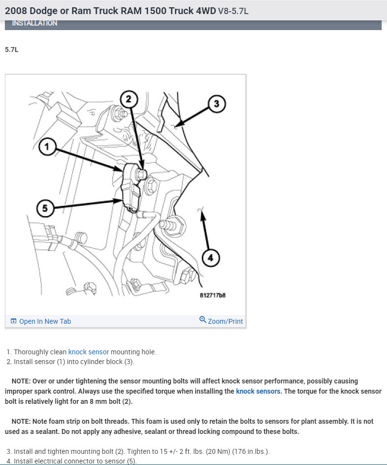

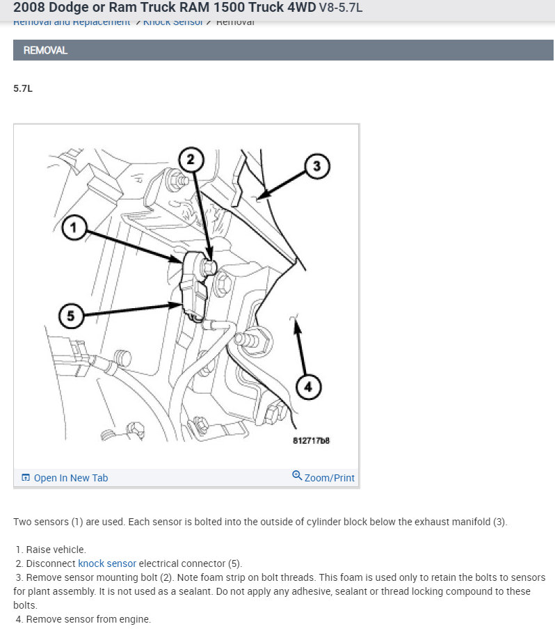

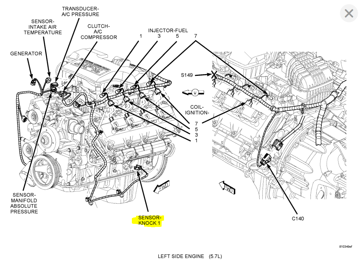

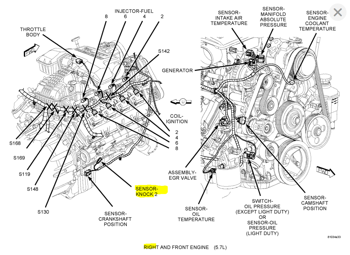

Do you have a diagram of where the knock sensors are located?
Sep 4, 2022 at 9:32 AM
SQM
  • 6,383 POSTS
See attached diagrams for knock sensor locations as well as replacement procedure.
Let me know if you are able to find them or if you have any questions.
