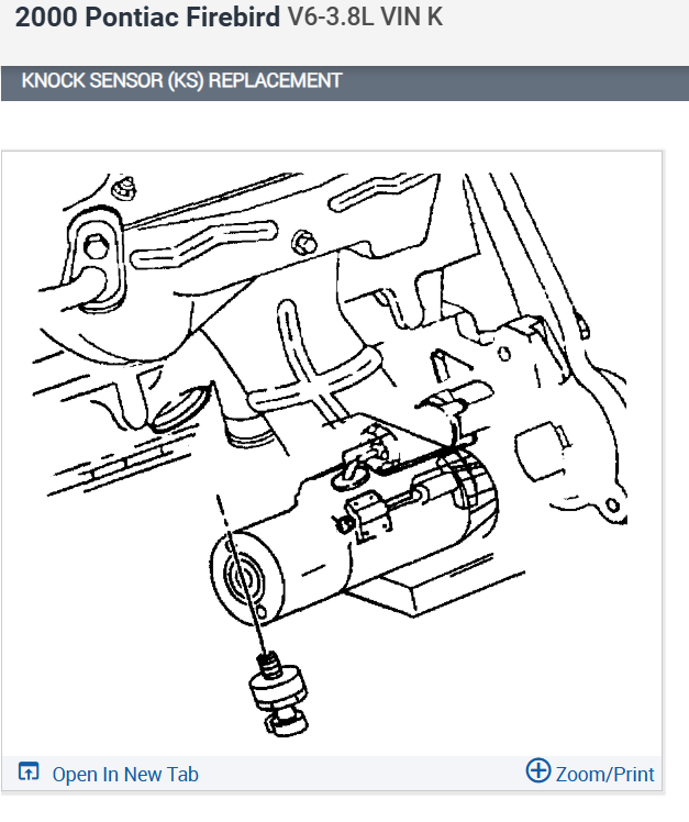

This engine has two knock sensors each on the lower part of the engine block on either side, right and left. Here is a diagram that shows the location of one, so the other is in the same place but the opposite side. Check out the images (below). Let us know if you need anything else.
