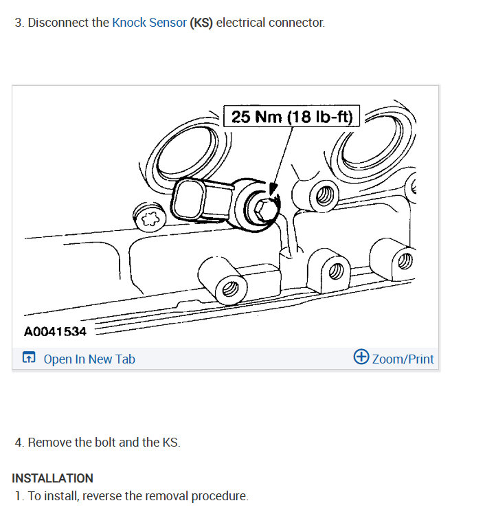

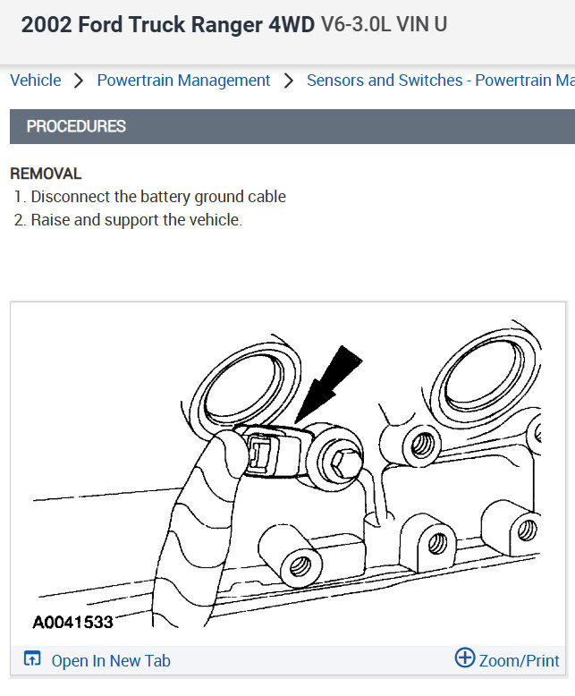

I'm looking for a Diagram of the location of the knock sensor on a 3.0L.
Feb 7, 2025 at 6:15 PM
The knock sensor is on the right side of the engine down low. Here is the location and how to change it out with torque specs which is important not to damage the new sensor. Check out the images (below). Let us know if you need anything else.
