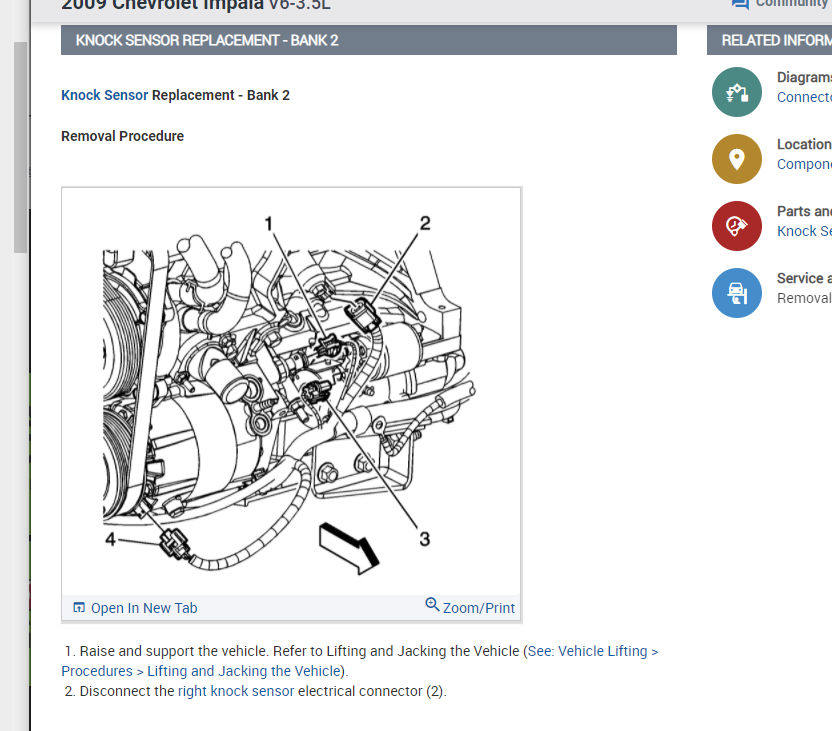

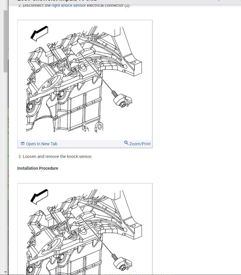

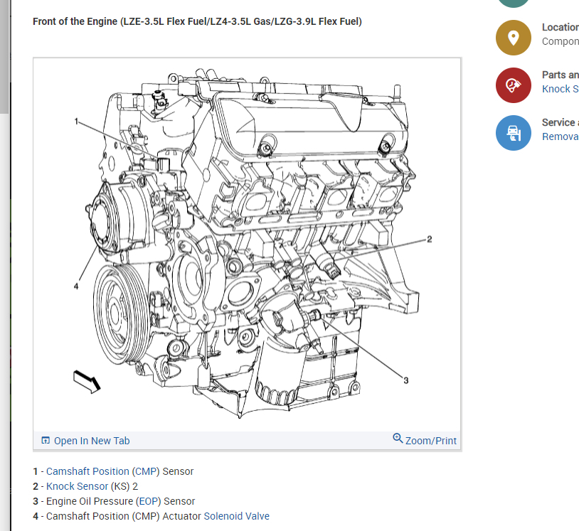

This is going to be on the side of the engine just above the oil filter.
It is not the easiest to find but once you do it is not that bad to get it replaced.

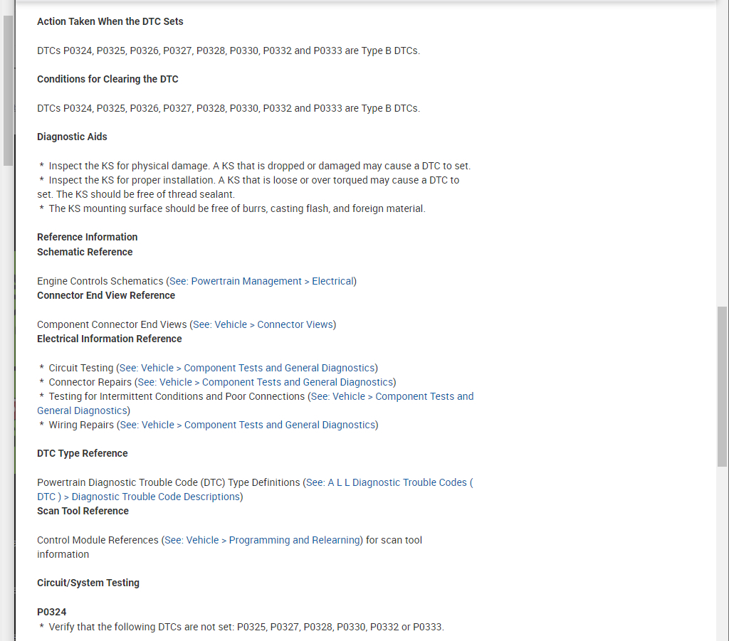

Here is a guide as well for others that may need more info on this sensor:
https://www.2carpros.com/articles/how-a-knock-sensor-works

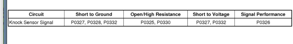

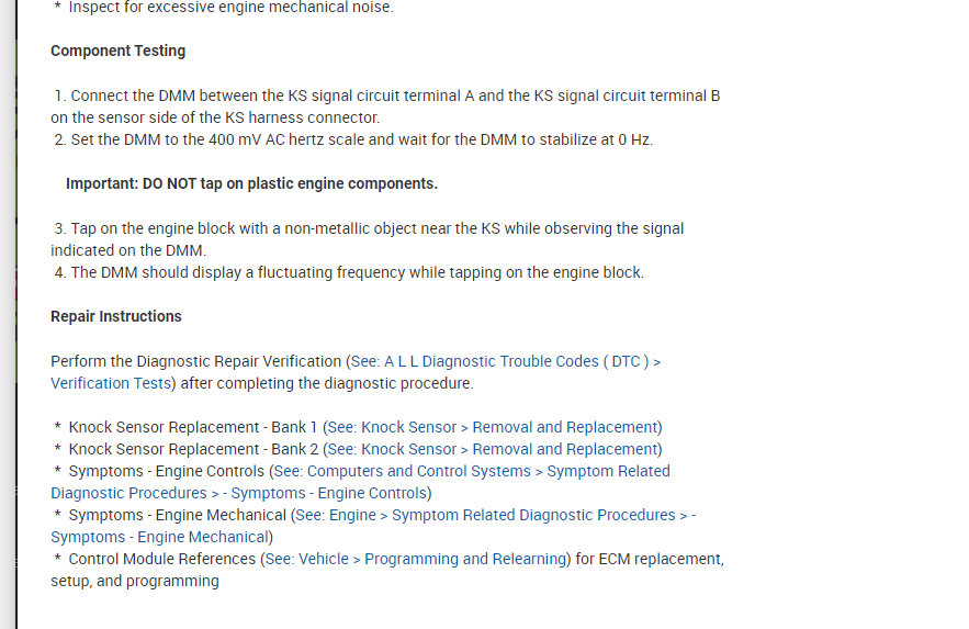

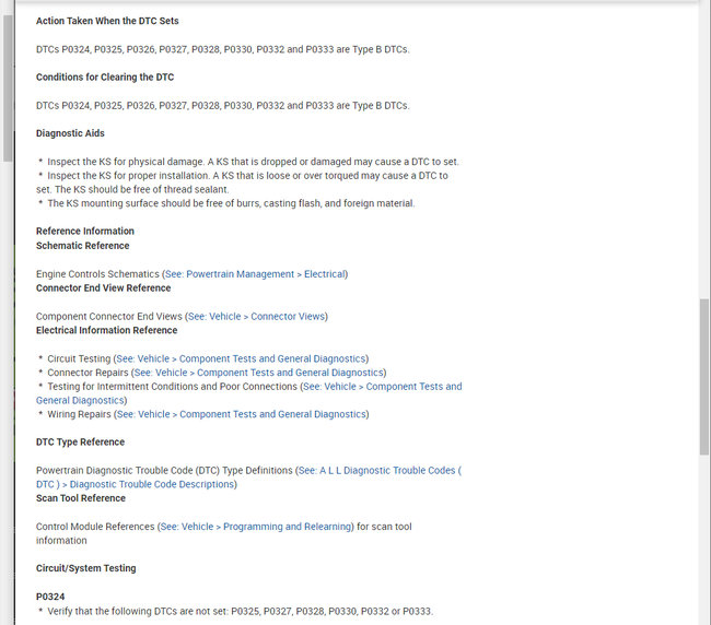

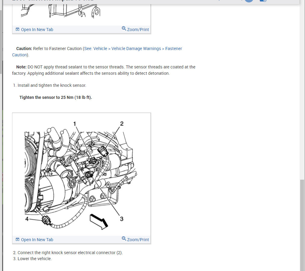

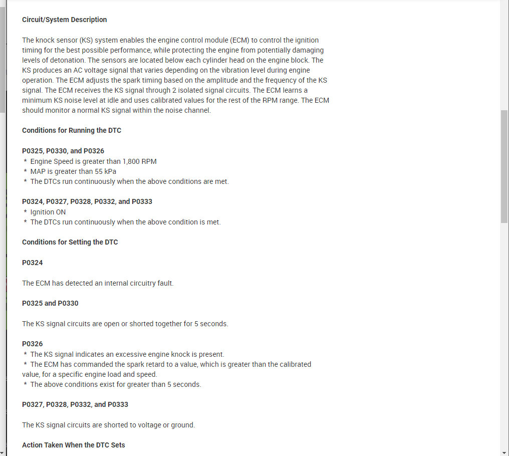

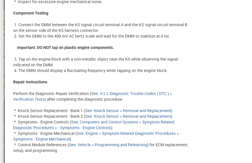

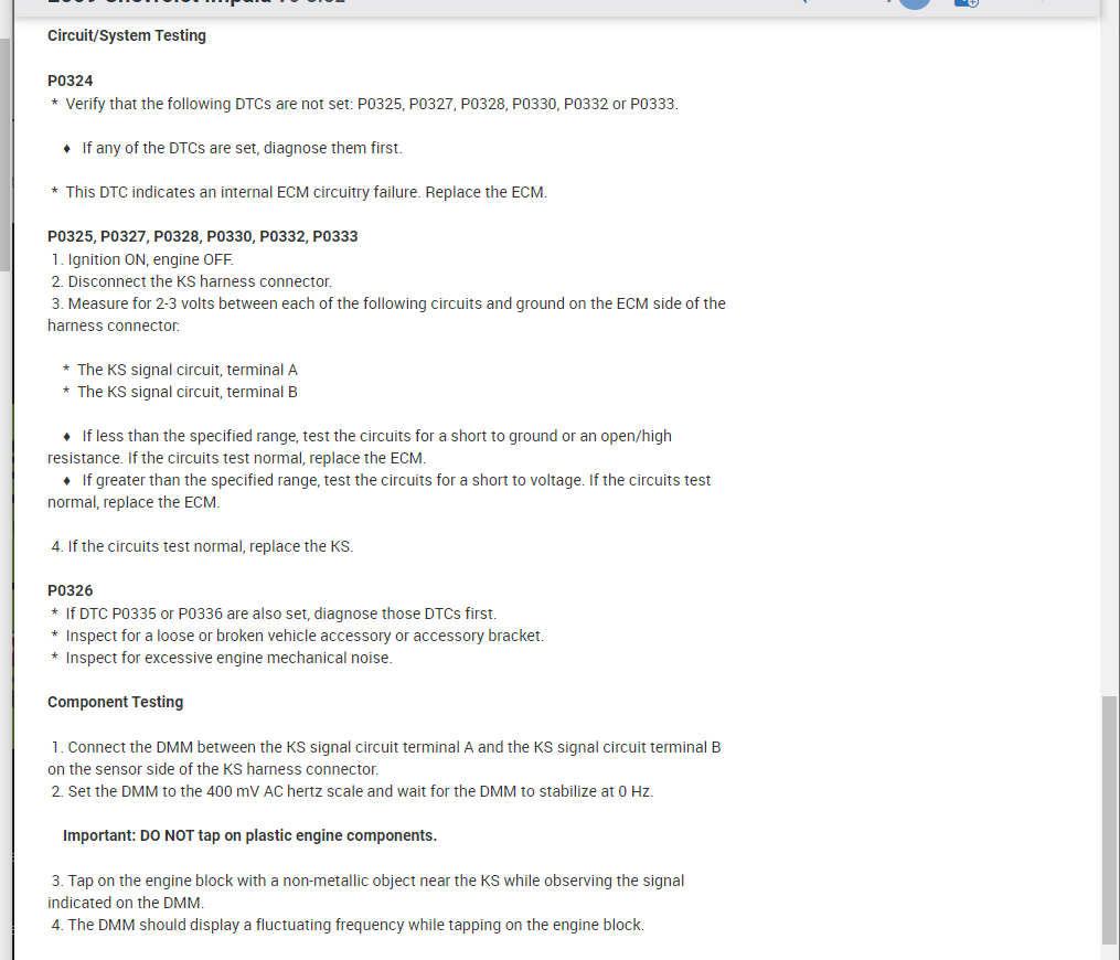

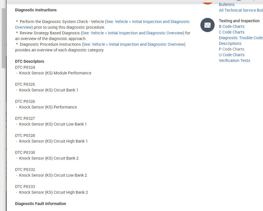

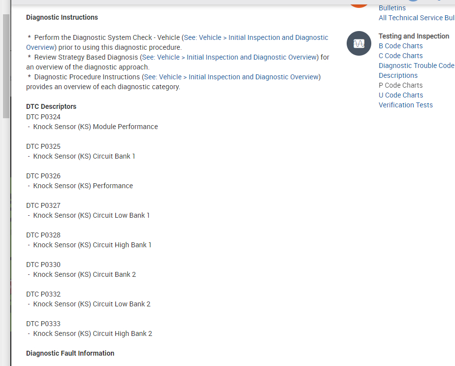

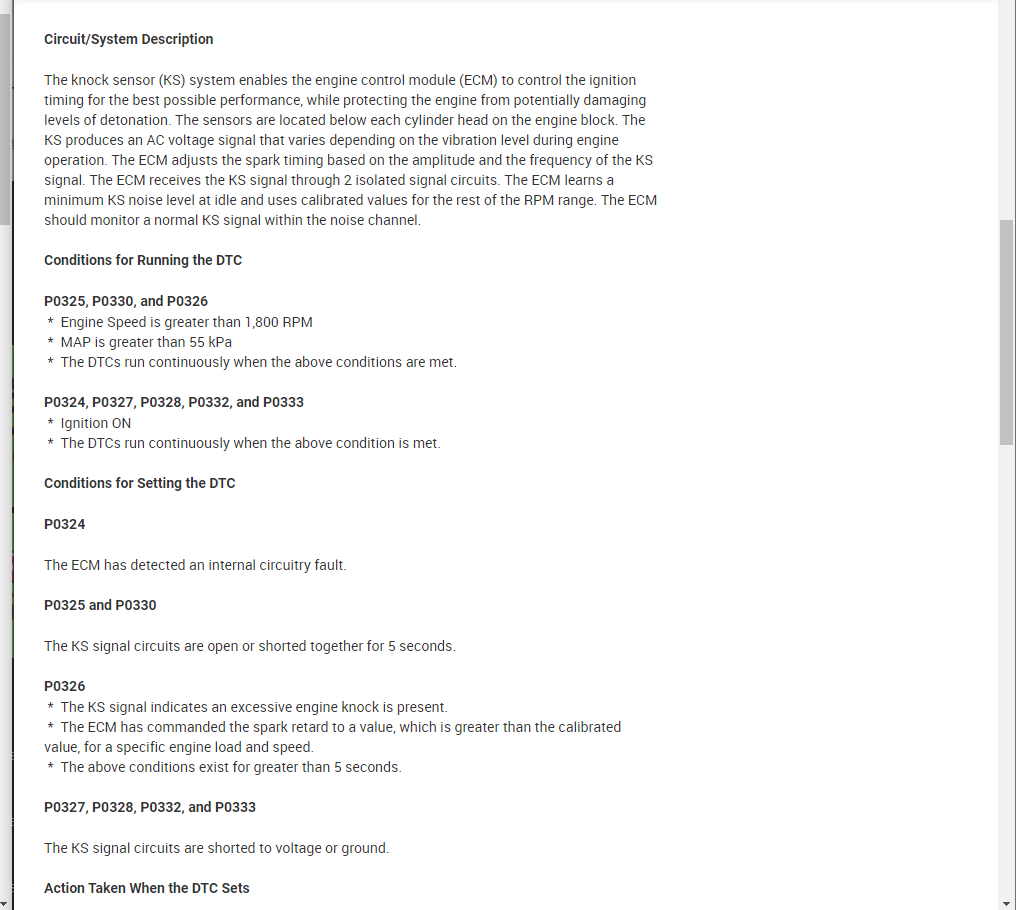

I am not only attaching the location but the process on how to replace this from the manual plus the detail about the code which includes the testing.
Please run through all this and let us know if you have other questions. Thanks
