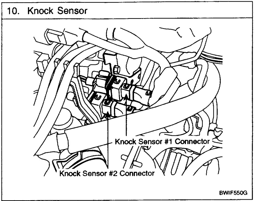

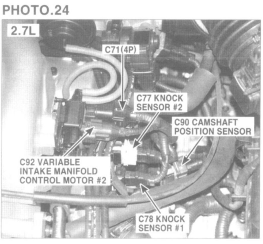

Where is the location of the knock sensor and can you provide an image?
Thanks
Jul 19, 2024 at 11:51 AM
CERTIFIED EXPERT
53,854 POSTS

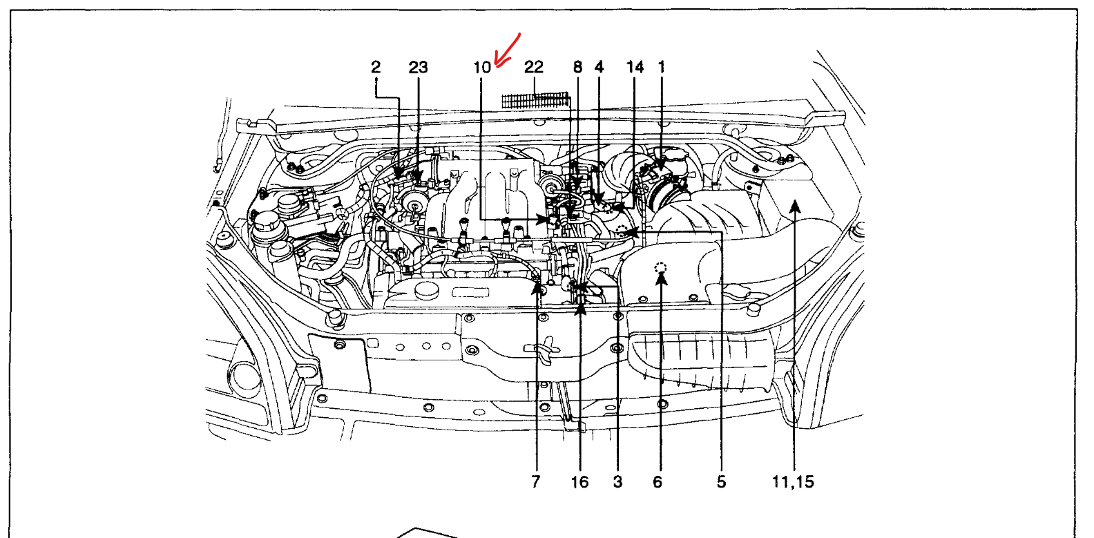

It looks like the knock sensor 1 and 2 electrical connectors are right next to each other, just follow the wiring to each sensor. Knock sensor 2 will have a white connector. Check out the images (below). Let us know if you need anything else.
