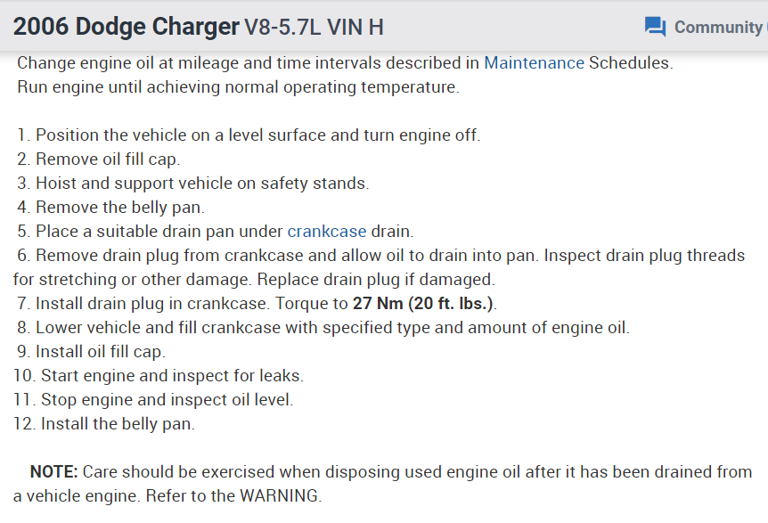

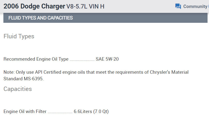

Yeah, I usually take my car to my nearest Dodge dealership for my oil changes because it's almost the same price if I did it myself with oil and a filter and it's much quicker. I'm pretty sure they're using the right velocity of oil at least it's what it shows on the sticker they put on my windshield, they don't ask what oil type I want but I just figured being a dealership they'd know what to do, someone said I should be using full synthetic oil because of the age and mileage but I'm not sure.

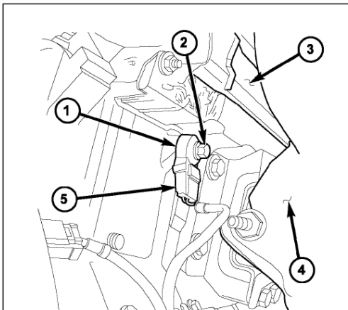

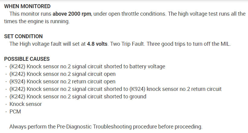

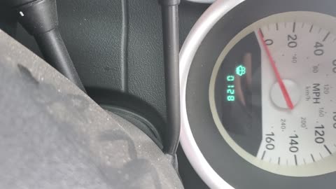

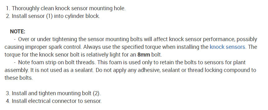

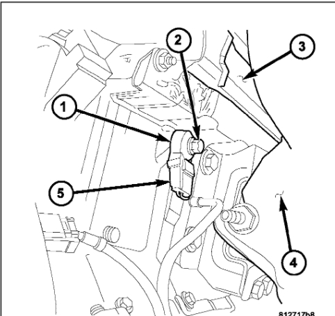

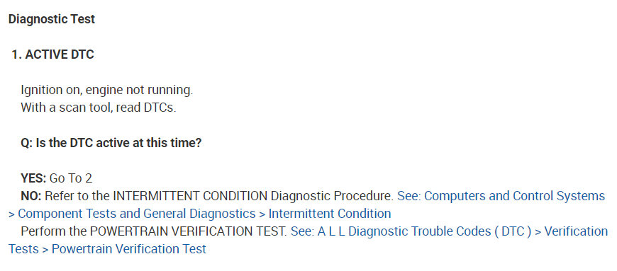

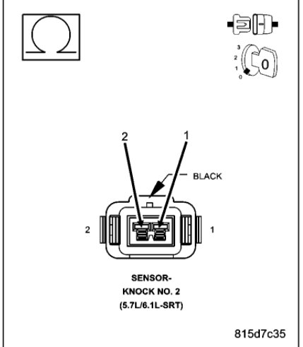

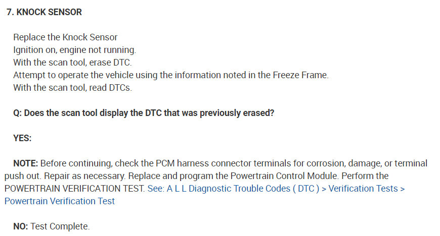

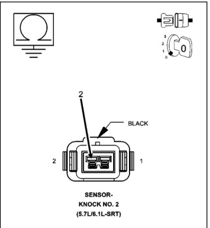

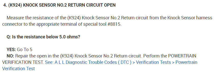

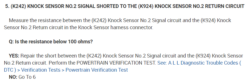

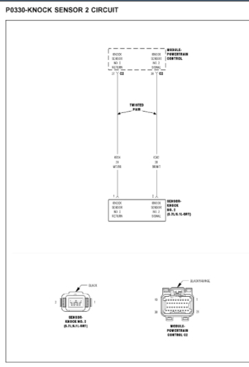

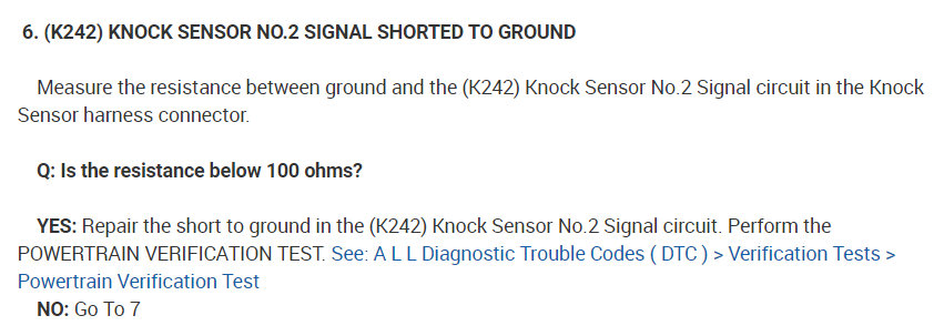

As for the knock sensor the code came up on the dash like in the video, but when I took it to a shop they said they didn't see the code on their scanner, the engine runs and drives and idles very smooth and there's only the roar of the engine, not really any other noise, except when it's cold it'll vibrate slightly but it goes away, my acceleration is funny at times and I just had the transmission rebuilt recently so I'm not sure if it's from one of the trouble codes or something else.
