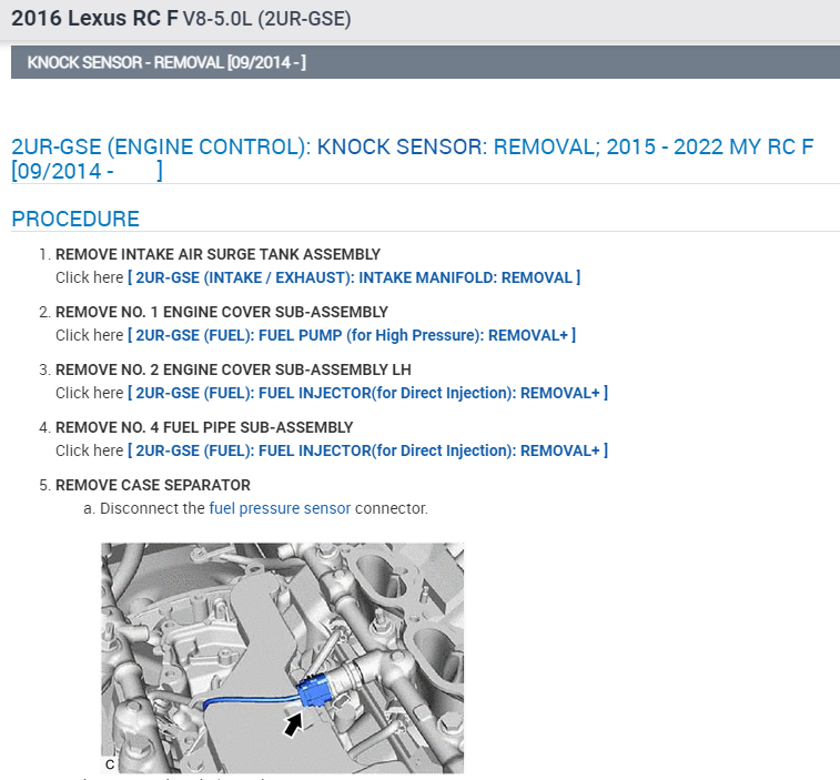

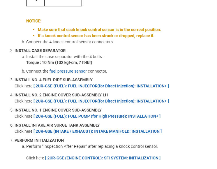

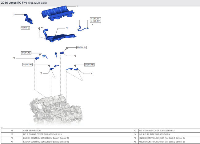

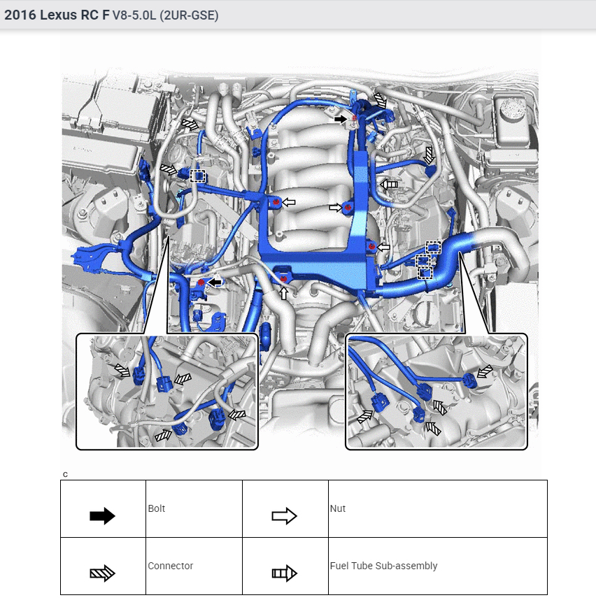

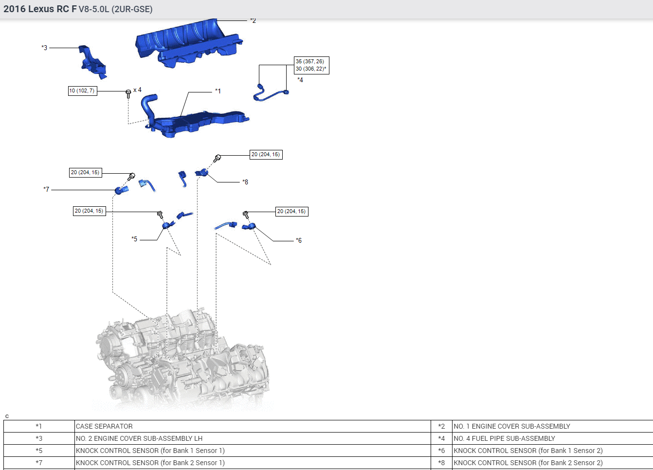

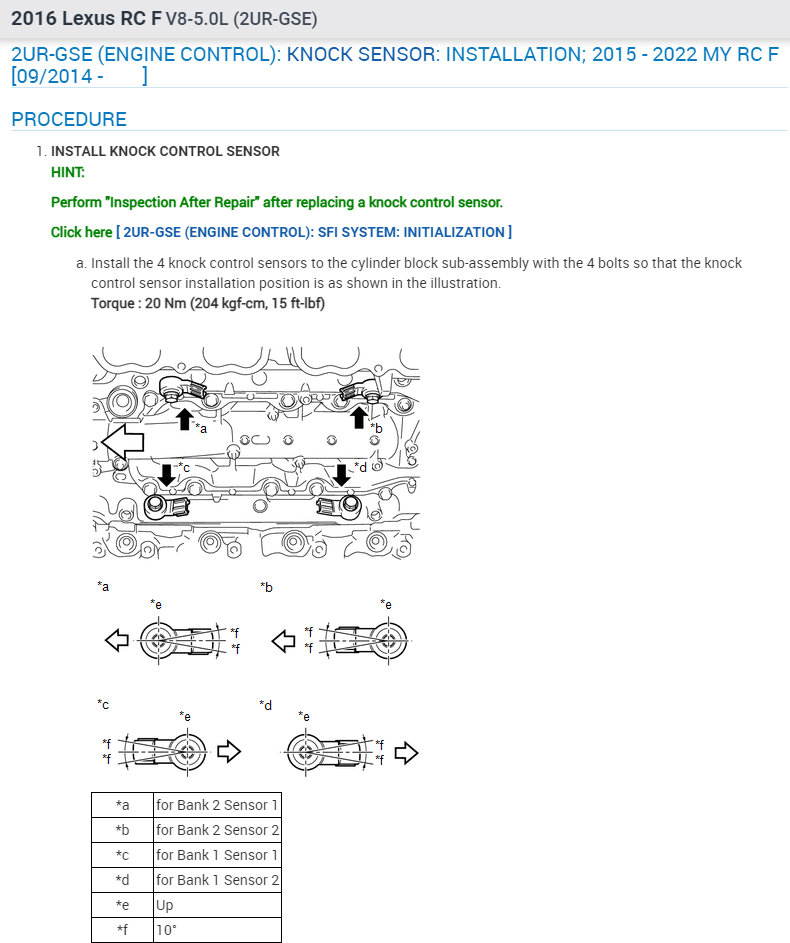

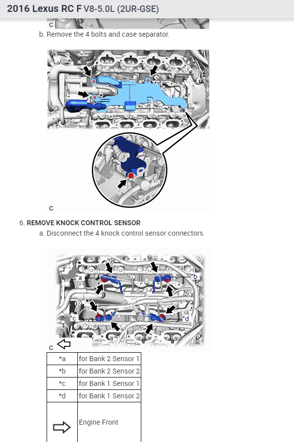

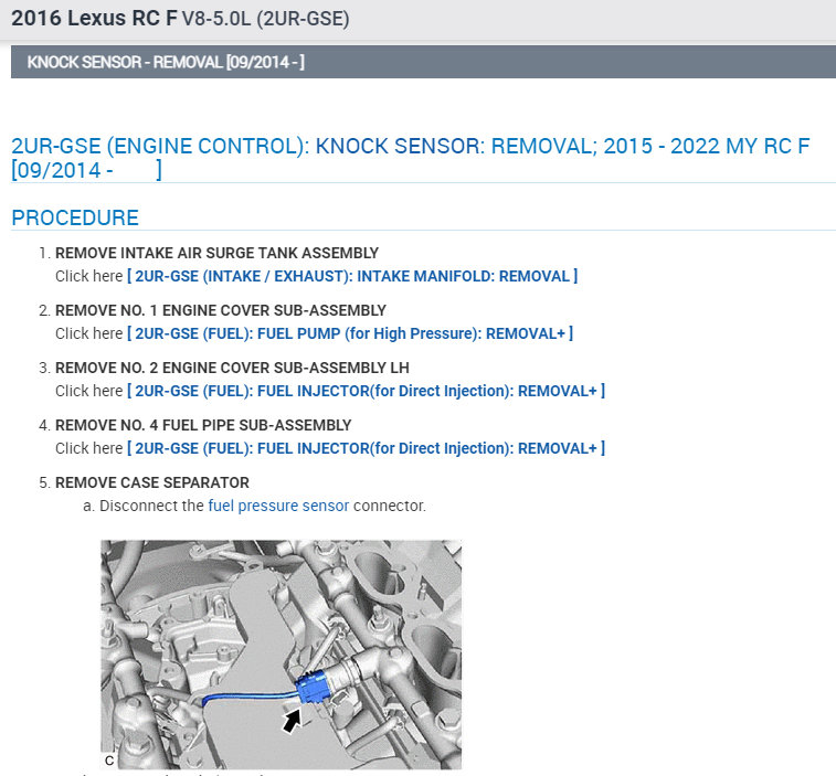

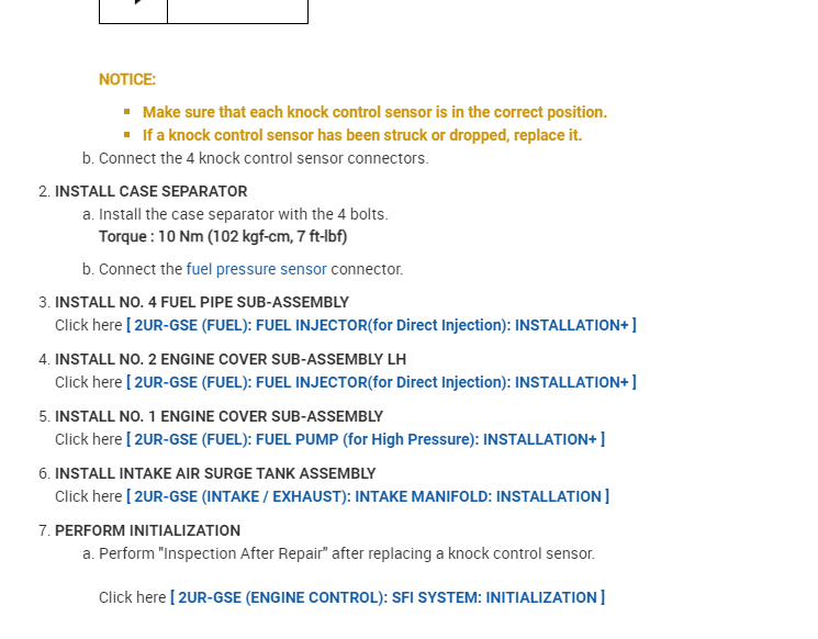

This vehicle has four knock sensors. They are located under the intake manifold. The manifold will have to be removed in order to access the sensor.
I have attached diagrams below for your reference.
Let me know of any questions.
