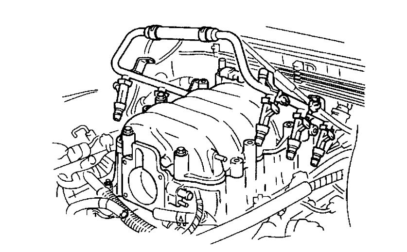

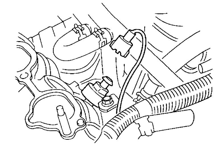

I attached the procedure and pictures of the location for you.

4. Remove the common chamber assembly. Refer to Common Chamber in Engine Mechanical.
5. Disconnect the electrical connector from the knock sensor.
6. Unscrew the knock sensor from the engine block.

NOTE: Do not apply thread sealant to the sensor threads. The sensor is coated at the factory and applying additional sealant will affect the sensor's ability to detect detonation.
1. Screw the knock sensor into the engine block.
Tighten the knock sensor to 20 Nm (177 lb in.).
2. Connect the electrical connector to the knock sensor.
3. Install the common chamber assembly. Refer to Common Chamber in Engine Mechanical.
