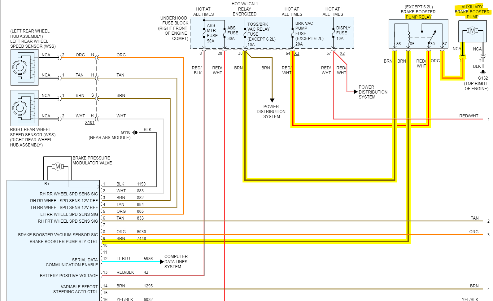

This vehicle does have a Brake Booster Pump, which is controlled by a brake booster pump relay, there is also a brake booster vacuum sensor on the booster. The Brake Pedal Position sensor on this is actually like a APP sensor for the gas pedal, it has 2 Potentiometers, one receives a 5vRef and sends a signal to the ECM and the other gets its 5vRef and signals to the BCM. So, it's a bit of a different setup, newer technology.

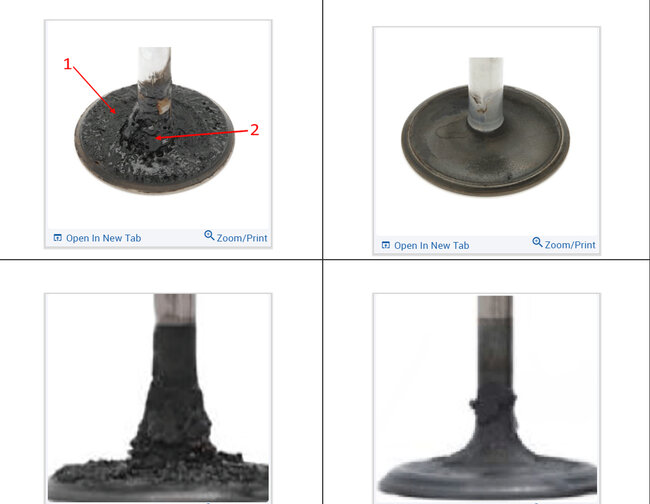

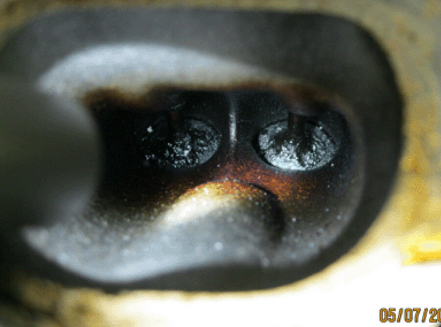

The hesitation you are feeling might be a carbon build up issue in the Intake ports and on the back of the Intake valves, this being a GDI high pressure direct injection engine, they have major carbon build up on the intake valves because there are no fuel injectors in the Intake manifold anymore. With conventional fuel injectors they spray into the intake and help to clean the intake valves. But with direct injection the fuel injectors spray directly into the cylinder, so GDI systems need to have a intake valve cleaning done manually. It's usually a walnut blasting of the intake valves. Thats the best way to get them cleaned up. If it's never been done on this vehicle, with that mileage it's way overdue. It will eventually lead to cylinder misfire codes.
Another thing to watch for is the high-pressure fuel data PIDs on a scan tool. These GDI systems can run 800 to 2000psi fuel pressure. So, if the "Desired" vs the "Actual" fuel pressure is too low or high, just things to watch for. But it will usually set a code if the fuel pressure sensors are reading out of spec. But valve cleaning is something that should be done with regular major services. Personally, I'm not a fan of these systems just because of this issue alone. But it's something that most manufacturers are incorporating now. So, it will still have a low-pressure pump in the tank, but also a high-pressure pump driven by a camshaft. With steel lines running to the fuel rails that are a onetime use. Here are some pictures of what happens to the intake valves. The fuel injector tips also start to get carbon build up on them too, restricting flow.

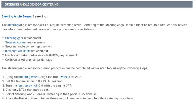

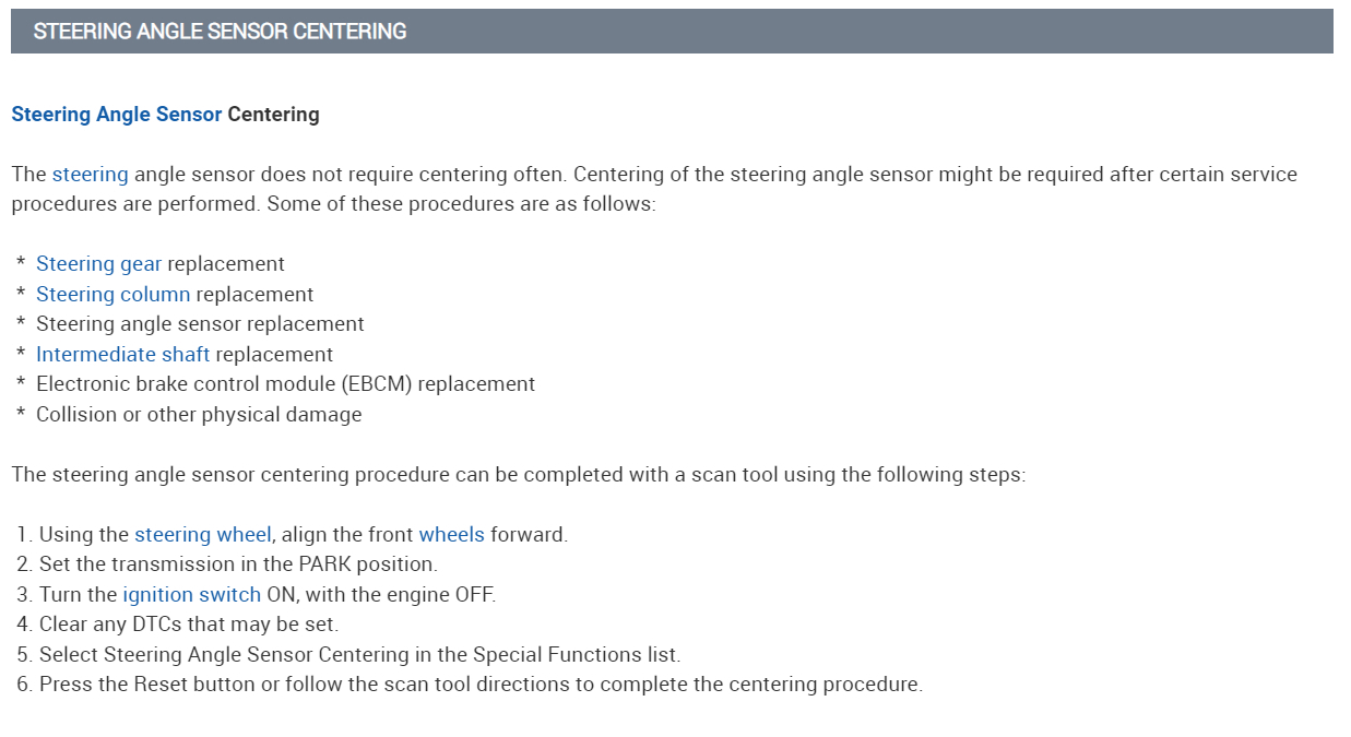

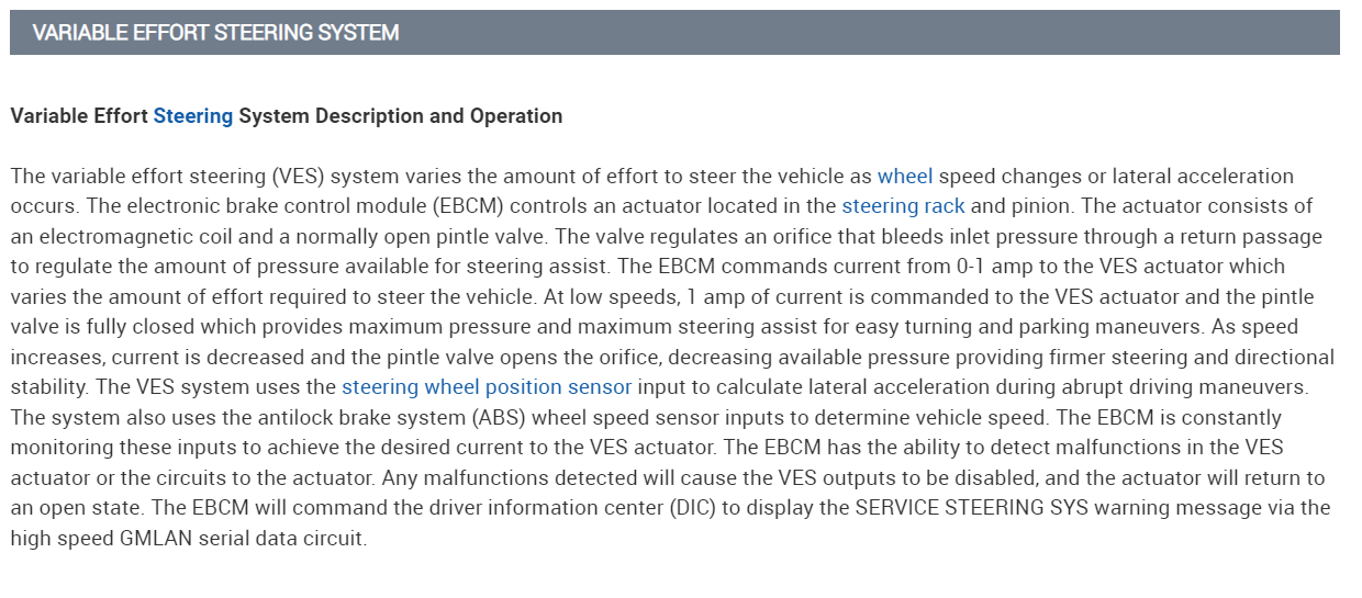

On the steering issue does the vehicle have electronic power steering? Where an electric motor is used to assist with steering. You would notice a large electric motor incorporated into the steering rack. And a lack of power steering pump and fluid reservoir. Some newer vehicles use a steering angle sensor along with the conventional fluid power steering system. Since the system works with the ABS(EBCM) system, you might want to have a full system scan done on the vehicle to see if there are any codes stored in any other modules besides the ECM. It might be that the steering angle sensor needs to be calibrated, Vehicle systems now are becoming so complex with a module for every little thing. Most of the time we need to rely on the built-in diagnostics to give us a direction, with either a code or something noticeable in live data.

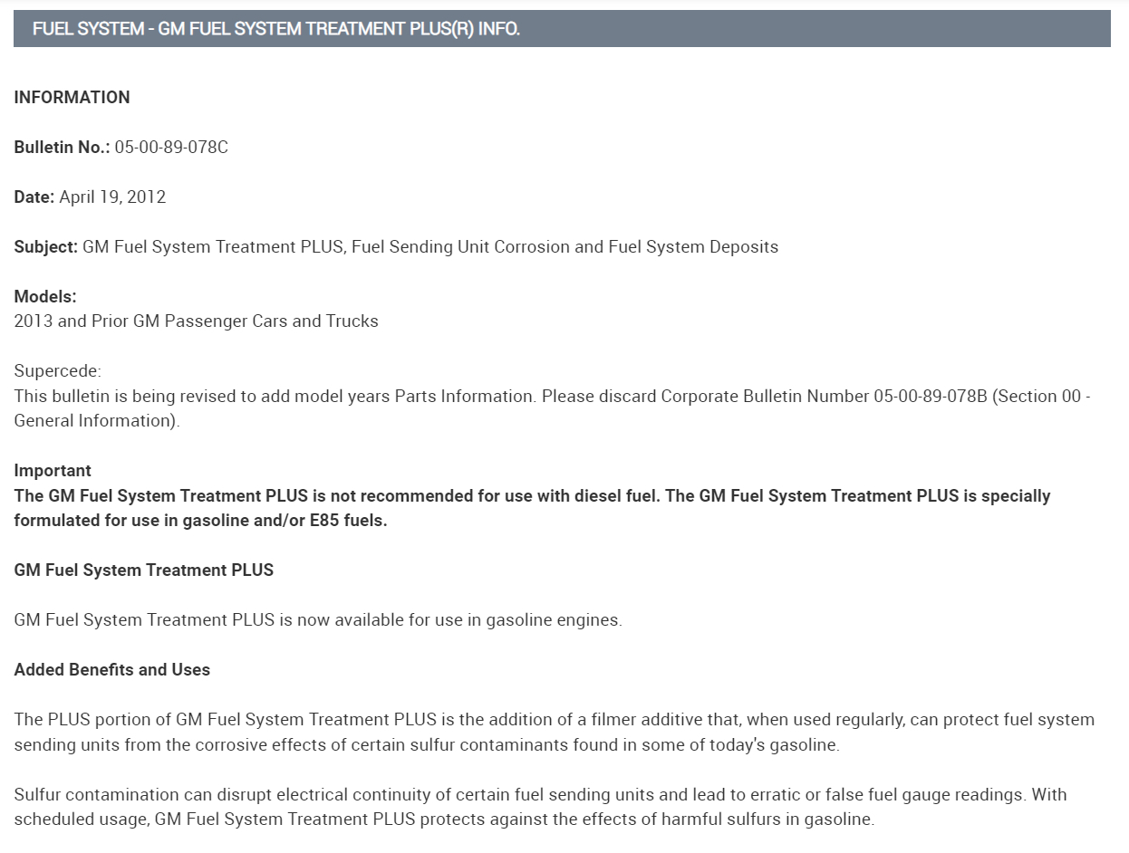

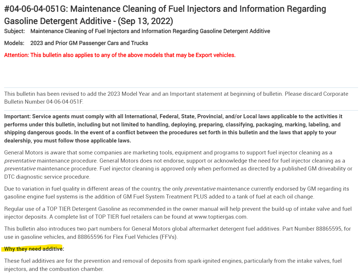

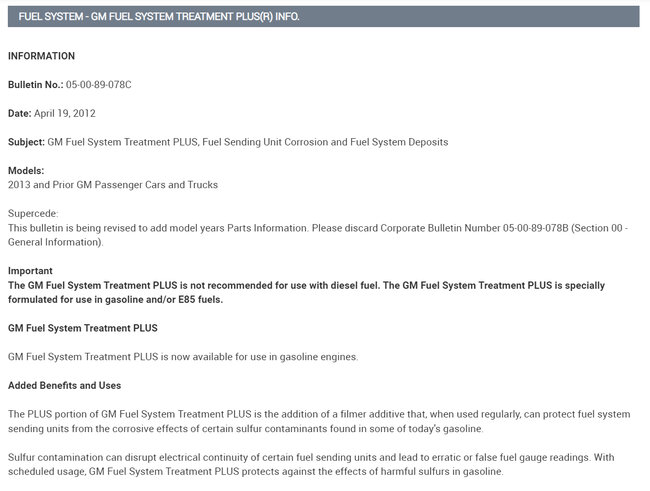

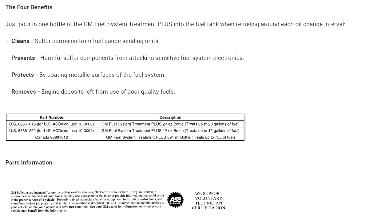

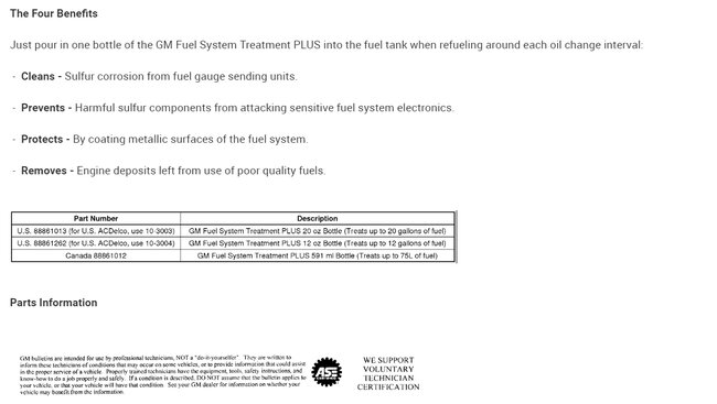

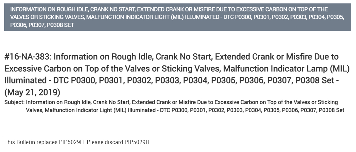

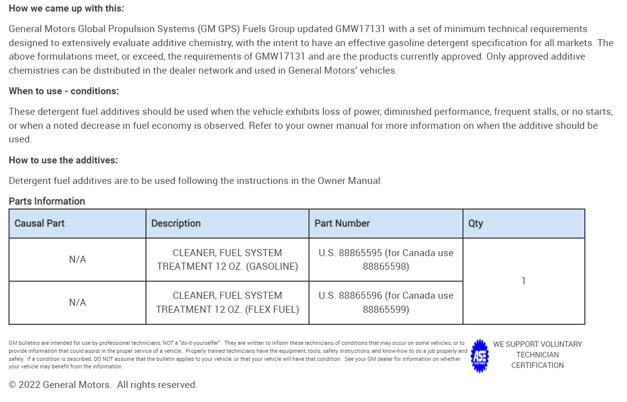

GM has quite a few bulletins out on fuel system treatment and cleaning. Diagrams 3,4 are together, and 5,6. Both are TSBs on the fuel system treatment. There are about 14 or 15 TSBs just on the fuel system alone.

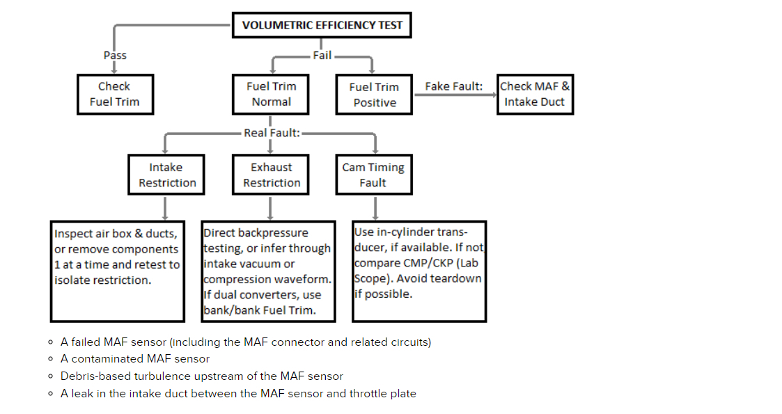

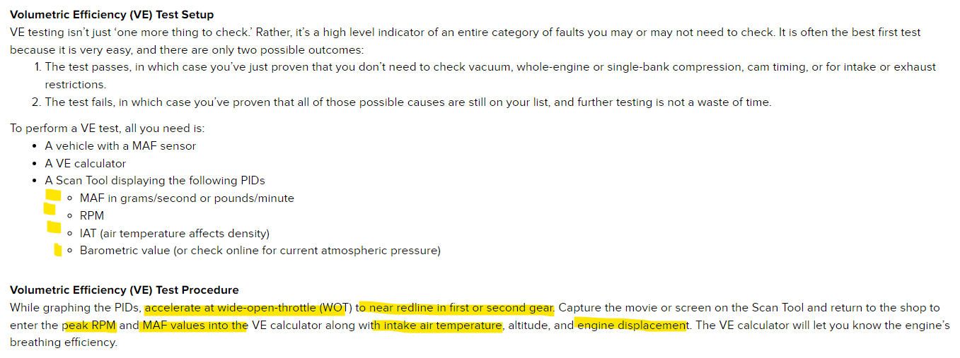

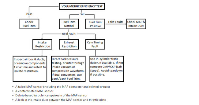

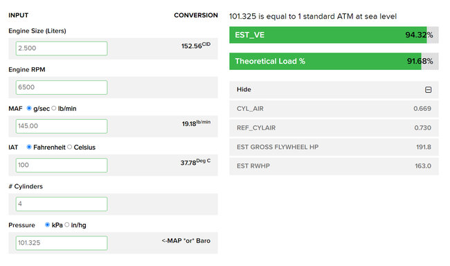

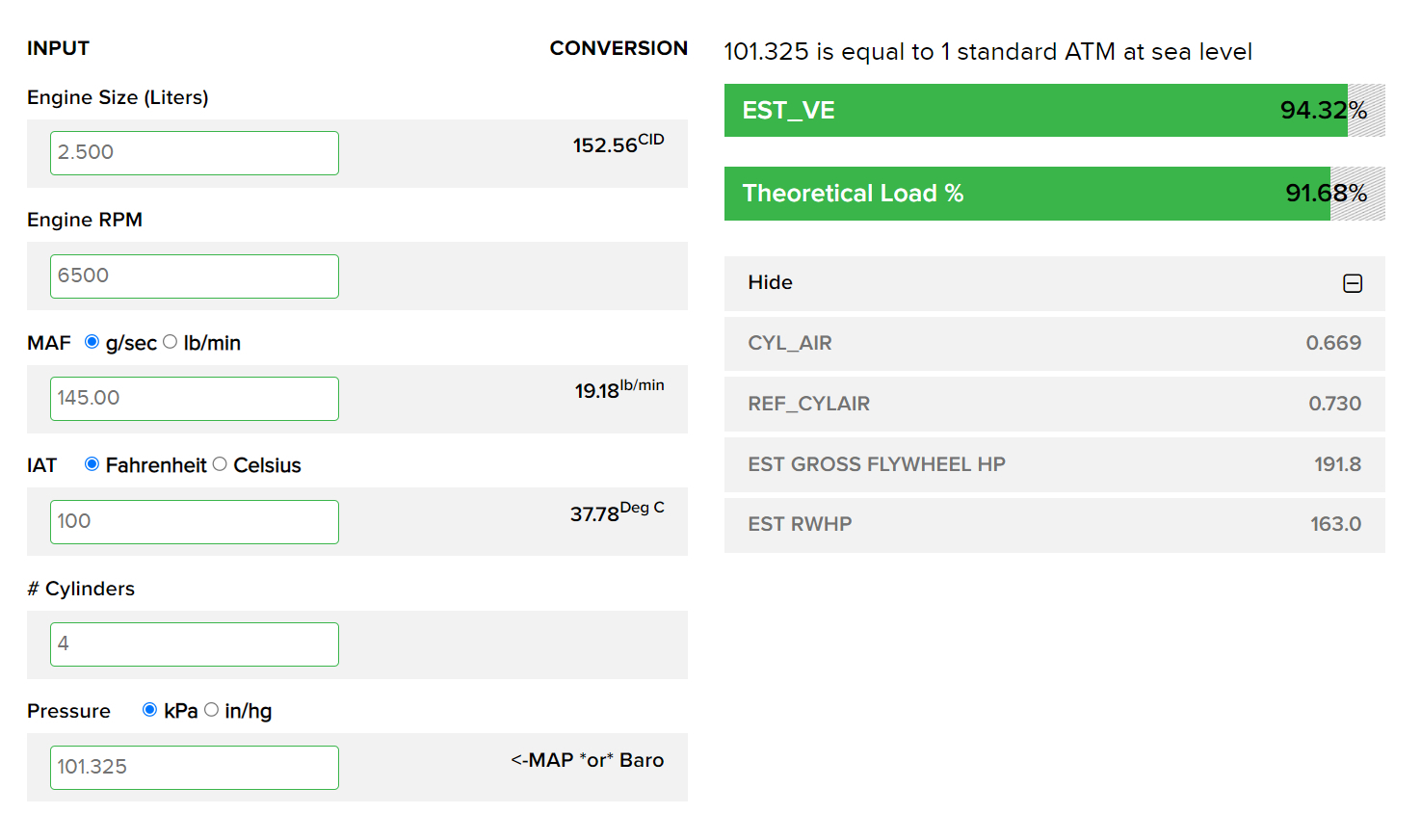

If you can do a wide-open throttle run, (on some street where you won't get a pulled over) and record the peak RPM and the Mass air flow reading at that RPM we can calculate a Volumetric Efficiency test. The test instructions are in the 7th diagram, and the 8th is an example of a tests results. It's a great test, but the correct data has to be collected to do it. But I do think the issue is going to be carbon build up, especially if the vehicle has never had the intake valves cleaned and it's at 150,000 for mileage now.
