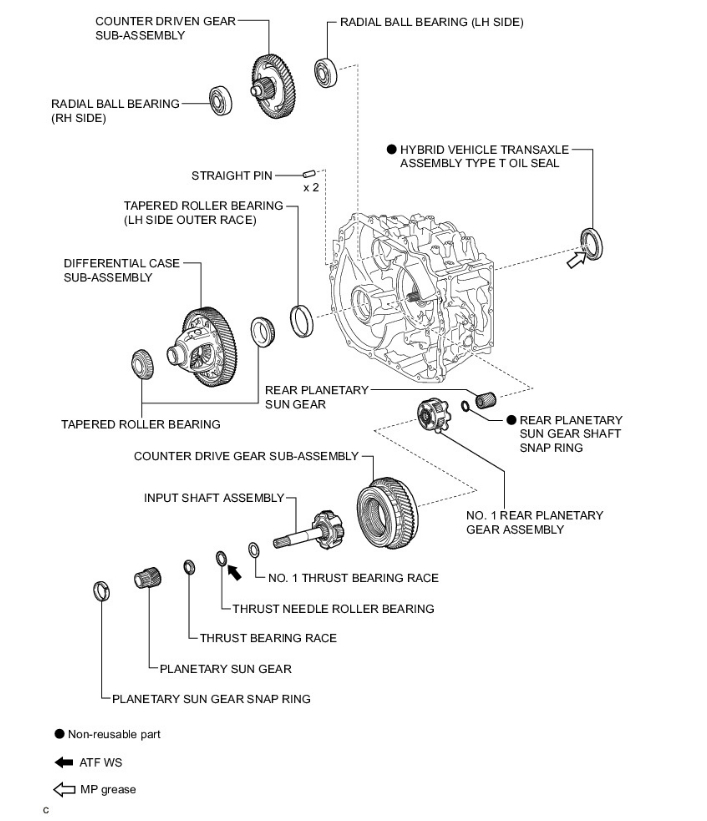

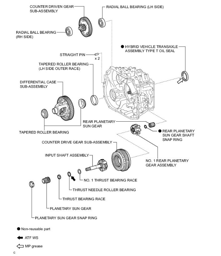

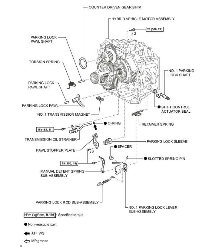

Thanks for the video, you are right the engine is okay and I don't is it misfiring, it sounds more like the Hybrid transmission front planetary or possibly the input shaft can you tell if the engine is coming from behind the engine and in the transmission area? Here is what I am talking about. The noise can cause the knock sensor to go off and cause the engine to become unbalanced which can cause the random misfire codes. Check out the images (below). Please let us know what happens.

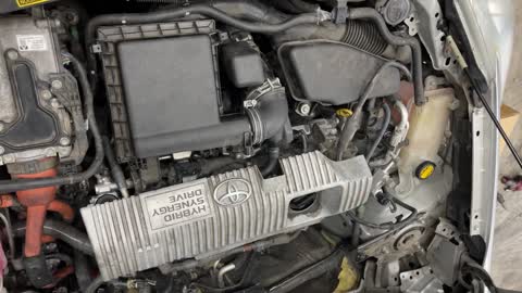

If the noise has just begun then it could be cold only at first and then wear further to be present at all times. I still think it could be the coupler between the engine and transmission. Can you get a video of the noise from under the car?
Jul 5, 2023 at 9:31 AM
BHAMDOC1973
  • 2,008 POSTS
Attached. Started the day bit not as bad as before.
Jul 6, 2023 at 6:23 AM
Thanks for the video. yep, that is a good one. I will ask my other experts if they have heard the problem and get their input.

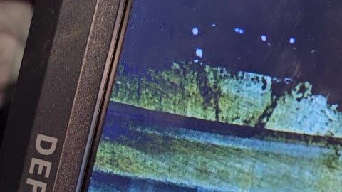

I have a good camera and I thought that was the issue, but there is nothing on the walls or cylinders and the pressure held all day as far as a leak down test. Also, i didn't have to top off water since i did all that and drove it 350 miles. Keeps giving me cylinder 1, then when i switched all gave me 2 then 1 and 2, its random not always same cylinder. Sometimes the misfire is there, sometimes not. The misfire count is around 15-20 on cylinder 1, and then maybe 2 on cylinder 2. Then after a couple of seconds all are zero. Oil looks good, coolant is where it should after all the driving, weird.
