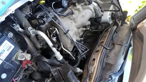

That is with the back value cover off.

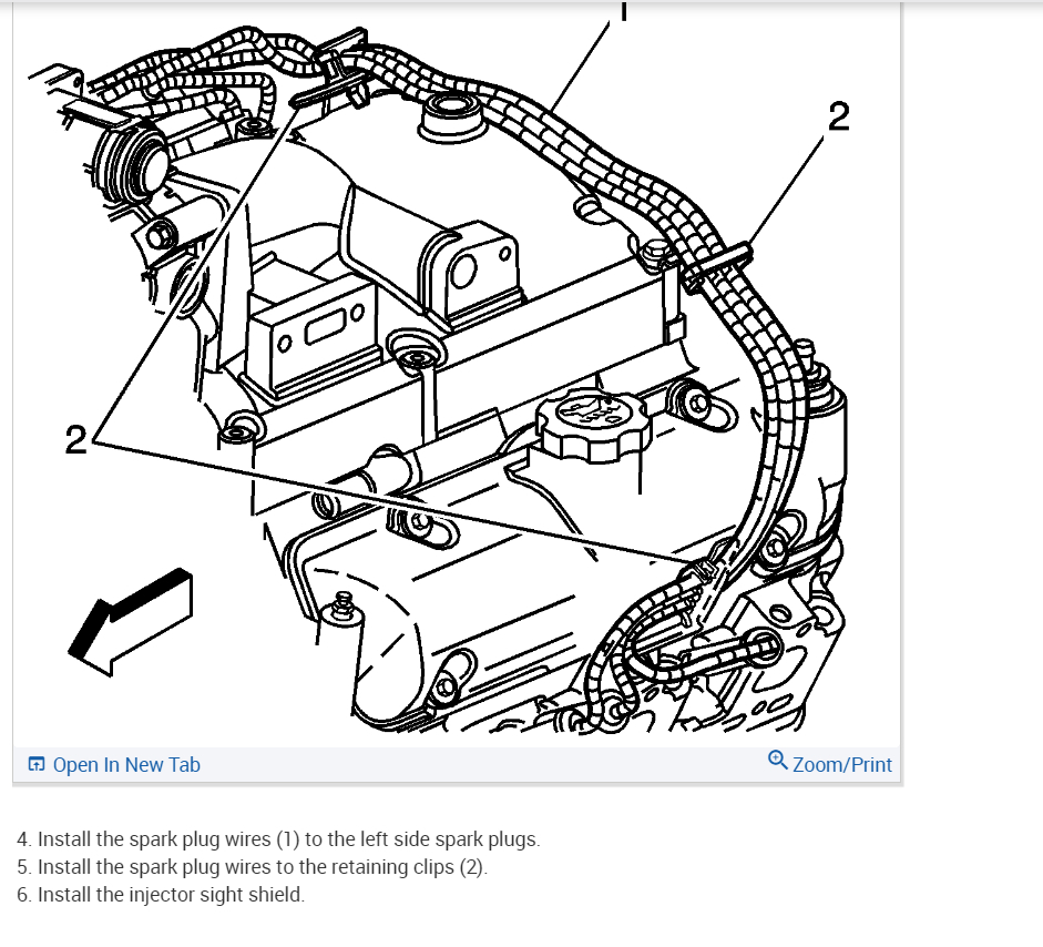

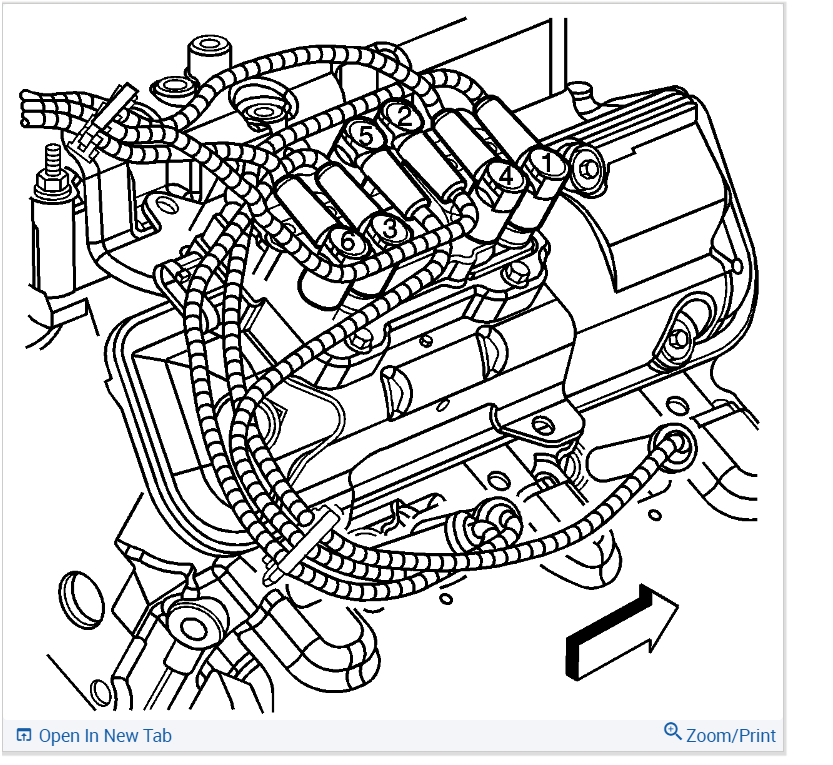

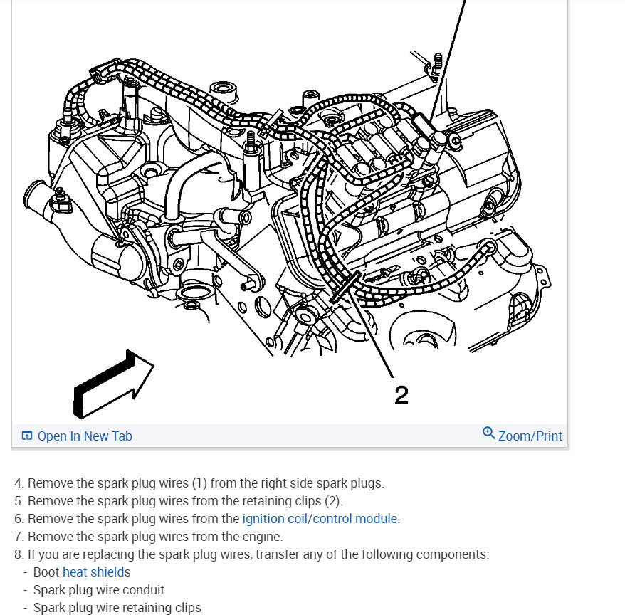

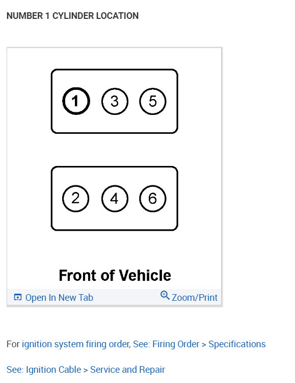

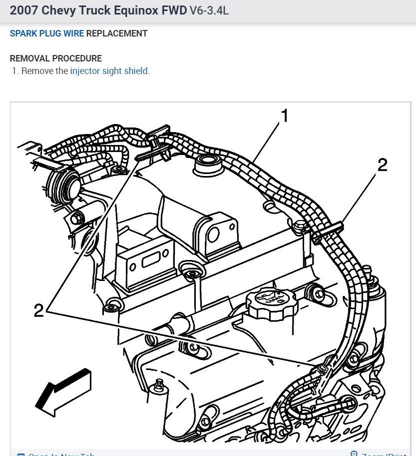

It looks like the spark plug wires could have been installed incorrectly. Can we please double check it?
Firing Order .................... 1 - 2 - 3 - 4 - 5 - 6
