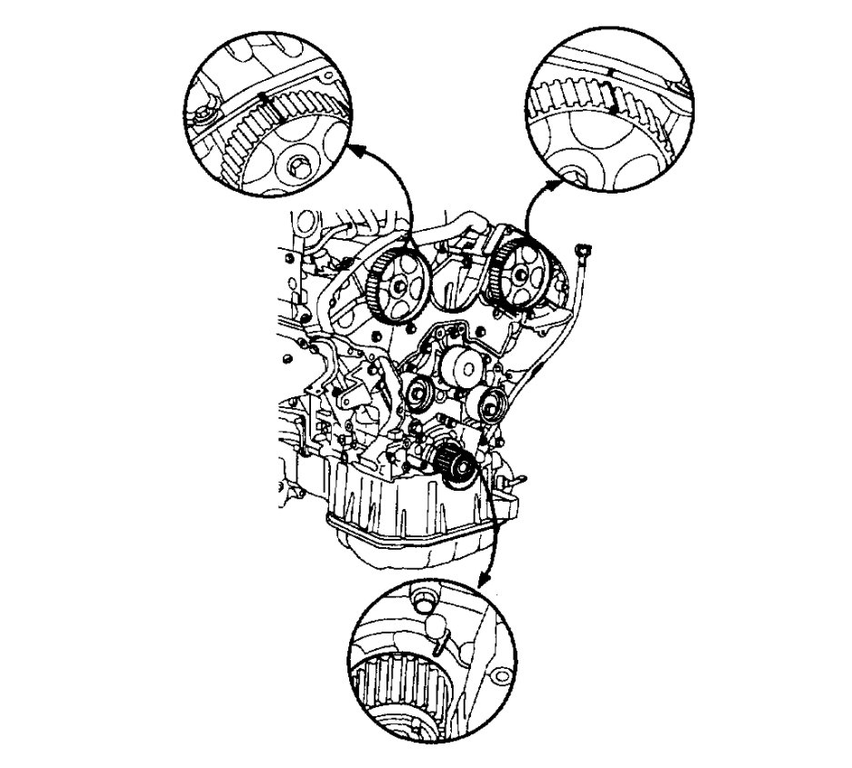

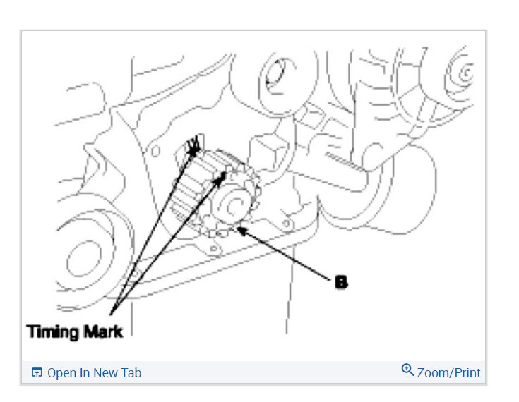

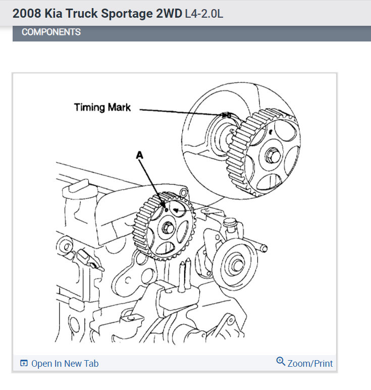

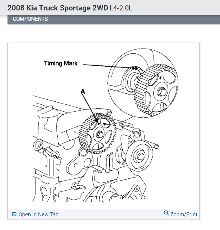

I need to know the timing marks for the timing belt.The truck starts up but is running ruff and the check engine light is on code P0016 Cam/Crank correlation Senor A-Bank 1 i am of by one tooth forward or backward luckily nothing happened. Help please! Jose Ford I have got to get ny Father in-laws truck done. Thanks
Jun 19, 2010 at 7:59 AM
If you need timing marks check the diagrams below there is both 4 and 6 cylinder engines. Check out the diagrams (Below). Please let us know if you need anything else to get the problem fixed.
