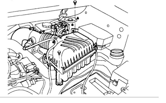

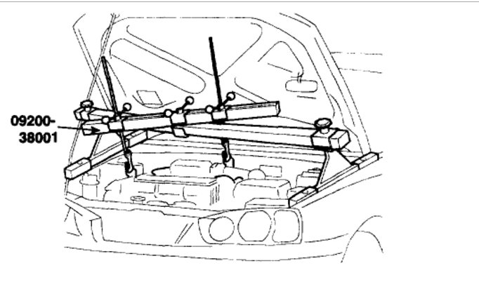

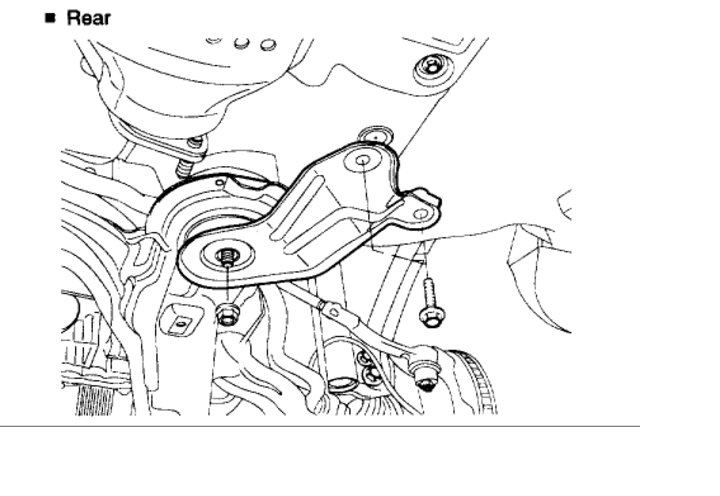

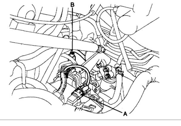

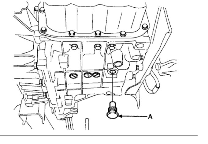

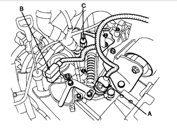

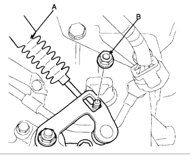

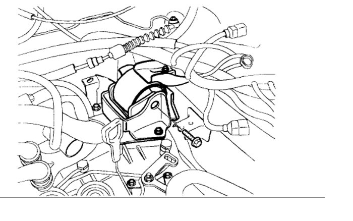

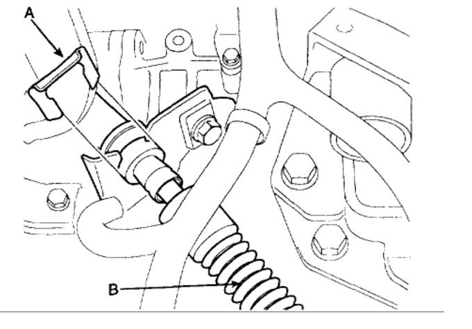

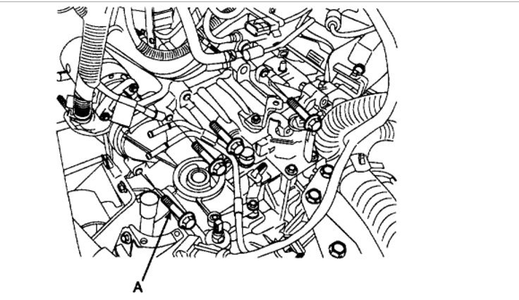

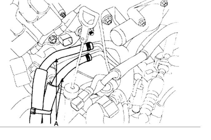

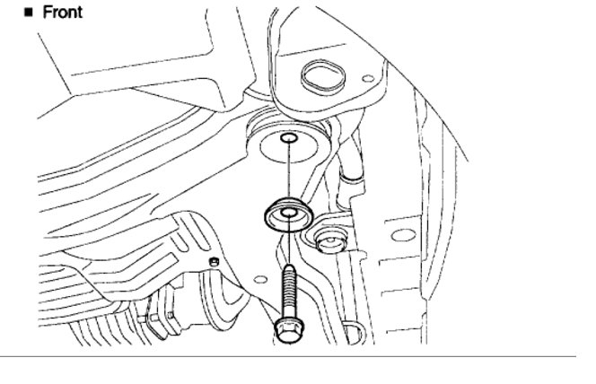

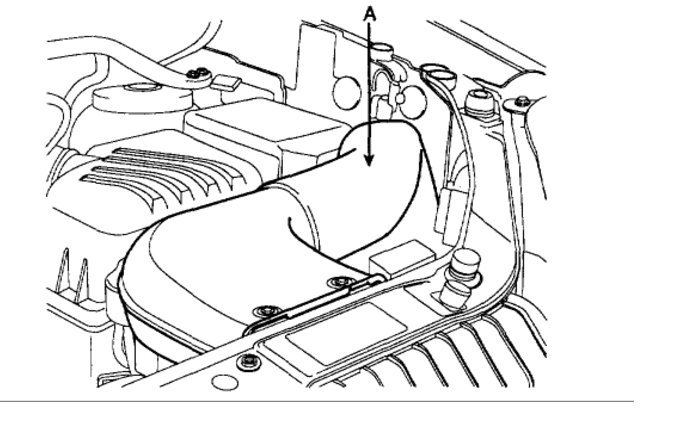

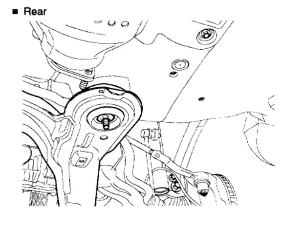

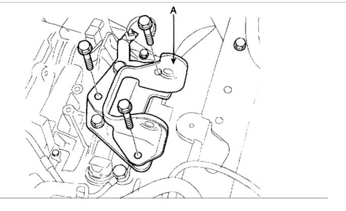

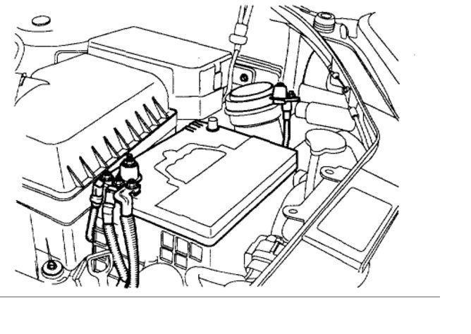

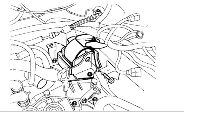

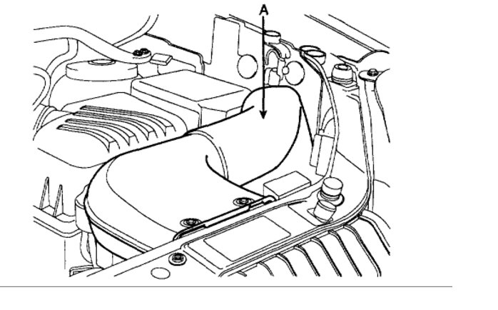

You access the torque converter bolts through the starter hole.
Check out the diagrams (below). Please let us know if you need anything else to get the problem fixed. Cheers
