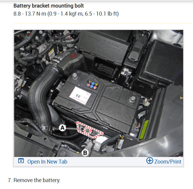

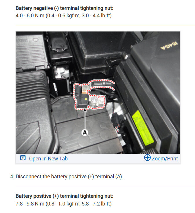

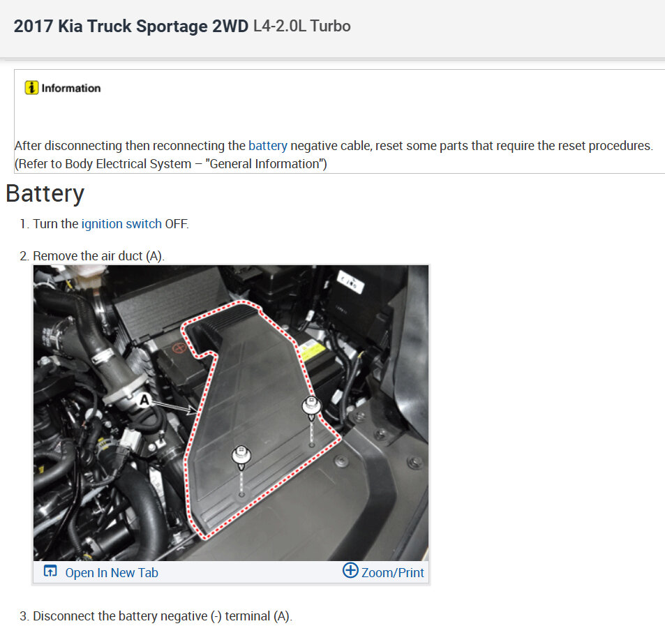

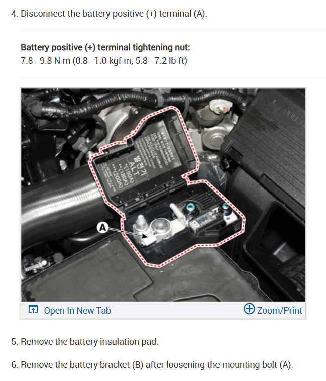

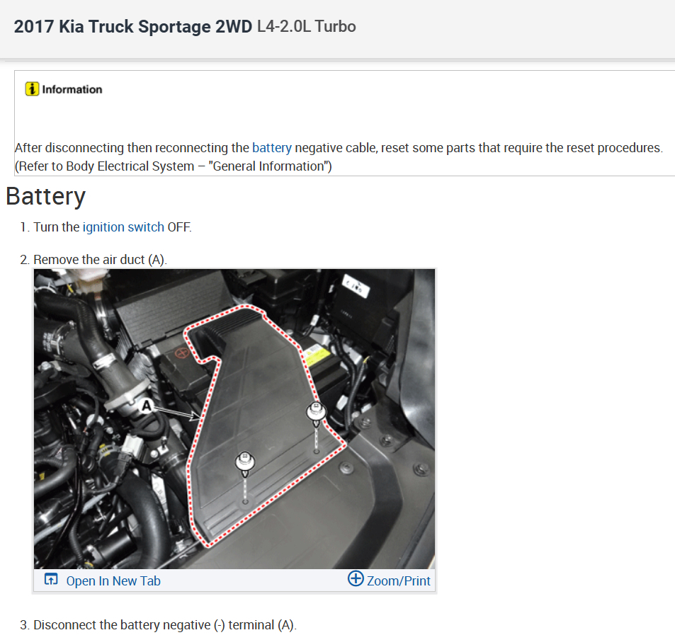

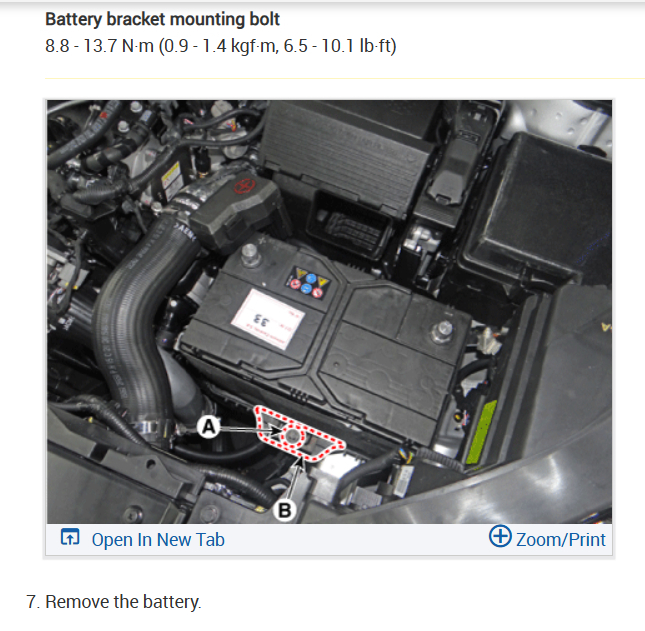

Yes, you have the right idea, in the wintertime car batteries go bad, tizz the season as my dad would say. Here is a way to load test the battery or you can remove it and have the auto parts store test it for you:
Check out the images (below). Please upload videos in your response of any problems so we can see what to help you with.
