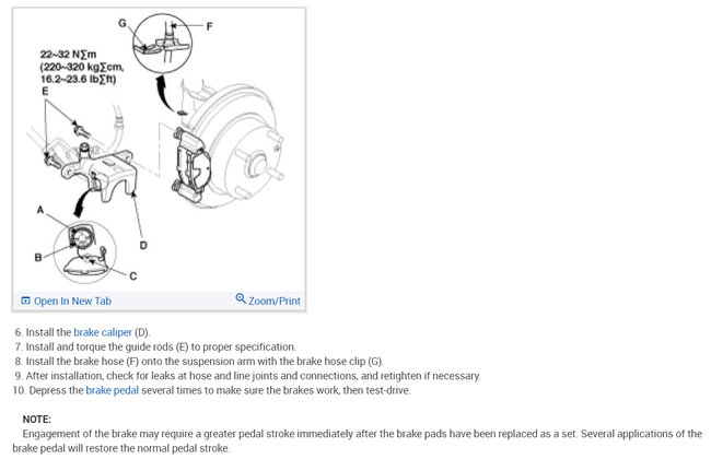

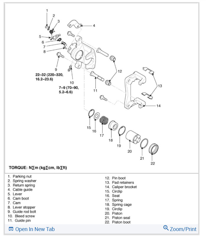

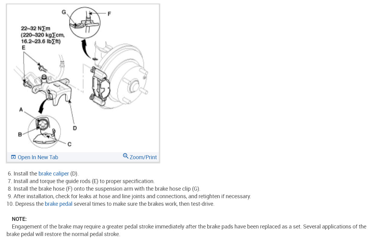

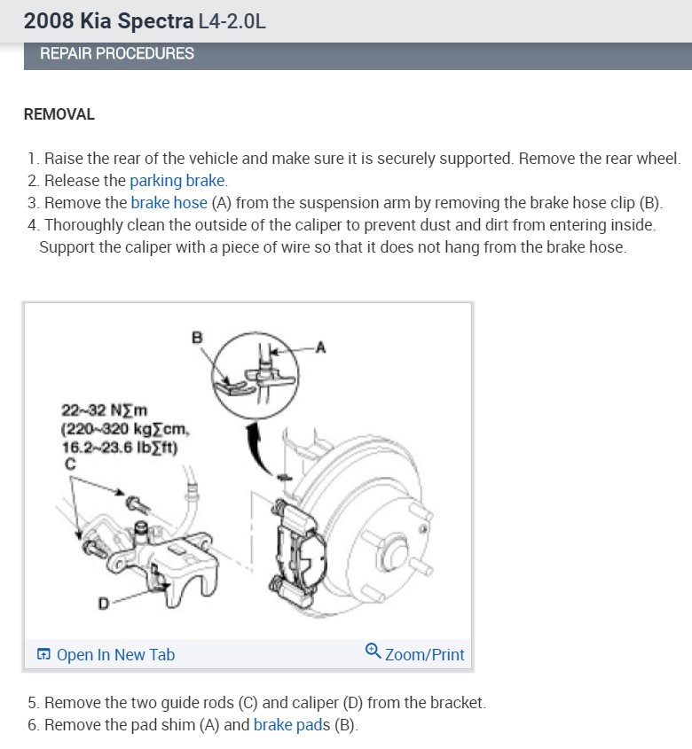

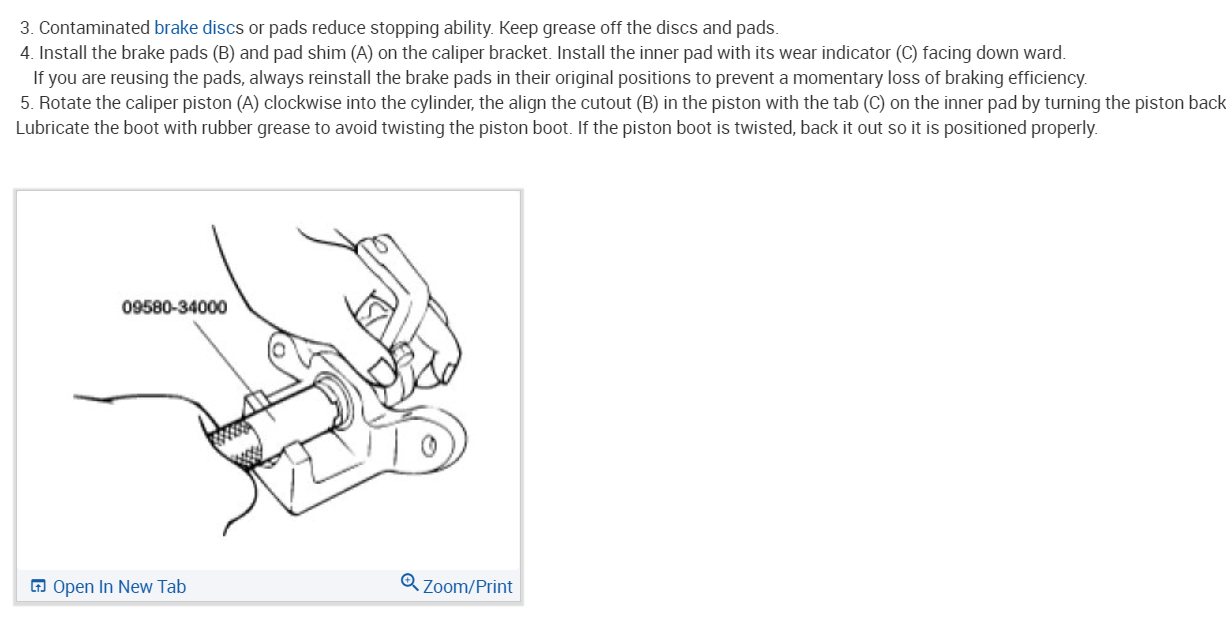

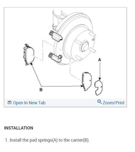

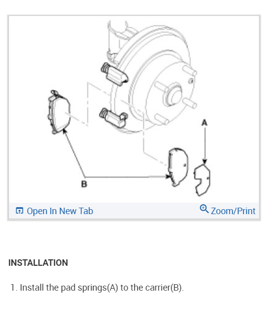

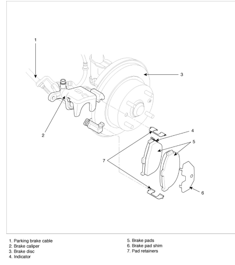

This is the same style of brake that is on the Hyundai cars here is a video of the job being done yours will be very similar. Check out the diagrams below to see how the job is done on your car.
https://youtu.be/G5M_xKIxUb4
