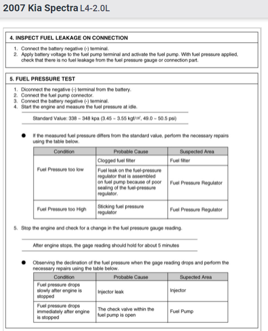

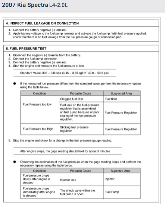

It sounds like you might have issue with fuel to the engine. It is possible to have dirt and debris in the fuel line and that is causing the engine to not get proper fuel. It can lead to hesitation while driving.
If the engine light is illuminated, you need to get it scanned to retrieve the code(s). It can help with the diagnosis.

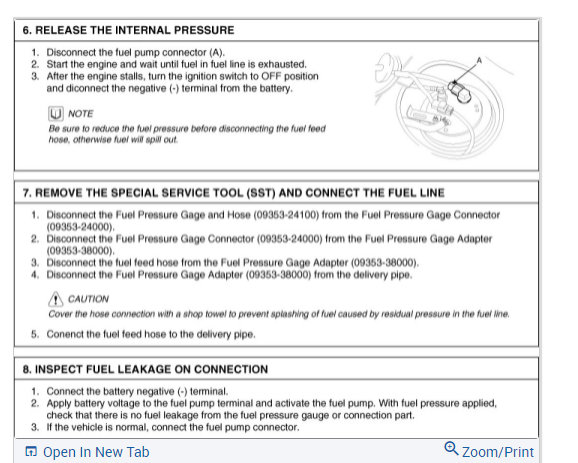

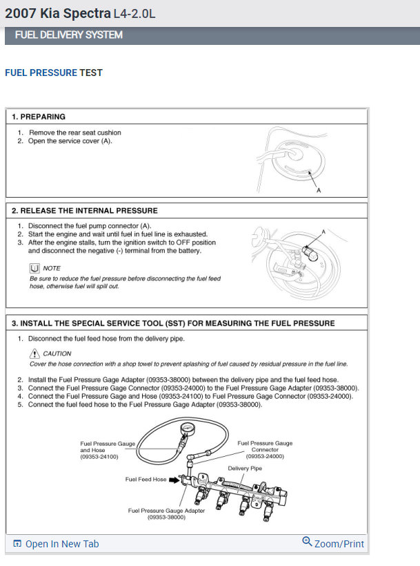

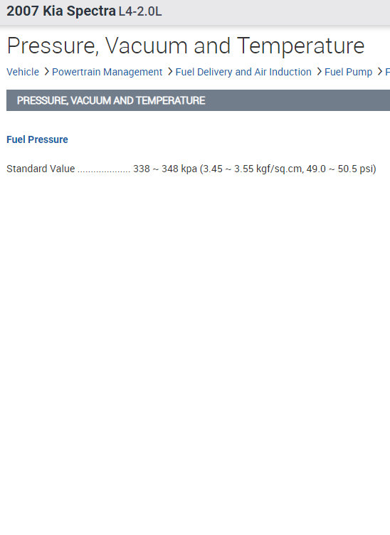

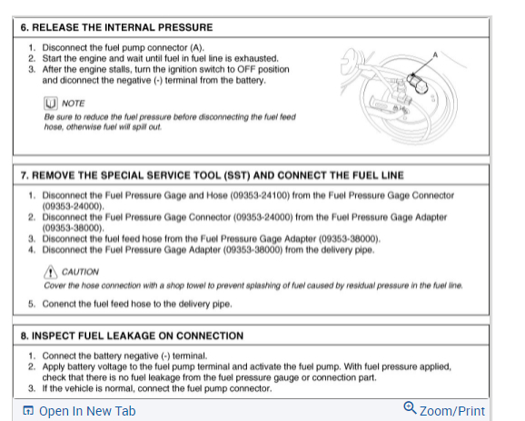

Check to see if you are getting adequate fuel pressure to the injectors. You do that test using a fuel pressure test gauge. Those tools are typically available to use at your local auto parts store.
This vehicle should have about 50 PSI of fuel pressure.
Here is a helpful video:
https://youtu.be/aITQclp7zIE

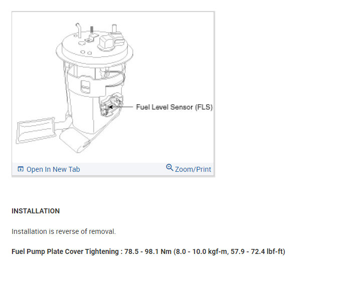

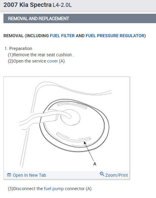

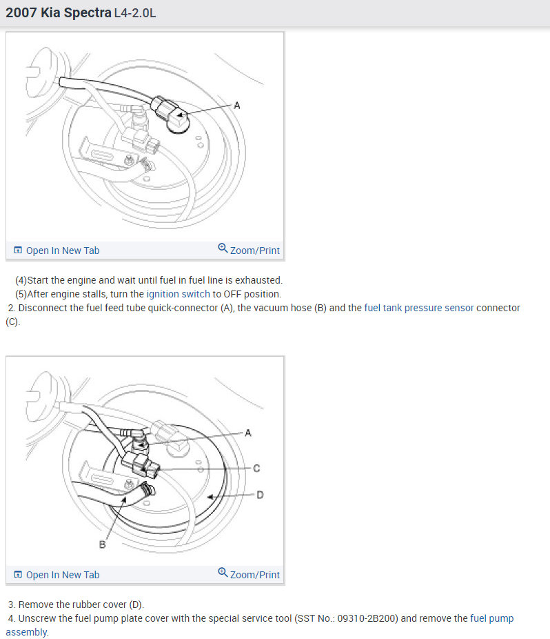

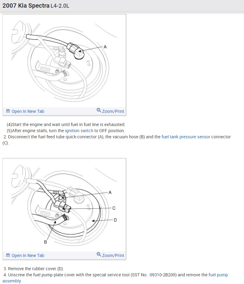

The fuel pressure can be low due to a bar fuel pressure regulator or a clog in the fuel filter.
On this vehicle the regulator and the filter are located in the fuel pump assembly.
I have also attached the fuel pressure testing procedure as well as regulator diagrams for your reference.
Thank you.
