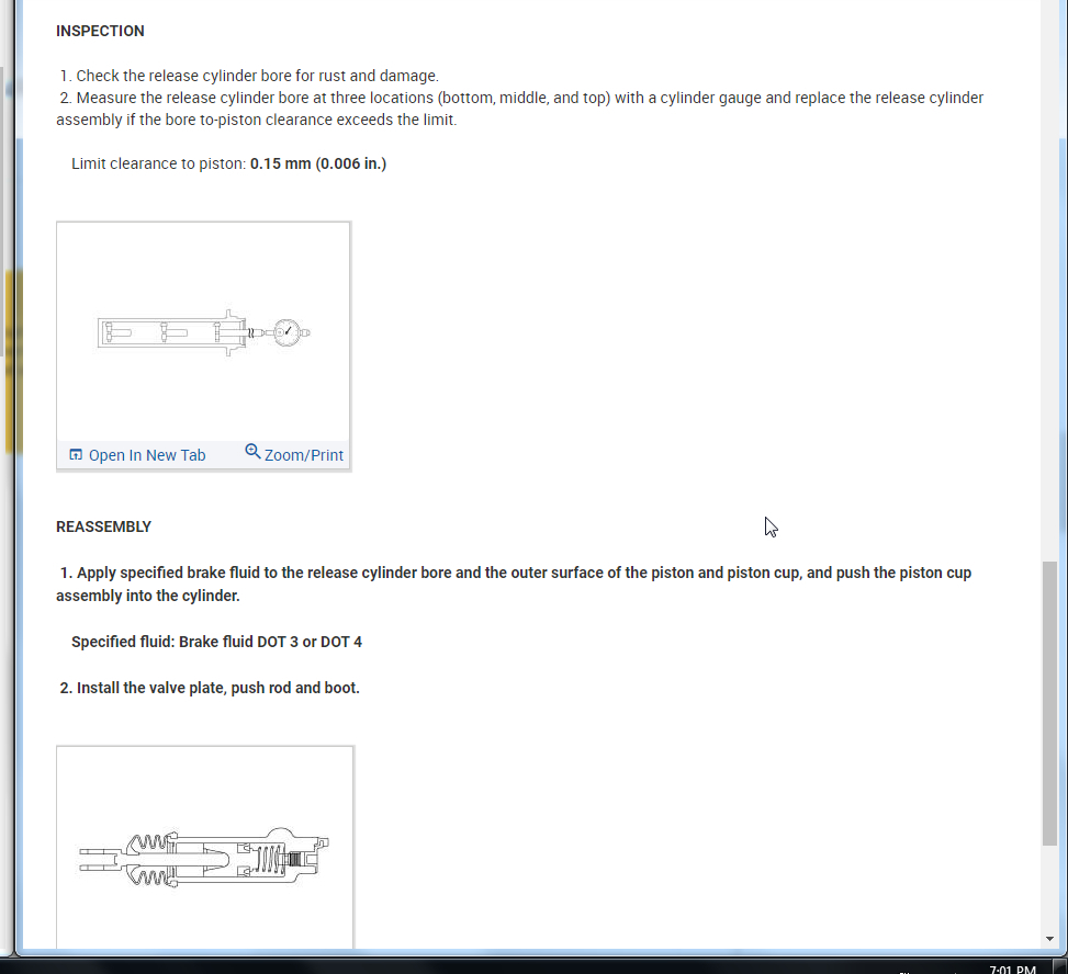

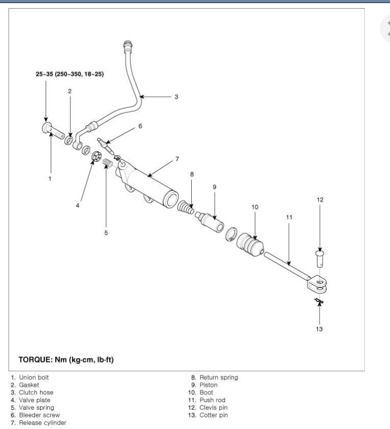

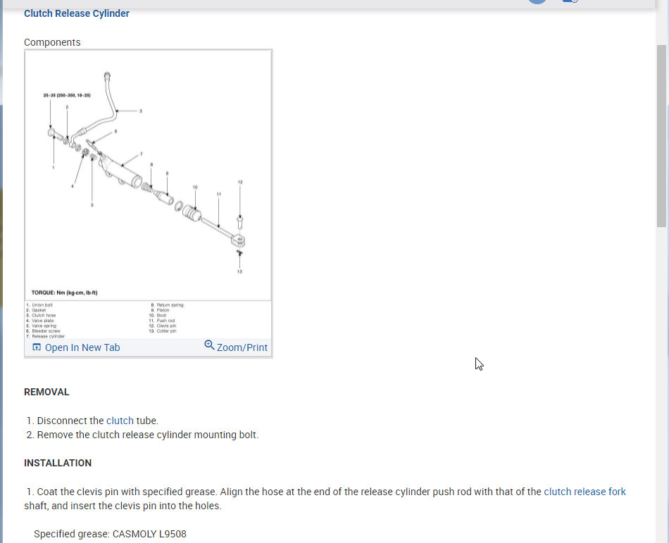

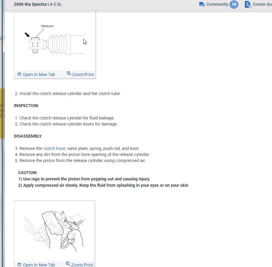

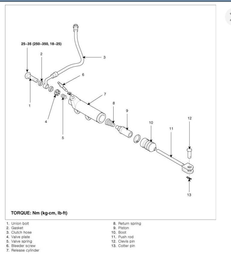

Below you will find the process from the manual that will help with this.
If this is what you replaced then we need may have an issue with the synchronizers but that is more rare so I would think we have another issue. Thanks
