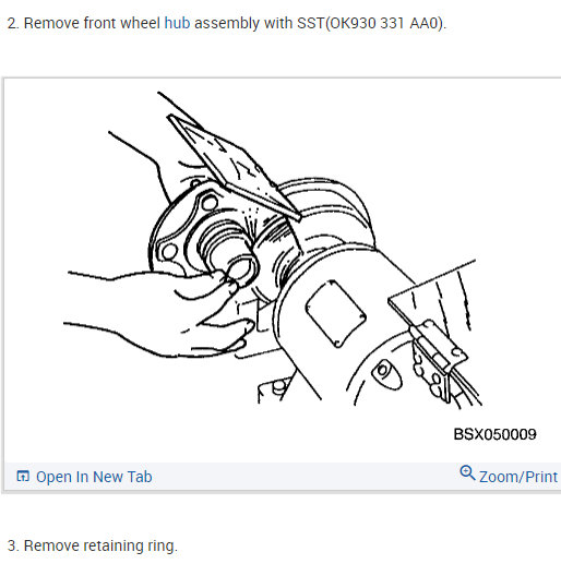

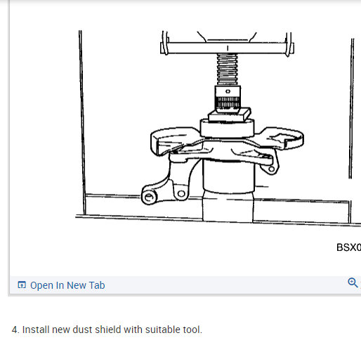

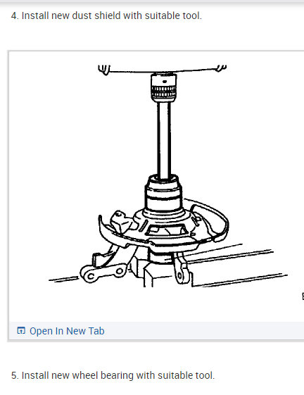

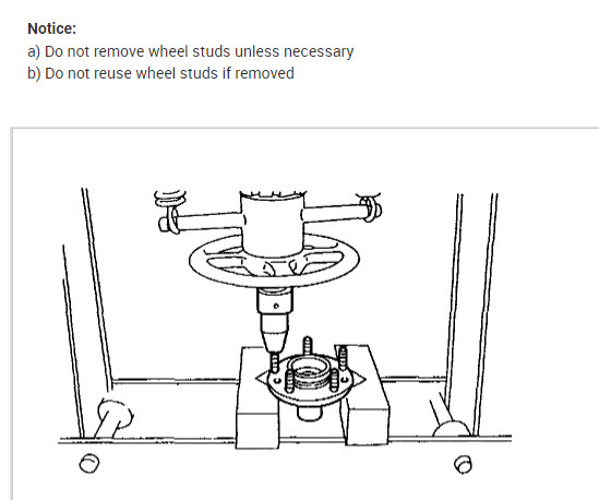

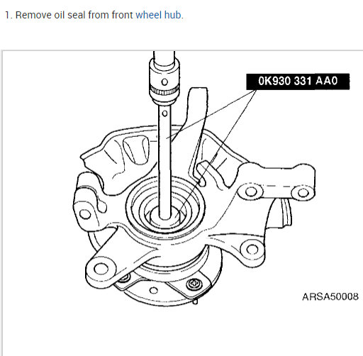

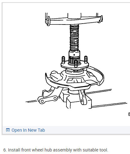

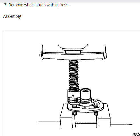

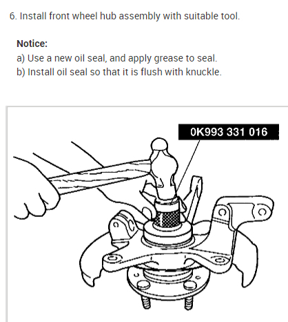

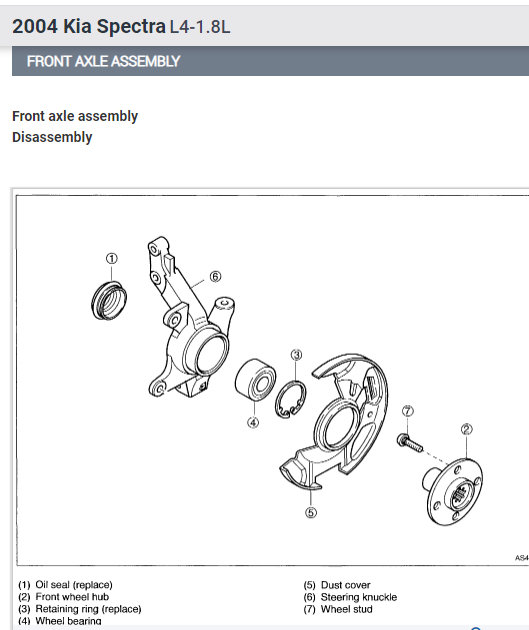

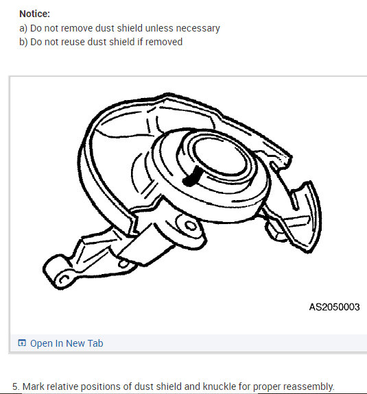

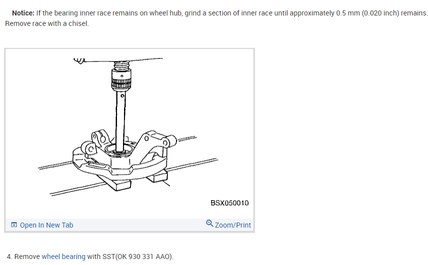

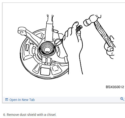

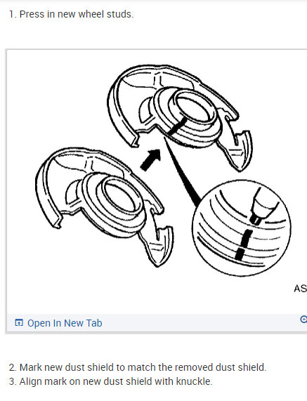

I've attached picture steps below for wheel hub replacement for your vehicle. Hope this helps and thanks for using 2CarPros.
