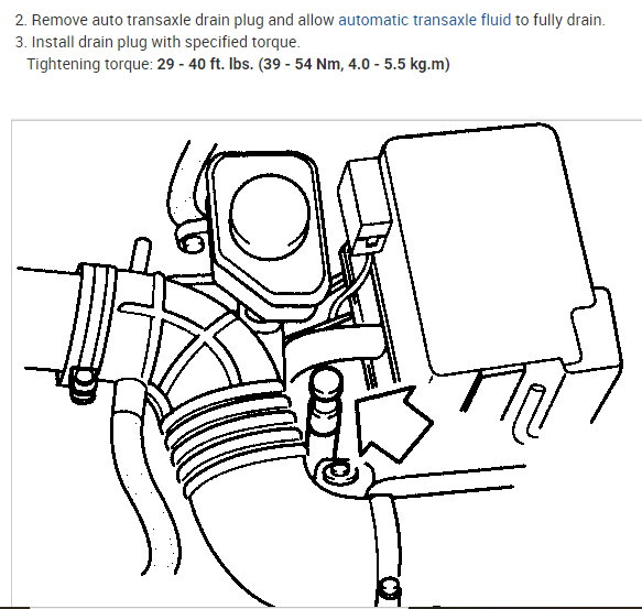

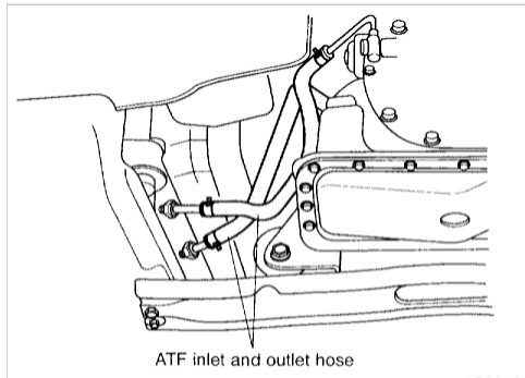

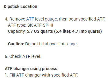

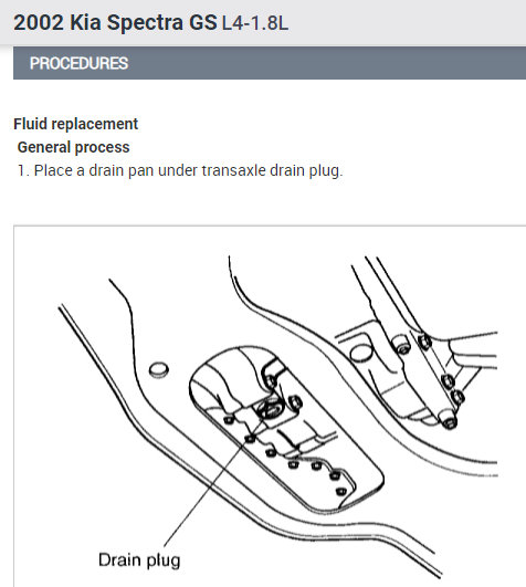

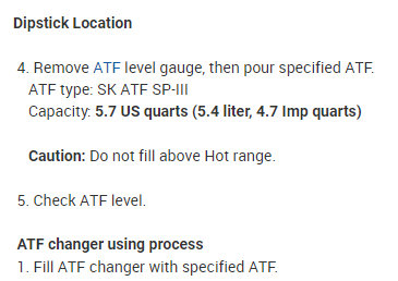

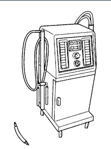

Here is the information you requested. This is a tutorial showing how to change the fluid in an automatic transmission:
I've attached picture steps below on how to remove and replace the transmission filter and fluid on your vehicle including the drain plug location. The instructions also show how to change the transmission with an automated machine but tell people to avoid this procedure as to not having the transmissions dirty filter replaced using this method. The instructions also show the recommended transmission fluid to use. Hope this helps and thanks for using 2CarPros.
