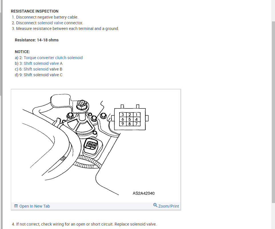

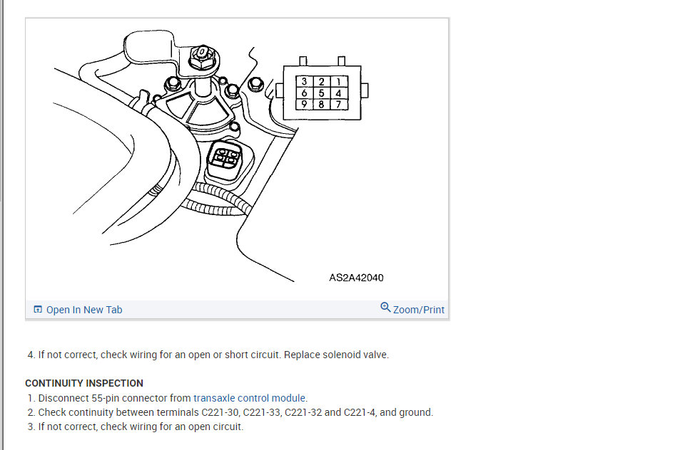

However, below is a test that we can run through for the torque converter solenoid just to find out if it is functioning. If it is then the clutch itself is slipping and will require replacement.
Please run through all this testing and let us know what you find. Thanks
