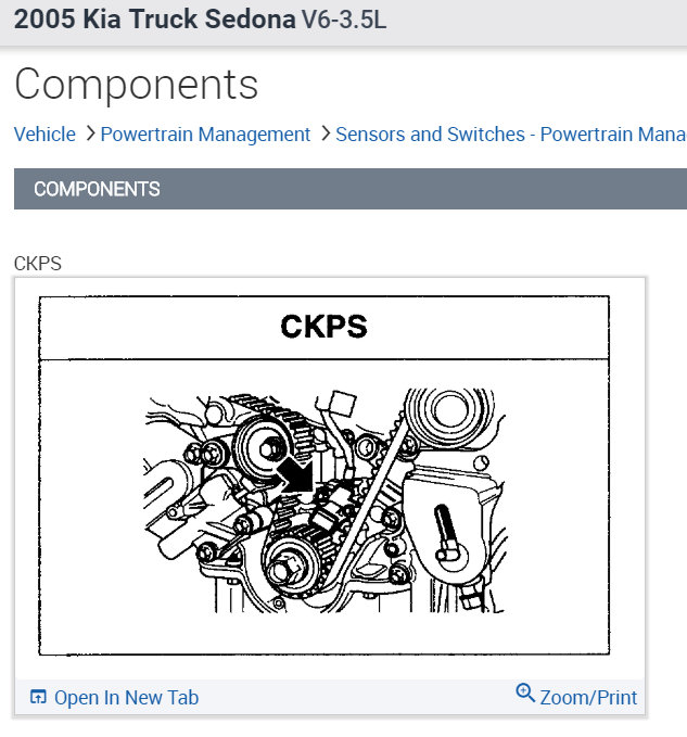

crankshaft position sensor where is it. Is it easy to replace how much time to replace it?
Mar 19, 2009 at 8:24 PM
DAVE H
  • 13,384 POSTS
The Crankshaft Position Sensor is next to crankshaft sprocket. Here is a diagram below to show you the location and how to replace it. This guide will walk you through the steps with diagrams below for your car.
