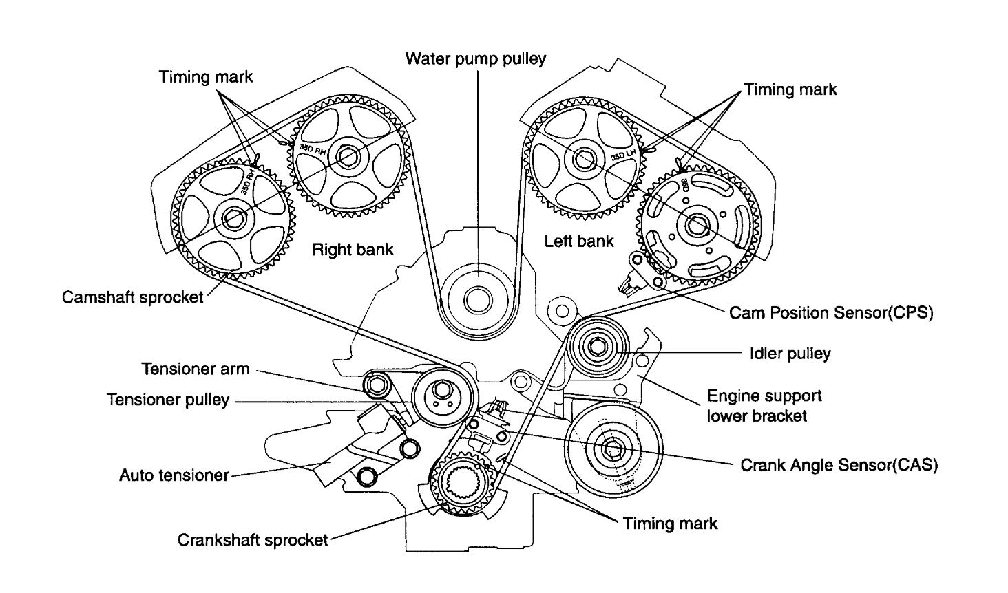

how do I reset the timing on a 2005 Kia sedona 3.5 DOHC once the timing has jumped so that the valves do not slam into one another, Is there a way to know if you have the cams in the correct position when timing marks are in line

https://www.2carpros.com/forum/automotive_pictures/261618_Noname_2570.jpg
https://www.2carpros.com/forum/automotive_pictures/261618_Graphic_644.jpg
Heres another diagram that shows all of the timing marks
