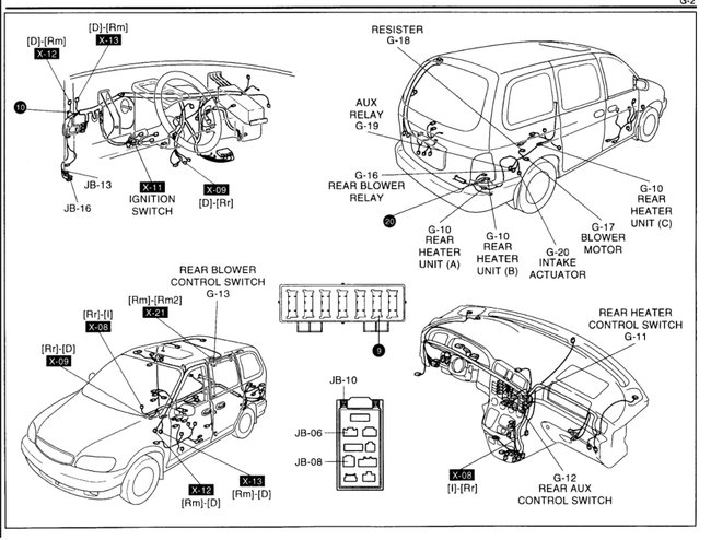

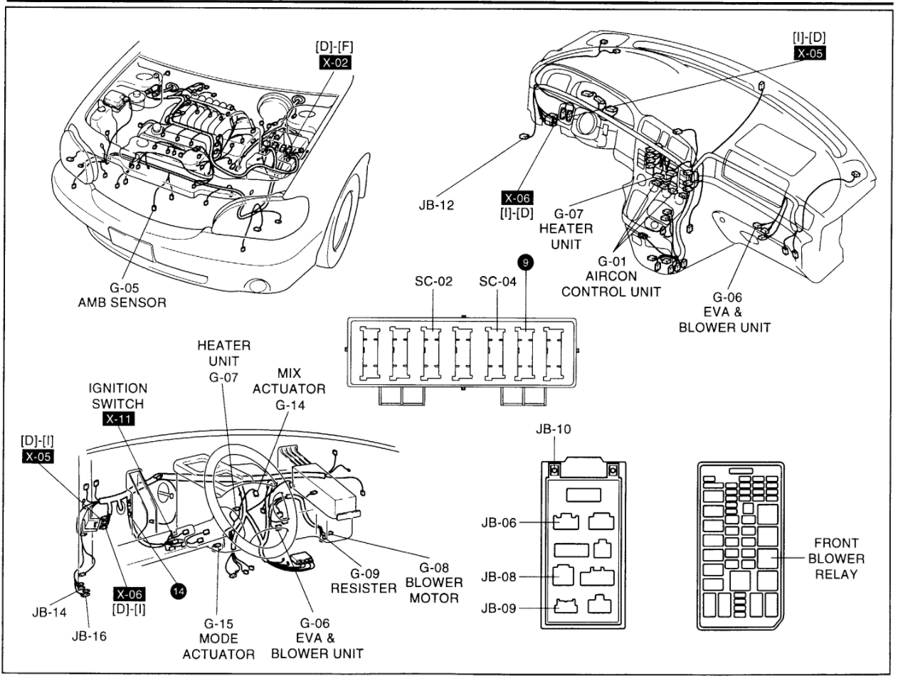

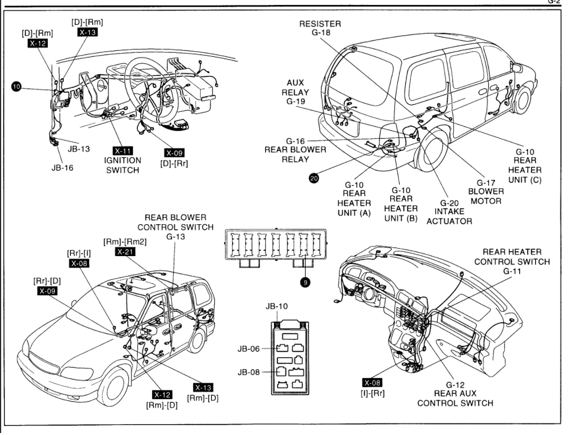

Hello, Here is a guide to help you see what you are in for when doing the job. https://www.2carpros.com/articles/blower-fan-motor-works-on-high-speed-only HEre are diagrams (BELOW) Blower Motor (Front)Behind right side of dash, on blower unit. See Fig. 26 .
https://www.2carpros.com/forum/automotive_pictures/266999_kia_31.jpg
Check out the diagrams (Below) Please let us know if you need anything else to get the problem fixed. Cheers
