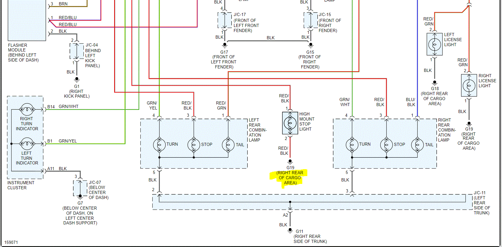

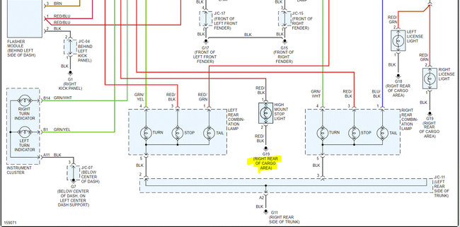

It sounds like the ground is being taken away when the 3rd light is installed. What I need you to do is check the ground for the 3rd brake light. It is separate from the rear tail lamps.
If you look at the attached pic, I highlighted the ground I'm referring to. In the schematic, it identifies the location. Check this and let me know what you find.
Also, here is a link you may find helpful. It explains how to check the wiring under different conditions.
