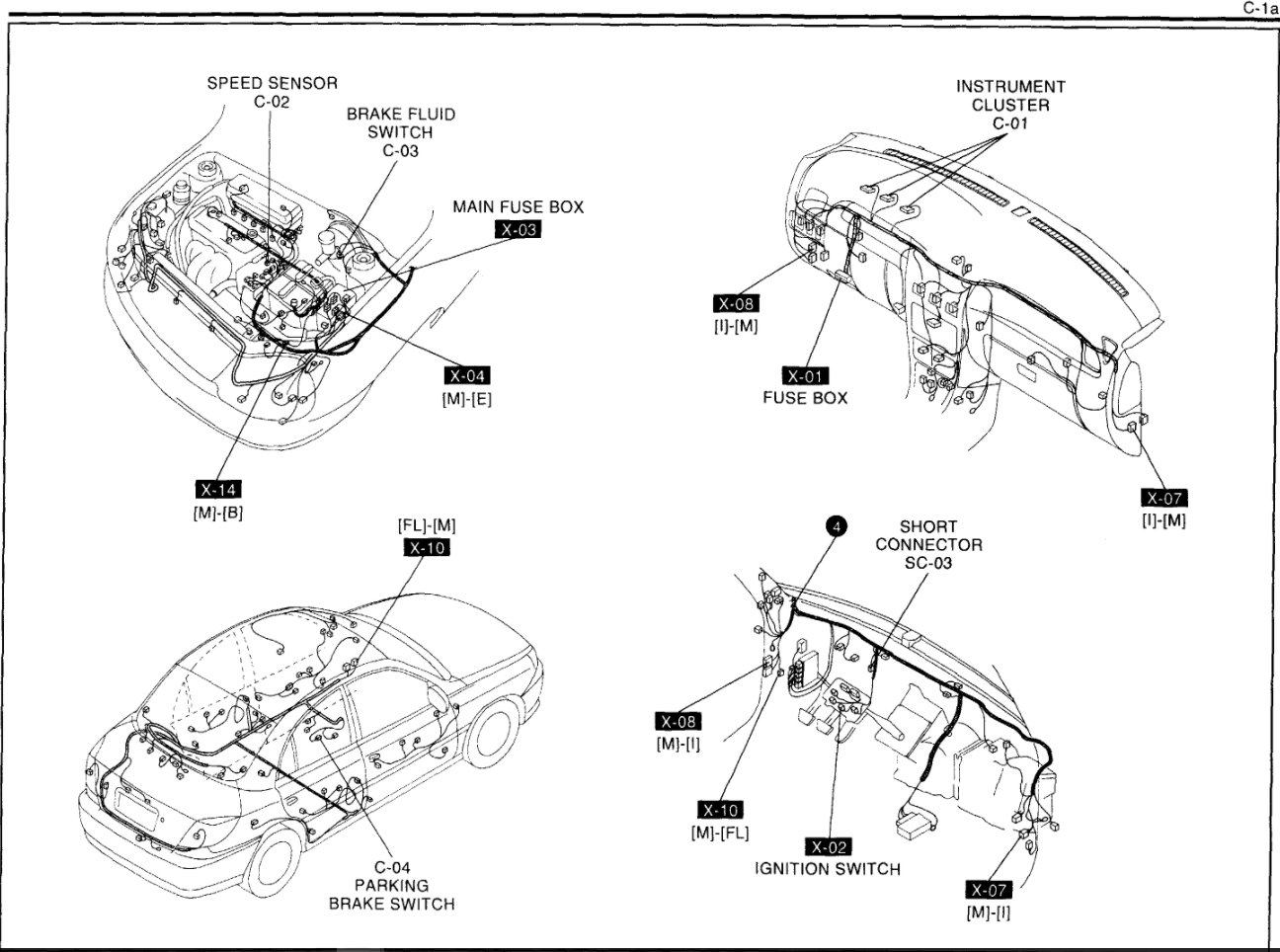

is there a fuse or relay i need to replace as my speedometer stopped working
May 21, 2009 at 8:01 AM
There is a vehicle speed sensor that runs the speedometer located at the rear of the transmission. Here is a diagram that shows it location (below)
