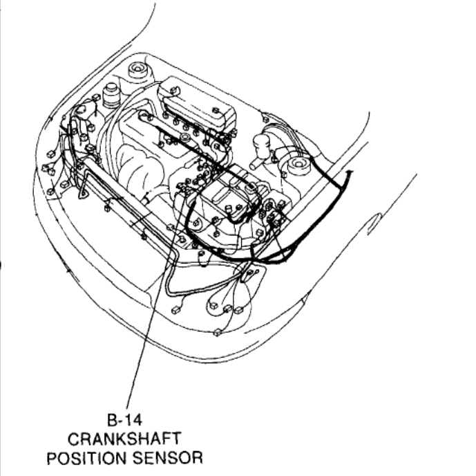

Here is a diagram (below) of the location on your car.
