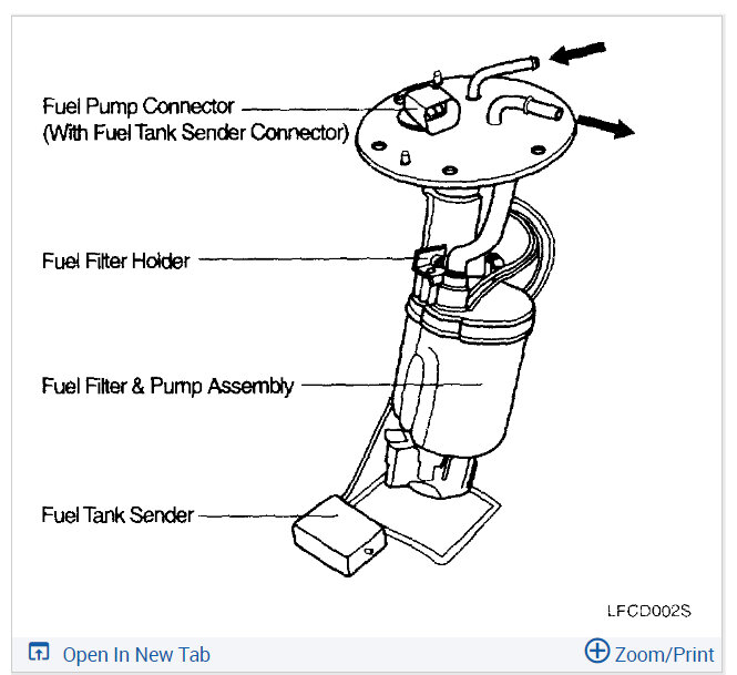

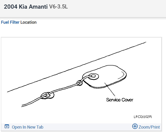

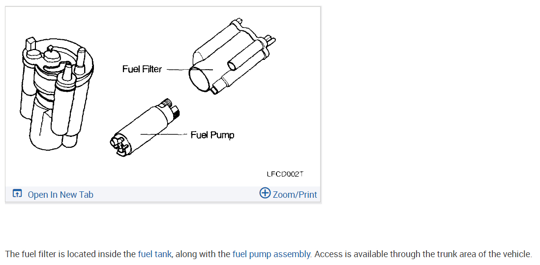

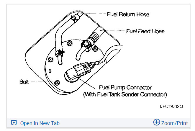

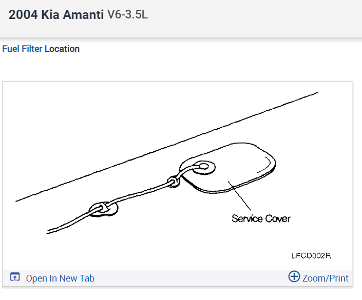

Here is the location of the fuel pump and how to change it. I would install a new fuel pump as well. Check out the images (below). Please let us know what happens.
