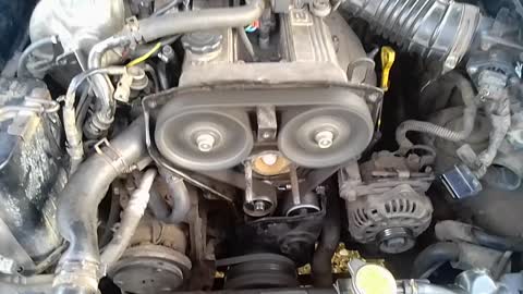

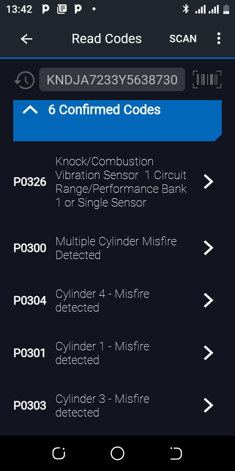

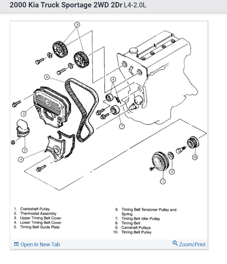

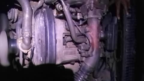

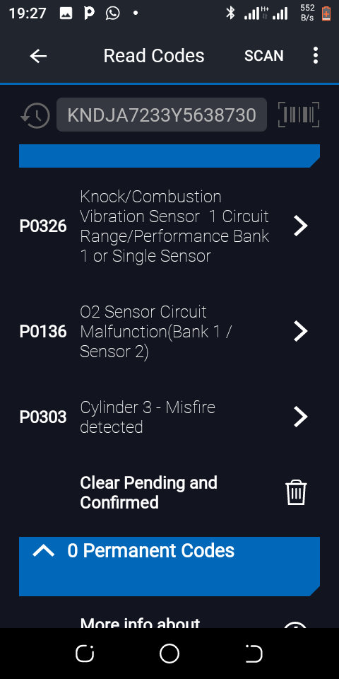

Hello and thanks for the video and picture, it really helps us figure out what's going on. The engine noise could be causing the problem, it sounds like the timing belt is loose which is giving the knock sensor code. Also, can you please check the oil level? Is the engine oil pressure light on by chance? I can hear the noise, but I can't tell if it is internal or the timing belt. I have left a diagram of the belt below. Also try to clear the codes and then start the engine and then run the codes again, we are trying to see what code comes up first. Check out the diagrams (below). Please let us know what you find. We are interested to see what it is.
May 16, 2022 at 7:17 PM

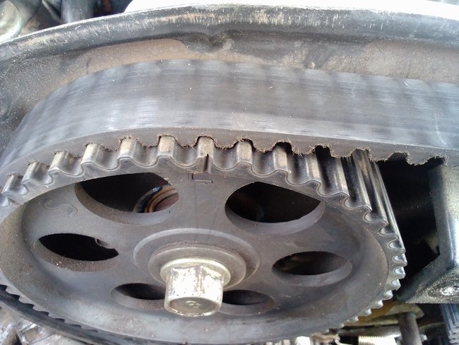

I'm there with the car now. I have just verified the timing and it seems it have jumped timing by a tooth.

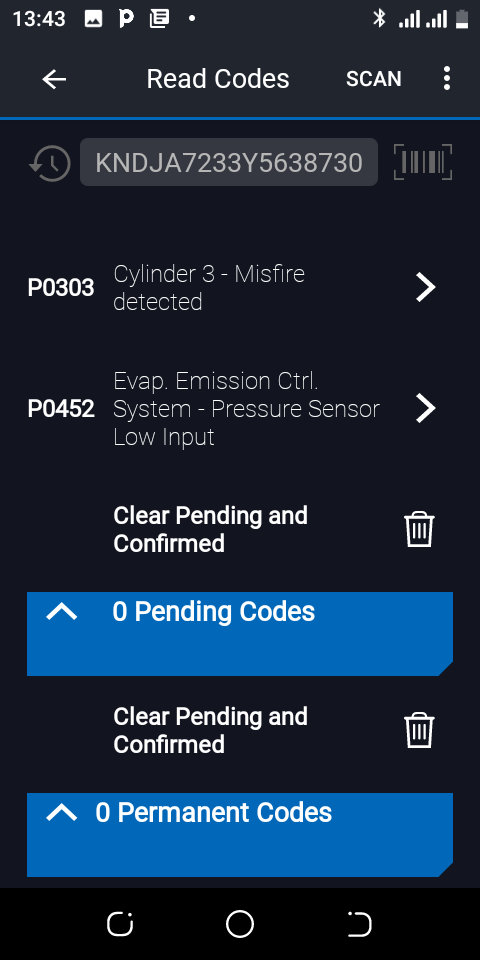

Additionally, when I checked for codes today more codes came up.

Yes, it looks like it, is the belt loose as well? I would not worry about the codes as long as the belt is off. I would replace the belt with a new part and go from there. How was the engine oil condition?

As you rightly said the belt was still intact however the timing was off. It seems as if it keeps jumping timing.
In addition, I was sniffing a strong fuel odor from the exhaust when the car was idling so I can scan for codes. Sorry I didn't include that on the details of the car problem initially. After timing work the fuel odor wasn't too strong as before.

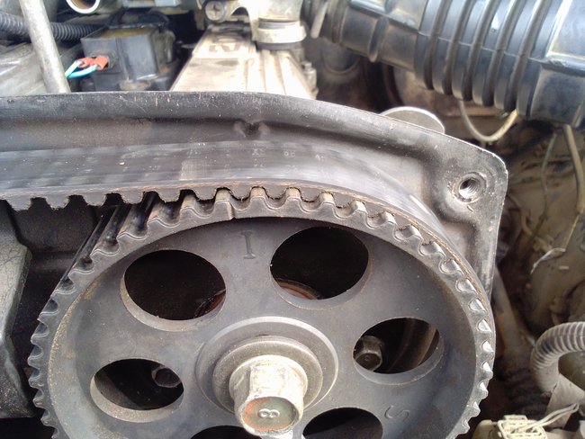

I have reset the timing of the car. Now this is the present state of the car after the timing work.

It sounds like you may have a stuck injector, I would remove the spark plugs and see which one is different, this will be the cylinder that is having an issue. This guide can help you test the injectors:
