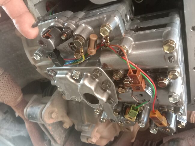

When the fluid was changed the pan and filter were removed and cleaned. The attached pics are of the solenoids.
If replacing solenoids is considered necessary, then I need a recommendation for a reliable supplier that will ship with an online order. Solenoids are not available from parts suppliers locally.

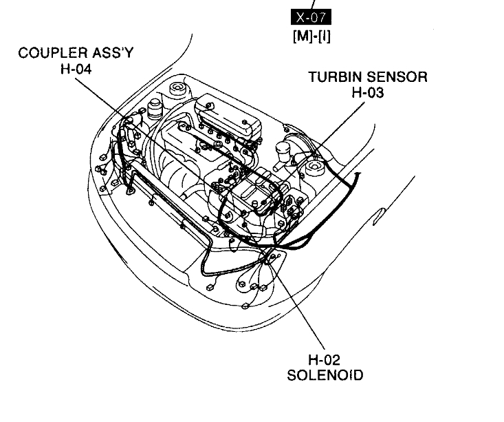

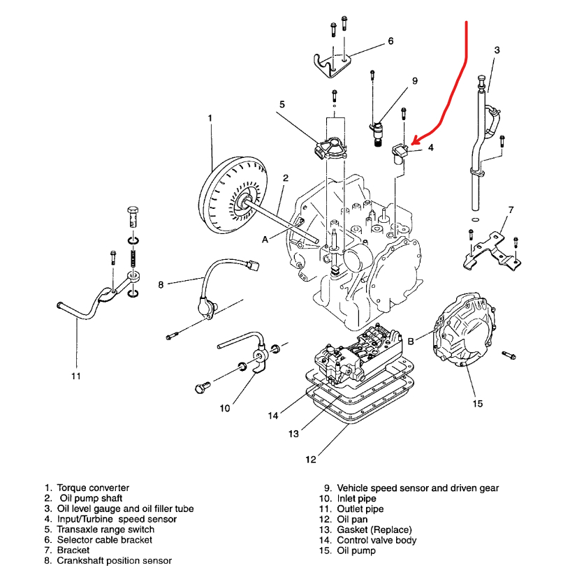

I have seen the turbine shaft speed sensor go bad and not leave a code. here is the location for the sensor so you can check it out. Check out the images (below). Please let us know how it goes.

I cannot see the sensor, I need to remove the air filter box/duct, battery support, coolant water hose etc., to gain access. If I have difficulty identifying it, I will send pics.

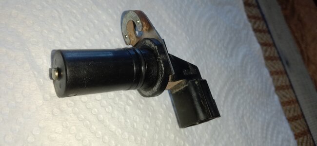

In heavy rain I got the sensor out, pic attached.
Can you tell me if this sensor can be tested and how to do before I try and find one overseas online?

Sure, though it is not a 100% test use a voltmeter on OMHs and attach them to the terminals. it should be about 0.2 OHMs if the sensor is good, if it is over 1.0 ohms replace the sensor.
