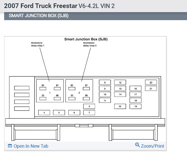

Here is the information we have on the location and replacement instructions for the alarm control module.
The Alarm control module is part of the SJB (smart junction box) behind the left side of the dash.

Check out the images (below). Please let us know if you need anything else to get the problem fixed.
