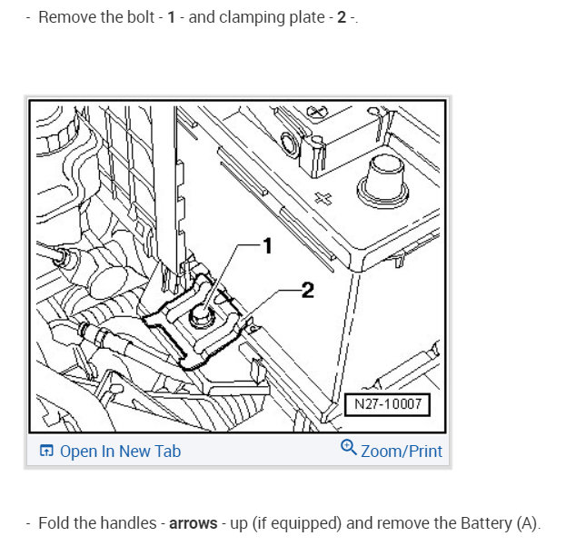

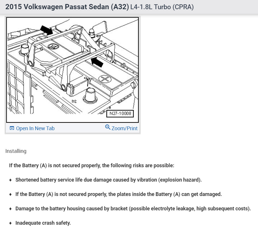

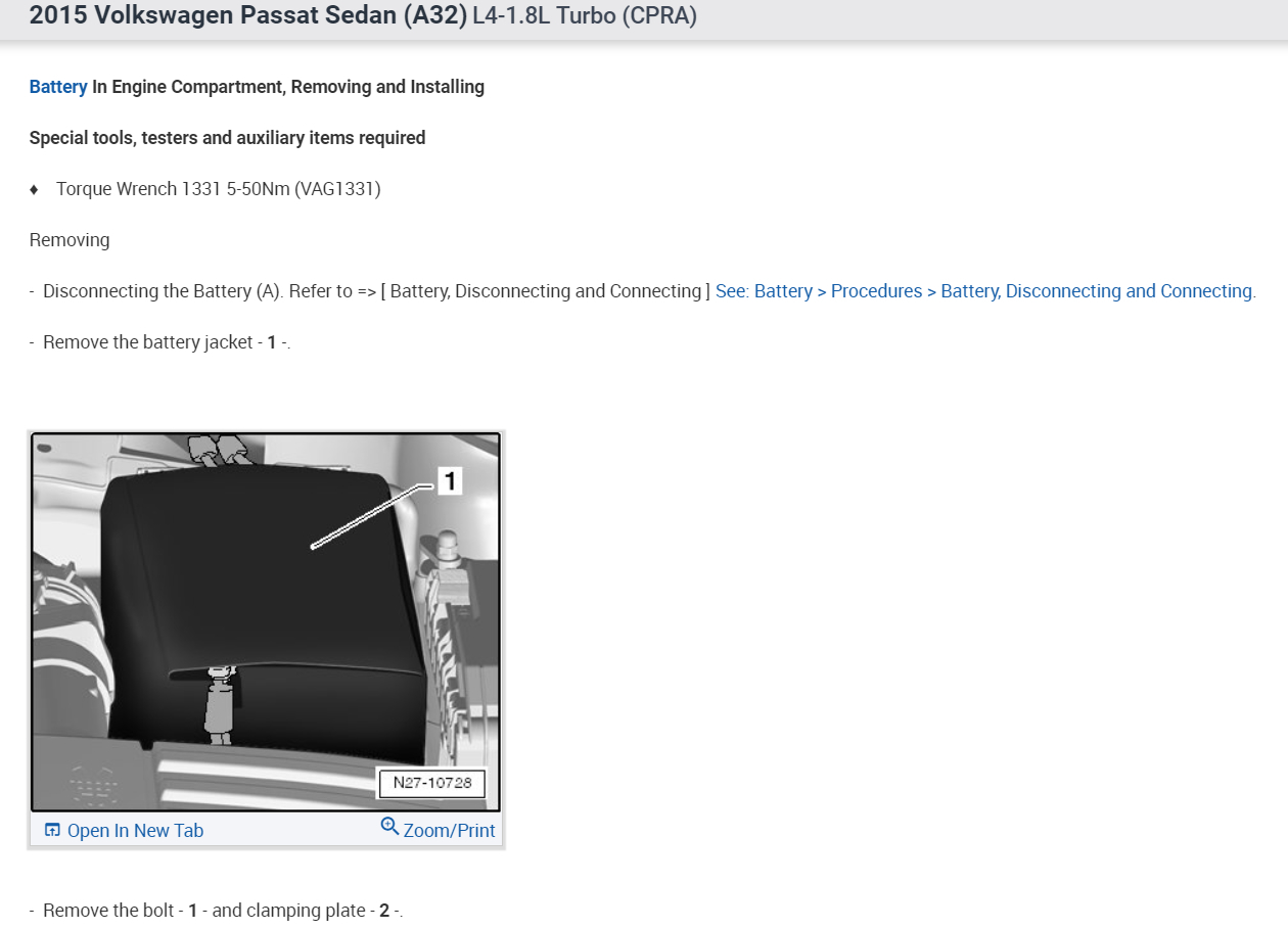

It sounds like the battery has shorted out which will not respond to a jump but to be sure here is a guide to help us load test the battery and if it fails a guide to show you step by step on how to change the battery with diagrams below to show you how on your car.
and
https://www.2carpros.com/articles/how-to-replace-a-car-battery
Check out the diagrams (Below). Please let us know what you find. We are interested to see what it is.
