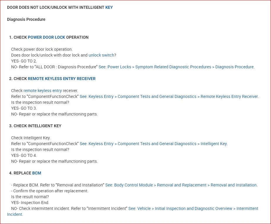

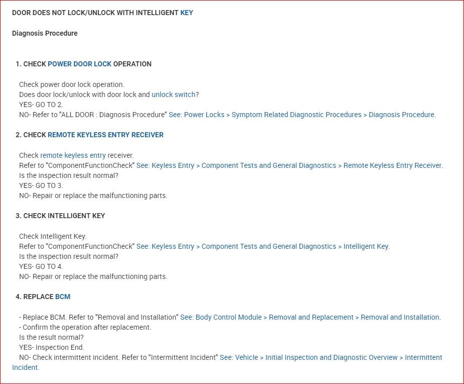

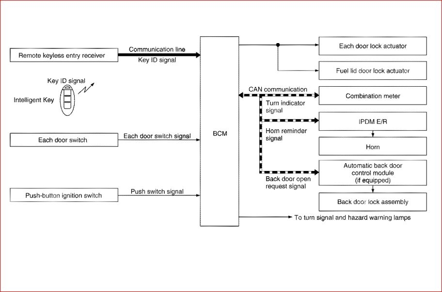

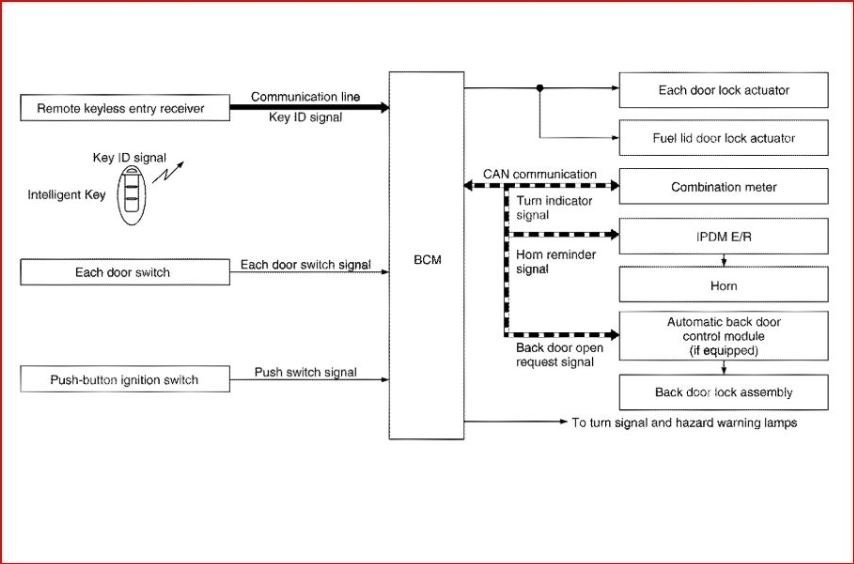

I attached the test if the door locks did not work all the time. I know this is not the case but it helps explain what the issue could be. Then take a look at the diagram of how your system works.
If the key is good, then the issue appears it could be the remote receiver or BCM itself.

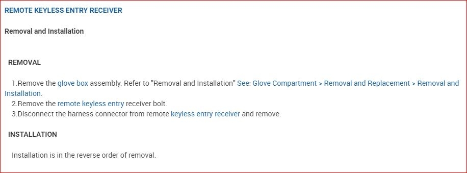

3. Finally, it sounds as if you think that the receiver is more likely the problem than the BCM. I'm not a mechanic but pretty handy. Could I replace that myself, or is it too complicated?

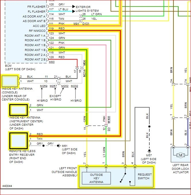

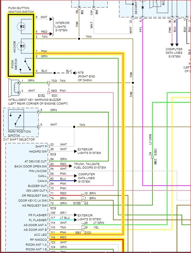

3. I may have misunderstood which was not working. The fact that all operation with your remote are working shows that the remote key-less entry receiver is functioning. However, the two systems that relay on your proximity and the antennas placed around the vehicle to locate the key seem to be your issue. If you look at the third attachment, these inputs to the BCM are separate and direct inputs. This would point more to the BCM.
