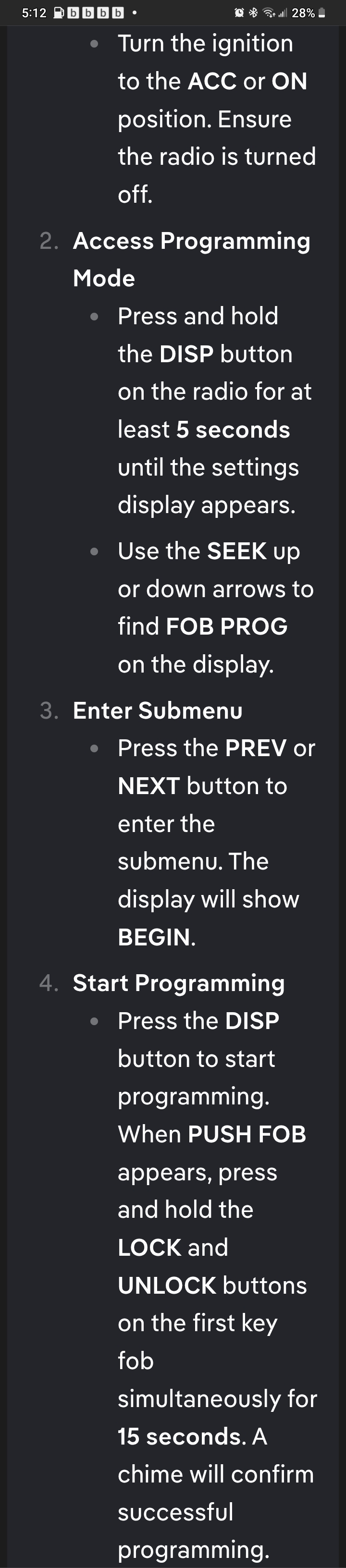

My key fob quit working. I bought 2 new ones and tried to program them without success. Batteries are good. I am now thinking it might be a bad receiver. Am I on the right track, and if so, can you tell me where it is located?

Could you tell me the method you used to program the new remotes into the system? I normally use a scan tool to program them as I know that works. There are a few methods out there that only work on specific versions of the vehicles software.

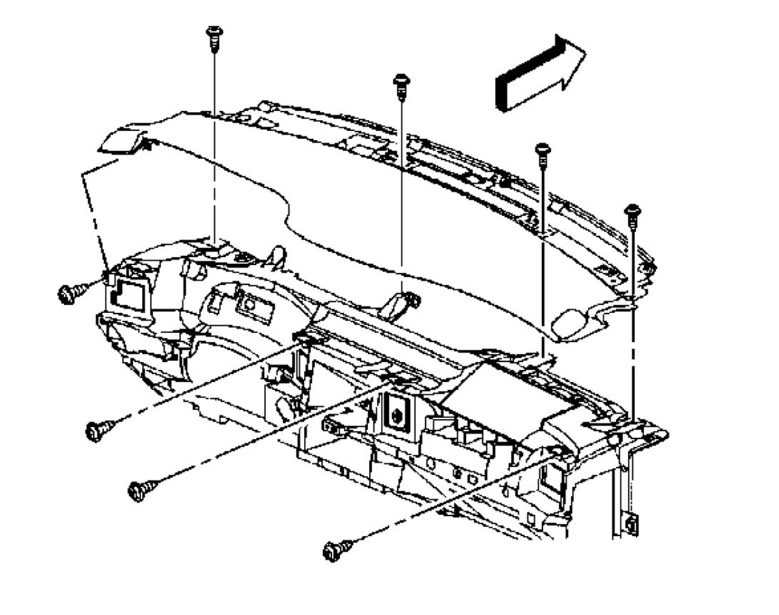

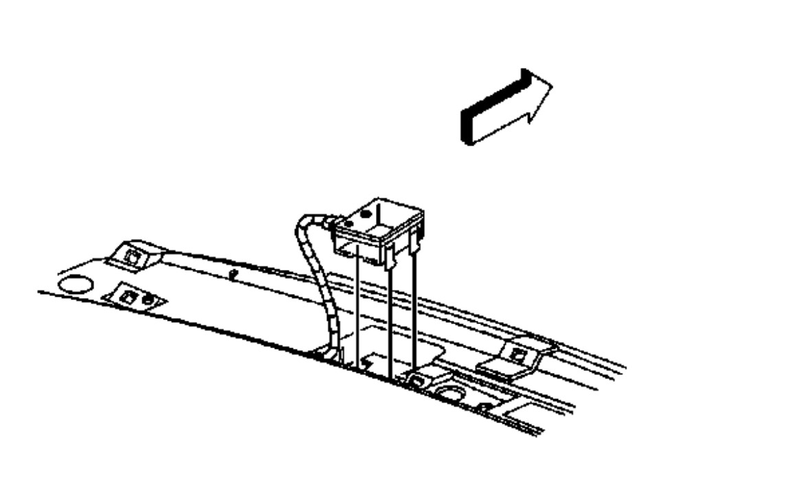

That said the RKE receiver is under the upper dash trim panel in the middle of the vehicle. However I would use a scan tool first as it can test the module to see if it is operational and you would need the scan tool to get the replacement module to operate as it needs to be programmed into the PCM. You could also drop into any automotive locksmith and have them test your fob to see if it is or isn't operating. Did you try the resync mode? For that stand next to the car and hold the lock and unlock buttons down for 7-10 seconds the horn should beep if successful.

I followed this step x step online. I tried with old fob and 2 new ones. I decided that receiver might be bad, since I had same result with all three.

Changing it out requires that the two side trim panels for the windshield be removed, then the trim around the instrument panel, then you GENTLY pry up the defrost grid. Then remove all of the screws that hold the upper pad in place. Flip it up and under it you will find the RKE receiver clipped in place. I might try unplugging the connector and checking for corrosion and maybe reseating the connector a few times if the connection looks dirty. If it looks OK, then replace the receiver. Then you need to program in the remotes again.

I replaced receiver and all working fine for now. One thing that had me going in circles, though. I didn't realize that, if you don't program all in same session, only the last one will work. Previously programmed remotes are not recognized by receiver. Thanks for your help.
