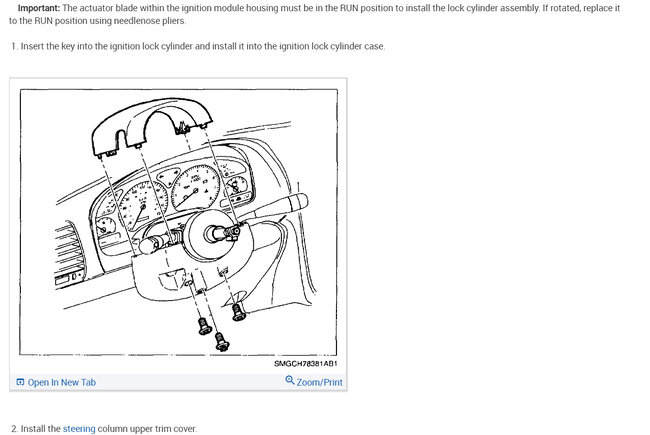

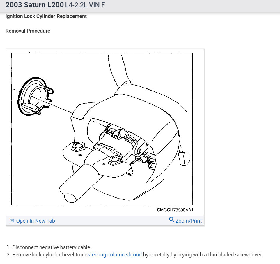

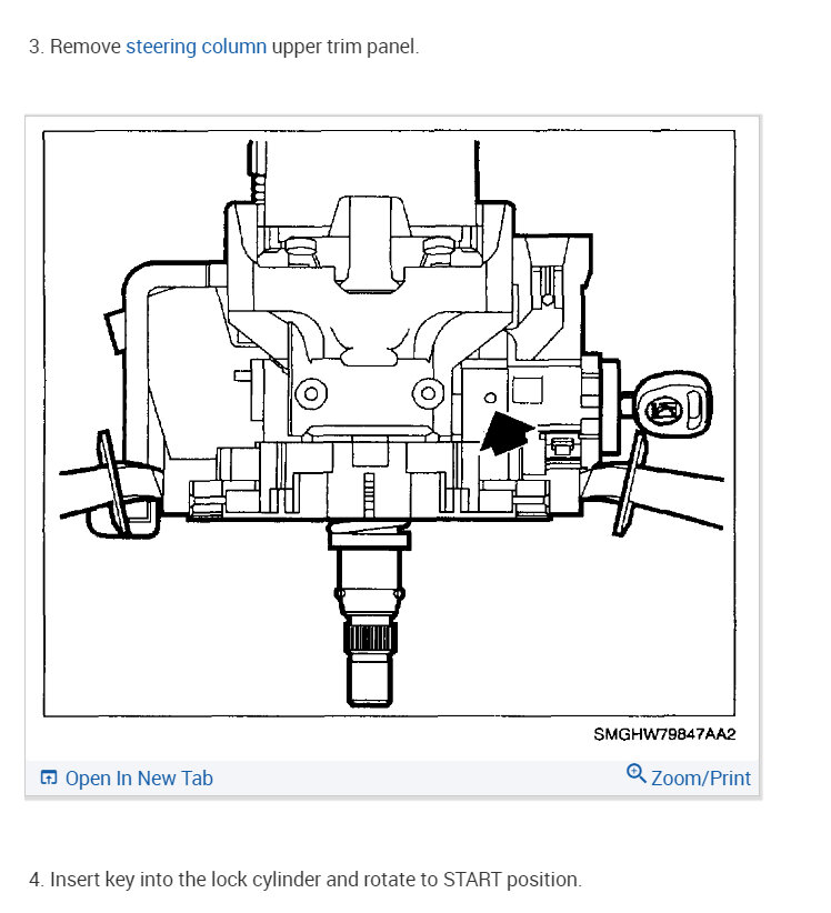

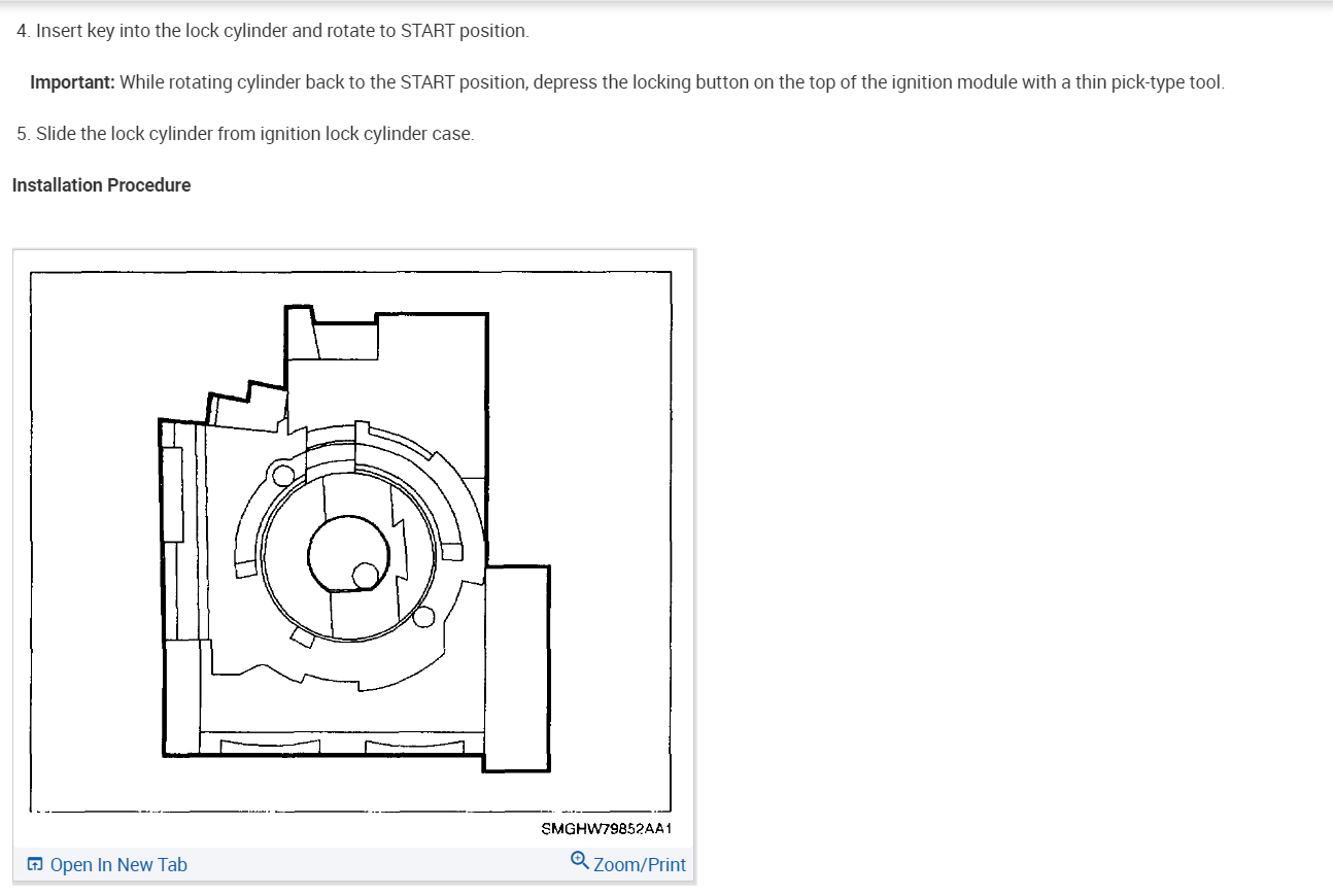

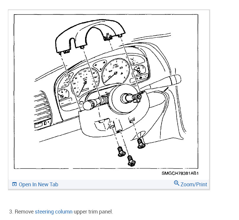

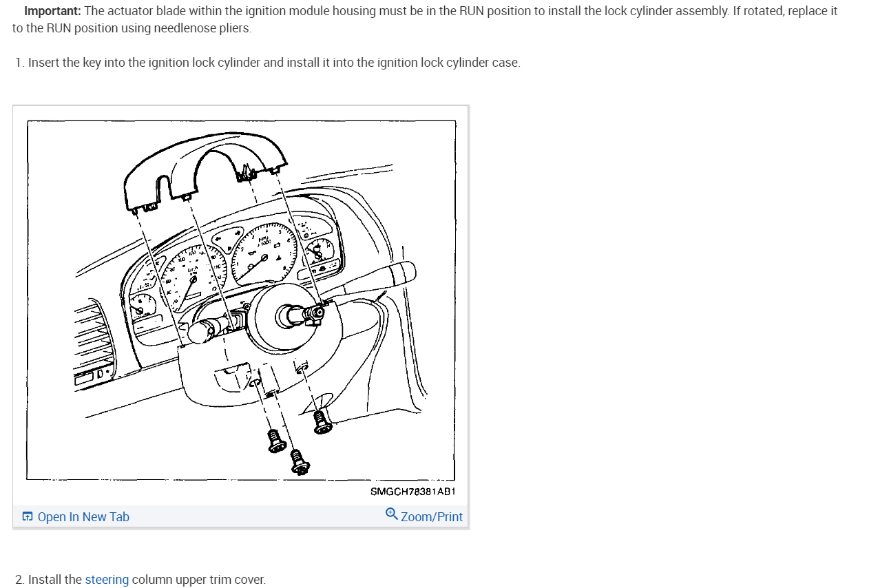

Yes, this happens when the key lock falls apart internally. Here is how to change it out I would get a new key and lock that is preprogrammed you can get a preprogrammed unit by searching Google or Ebay.
