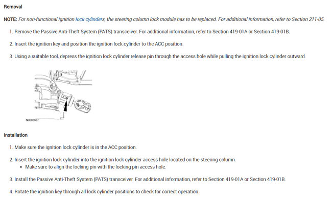

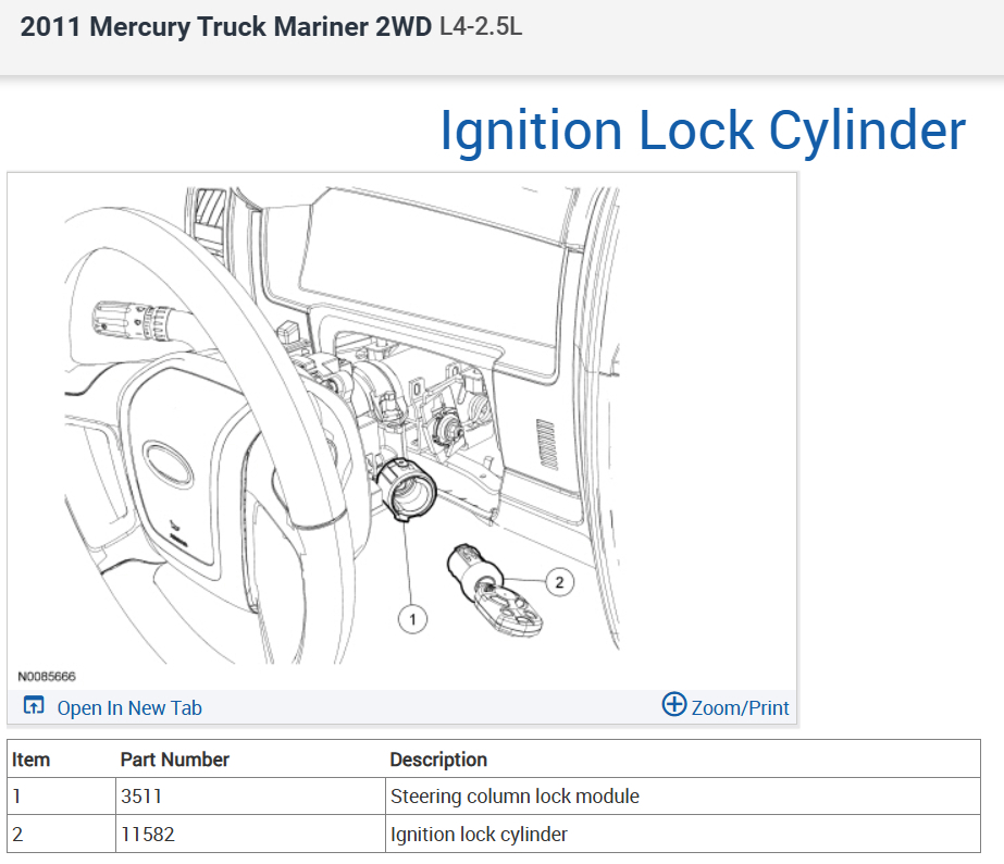

If none of these work, you will need to replace the ignition lock because it has come apart internally. Here is how to change it out. Check out the images (below). Please let us know what happens.
