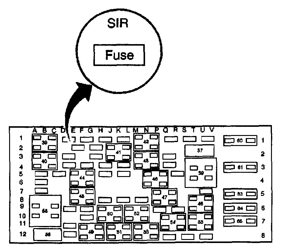

5. Remove the SIR fuse from the rear fuse block.

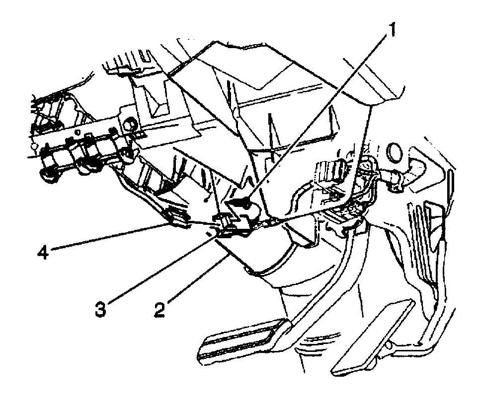

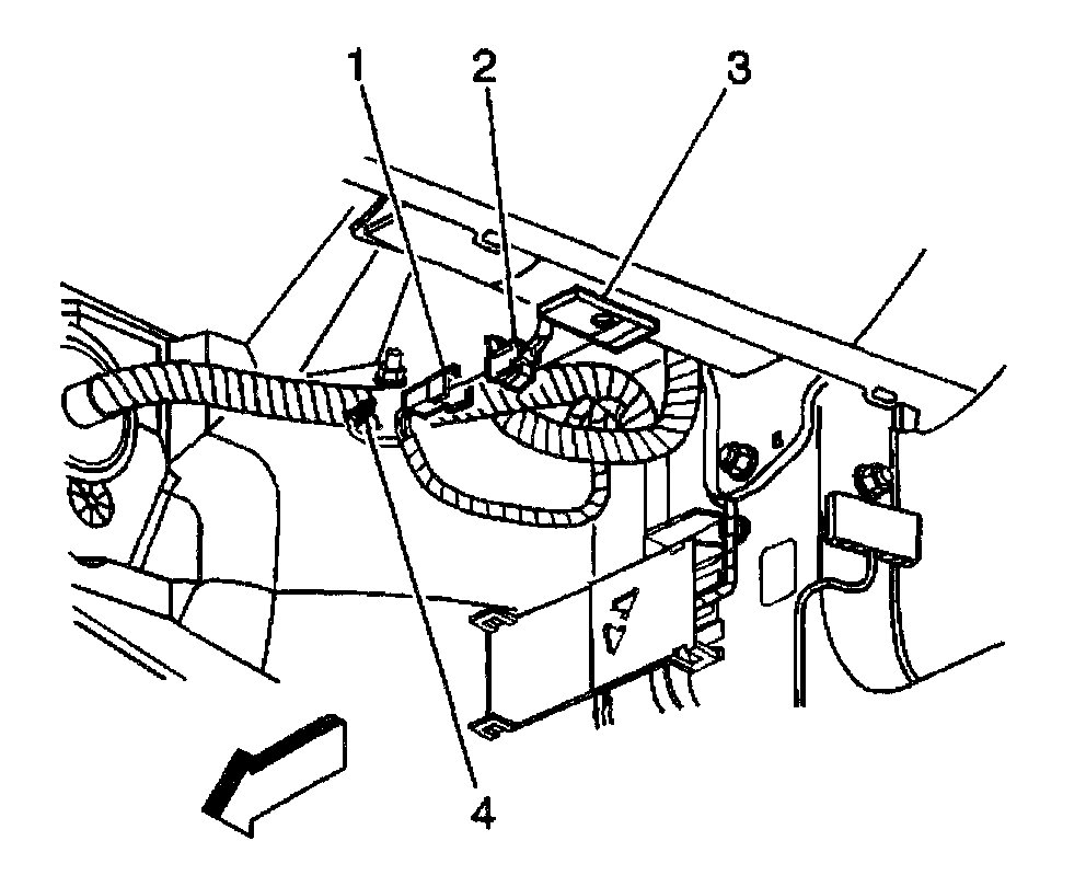

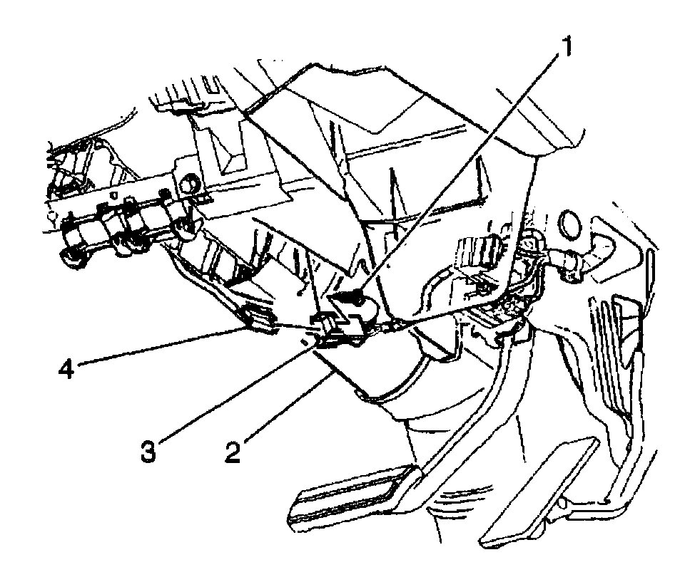

7. Remove the Connector Position Assurance (CPA) (1) from the driver yellow connector (3) located next to steering column (2).
8. Disconnect the driver frontal air bag yellow connector (4) from the vehicle harness yellow connector (3).
9. Remove the passenger sound insulator.
10. Remove the Connector Position Assurance (CPA) (4) from the passenger yellow connector (1) located above the passenger sound insulator.
11. Disconnect the passenger (IP) frontal air bag yellow connector (2) from the vehicle harness yellow connector (1).

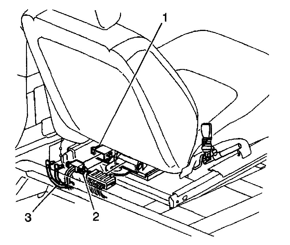

12. Remove both Connector Position Assurance (CPA) locks (3) from the driver side (seat) air bag and pretensioner yellow connector (1) located under the driver seat.
13. Disconnect the driver side air bag and pretensioner yellow connector (2) from the vehicle harness yellow connector (1).
14. Remove both Connector Position Assurance (CPA) locks (3) from the passenger side (seat) air bag and pretensioner yellow connector (1) located under the passenger seat.
15. Disconnect the passenger side air bag and pretensioner yellow connector (2) from the vehicle harness yellow connector (1).

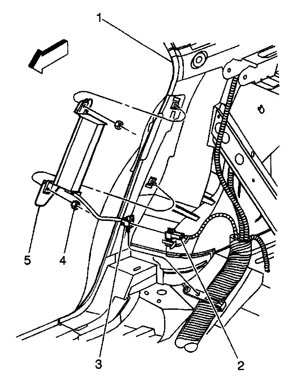

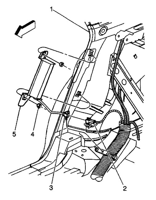

16. Remove the rear seat back.
17. Remove the Connector Position Assurance (CPA) from the passenger rear side air bag yellow connector (3).
18. Disconnect the passenger rear side air bag yellow connector (3) from the vehicle harness yellow connector (2).
19. Remove the Connector Position Assurance (CPA) from the driver rear side air bag yellow connector (3).
20. Disconnect the driver rear side air bag yellow connector (3) from the vehicle harness yellow connector (2).

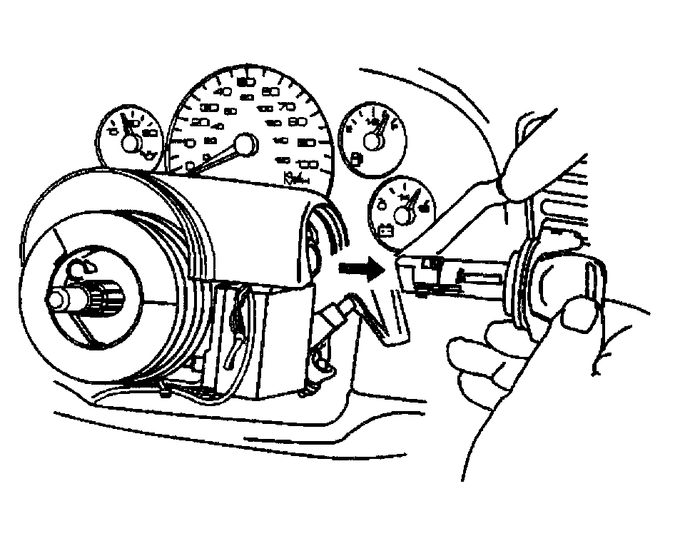

Cylinder replacement
IGNITION LOCK CYLINDER
Ignition Lock Cylinder Replacement - On Vehicle
Removal Procedure
1. Disable the SIR system. See: Air Bag(s) Arming and Disarming > Procedures
2. Position the steering wheel half way between the upper and lower tilt stops (if necessary).
3. Remove the steering wheel. Refer to Steering Wheel Replacement.
4. Roll back the shift lever seal from the upper and the lower shrouds.
5. Remove the tilt wheel lever (if necessary).
6. Remove the 2 TORX screws from the lower steering column shroud.
7. Remove the lower steering column shroud.
8. Remove the one TORX screw from the upper steering column shroud.
9. Lift the upper steering column shroud to gain access to the lock cylinder access hole.

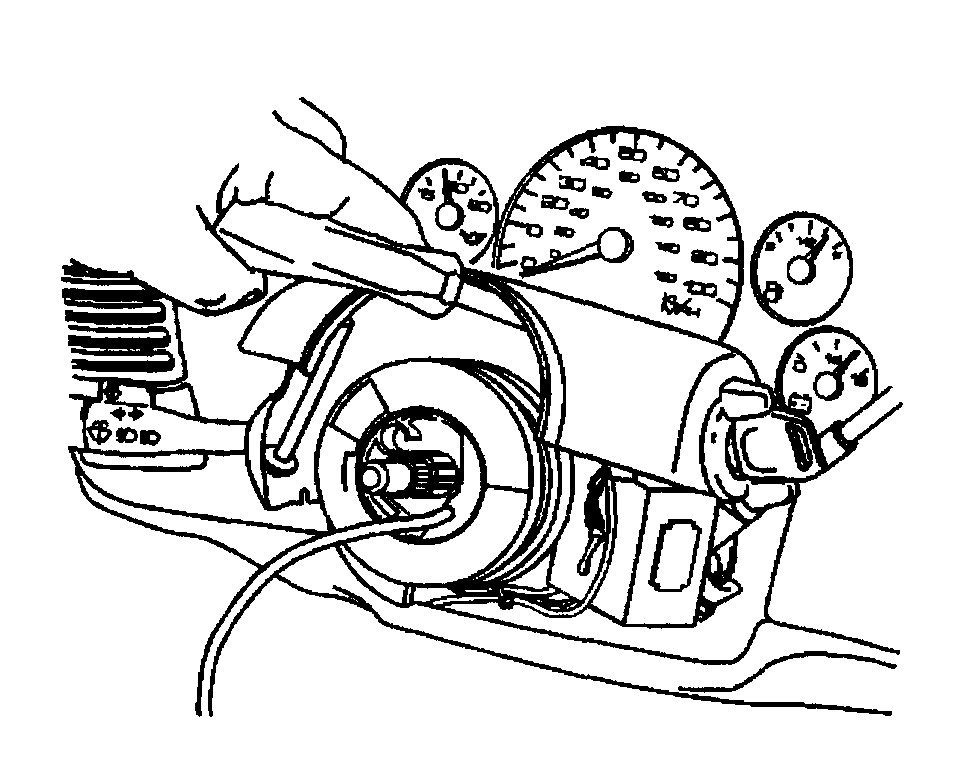

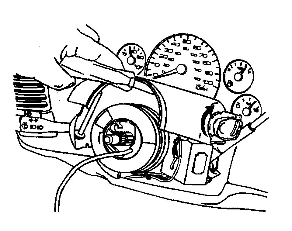

10. Turn the ignition lock cylinder to the START position.
Using the bent tip awl, push down on the ignition lock cylinder retaining pin.
11. Release the ignition lock cylinder to the RUN position.

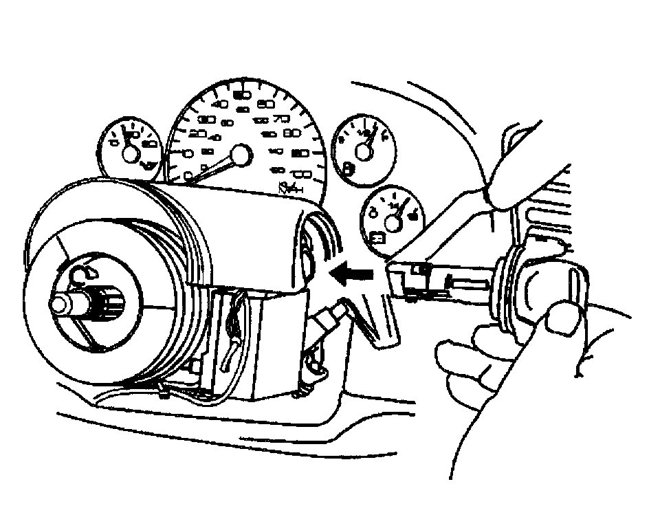

12. Remove the ignition lock cylinder from the lock module assembly by pulling the ignition lock cylinder away from the steering column.
Installation Procedure
1. Insert the ignition lock cylinder through the upper shroud.
2. Install the ignition lock cylinder to the lock module assembly by doing the following:
2.1. Align the positioning slot and locking tab slot on the lock module assembly to the positioning tab and locking tab on the ignition lock cylinder.
2.2. Push the ignition lock cylinder into the lock module assembly until the locking tab locks against the locking tab.

17. Rear fuse block is located under the rear seat.
18. Install the SIR fuse to the rear fuse block.
