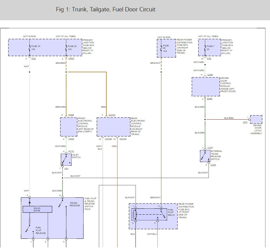

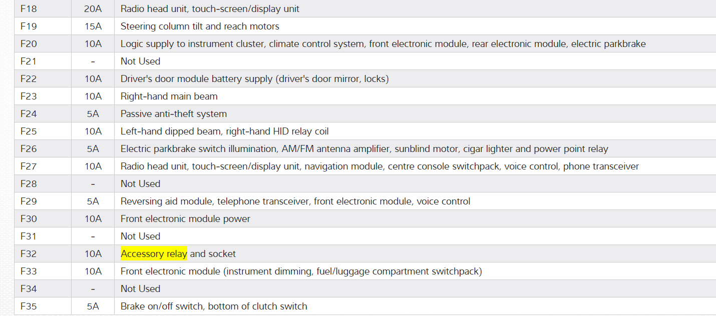

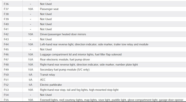

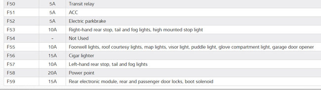

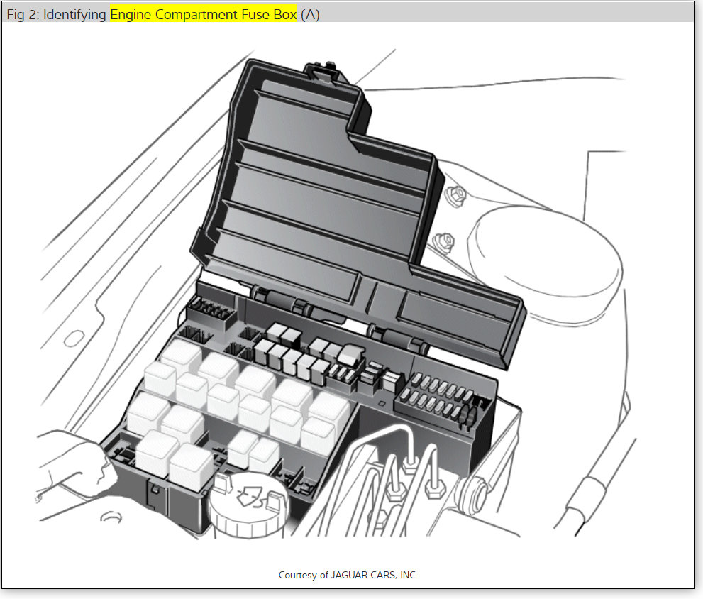

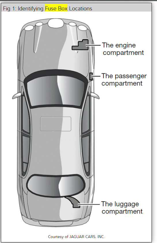

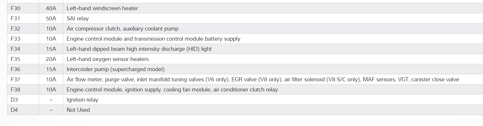

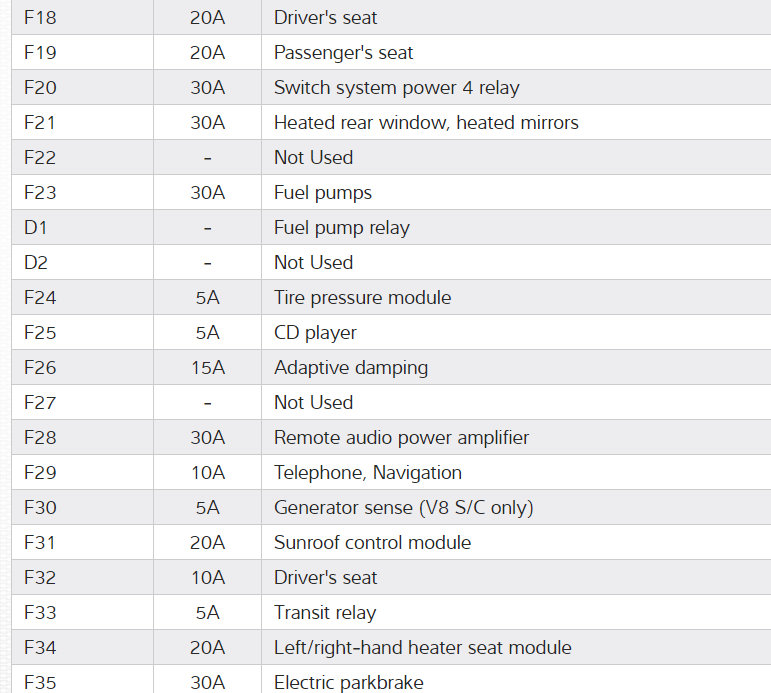

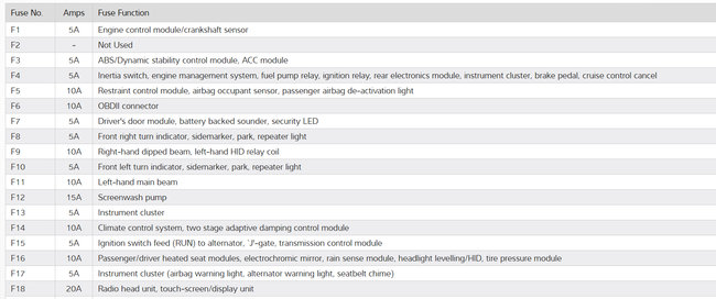

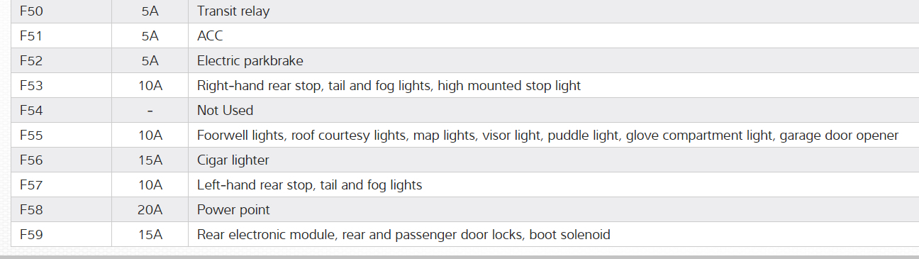

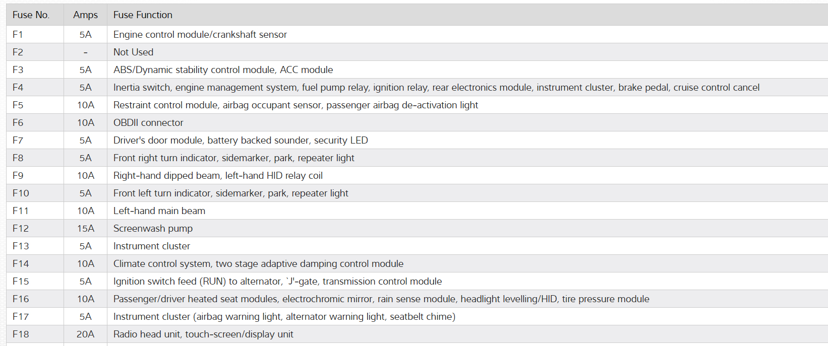

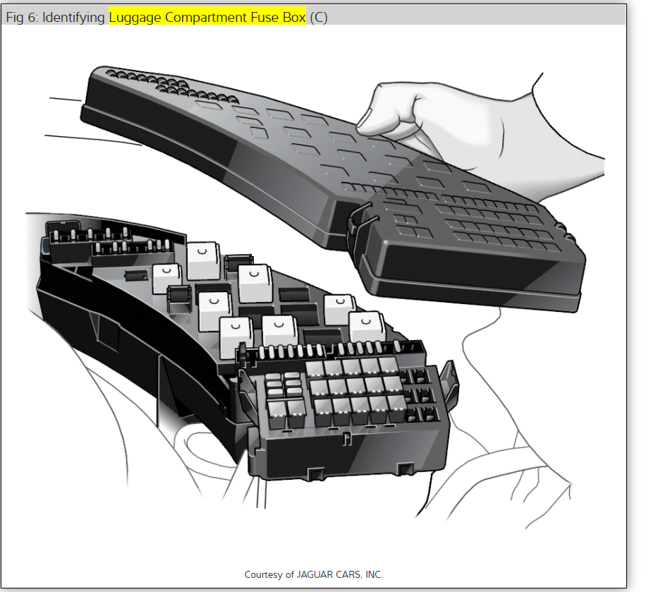

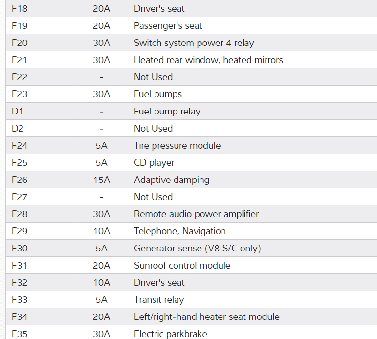

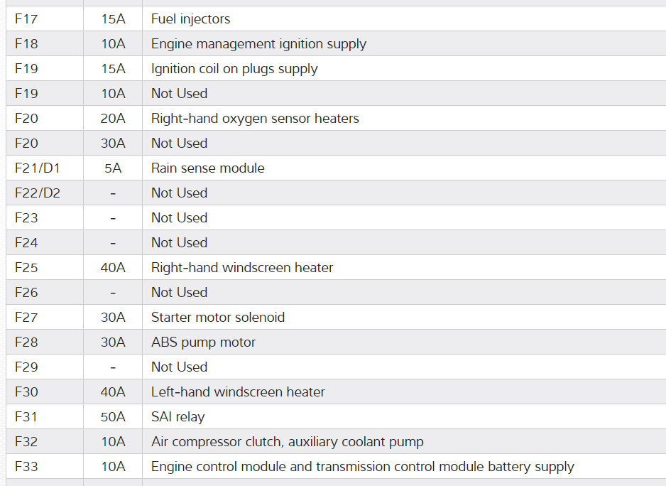

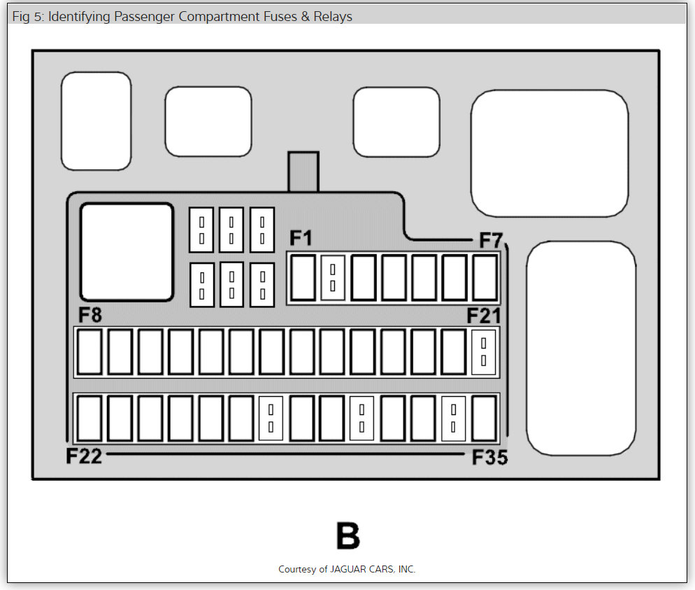

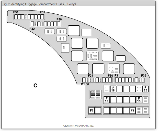

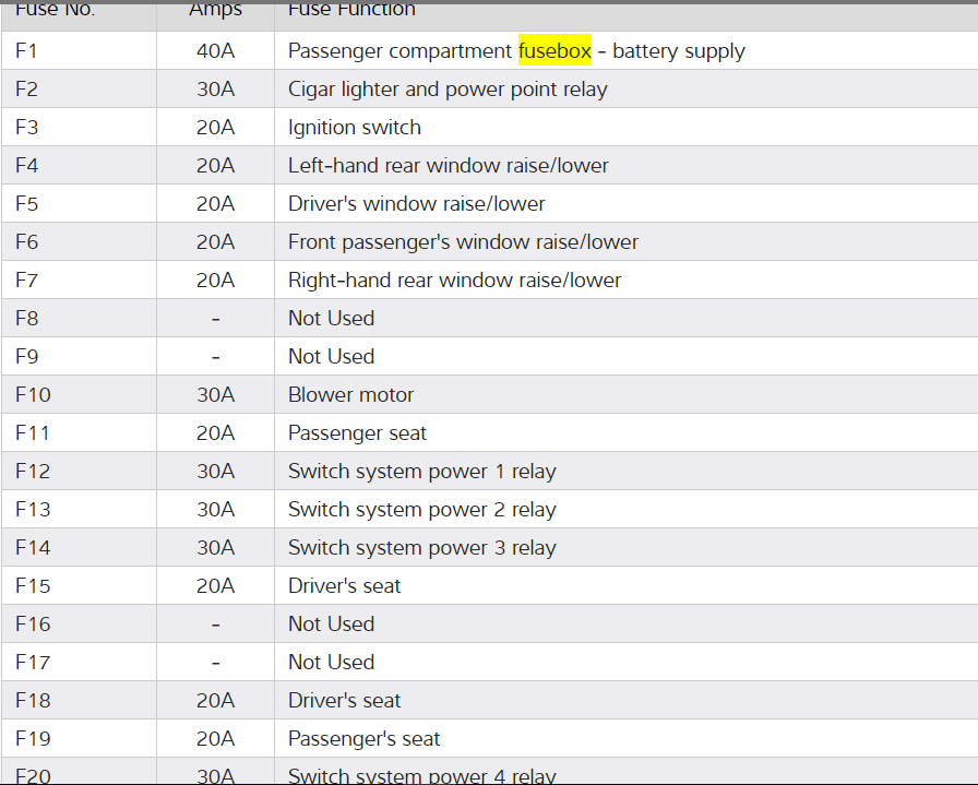

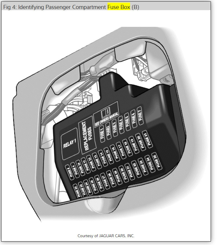

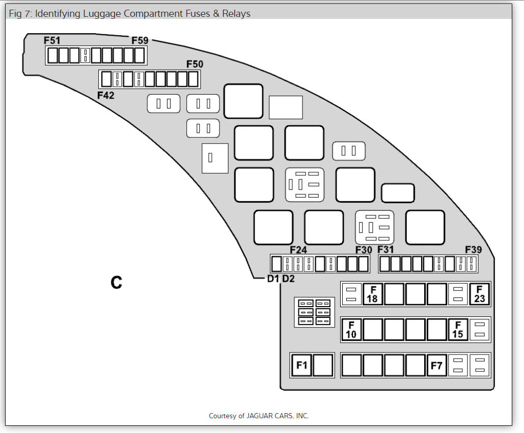

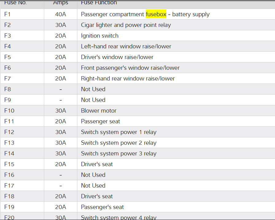

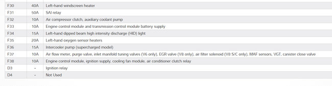

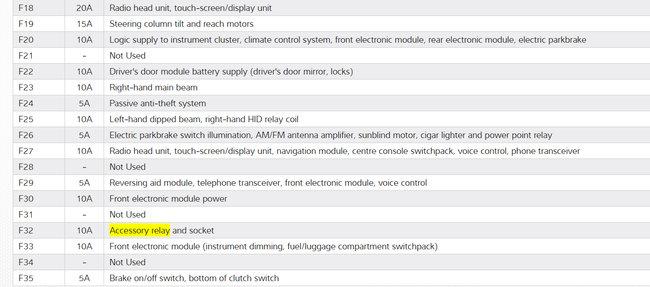

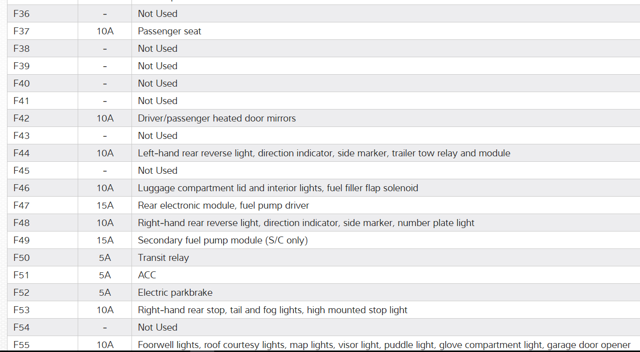

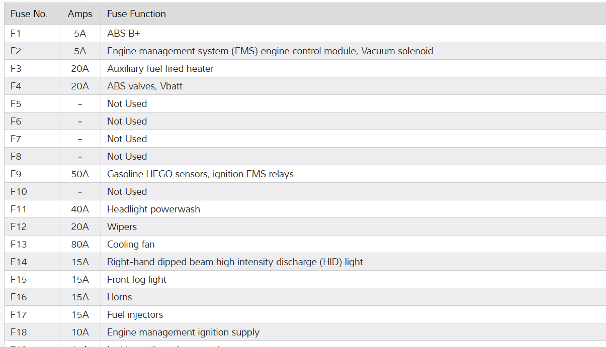

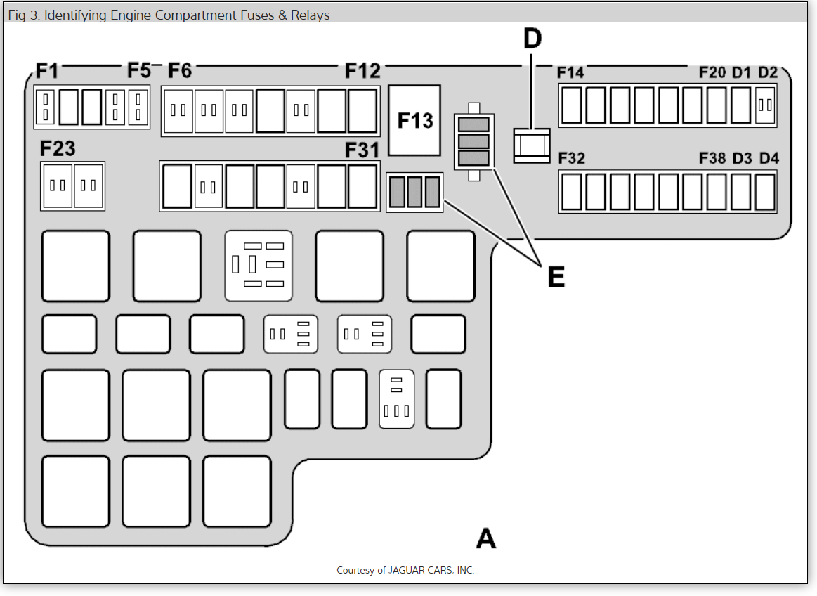

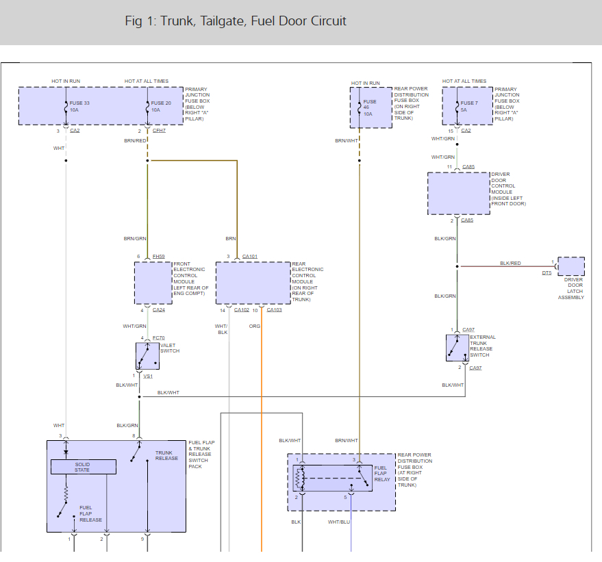

We should start by checking the fuses because if one is blown the trunk will not open. Here is a guide to help us get started. Check fuse #33, 20, 46 and 7.

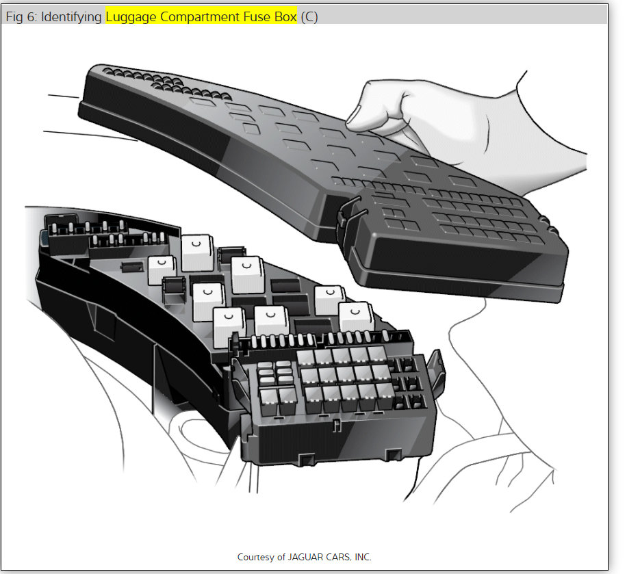

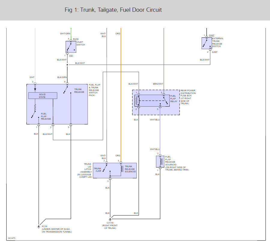

Here is the trunk wiring diagrams and fuse panel location and identifications (below) so we can see how the system works.
