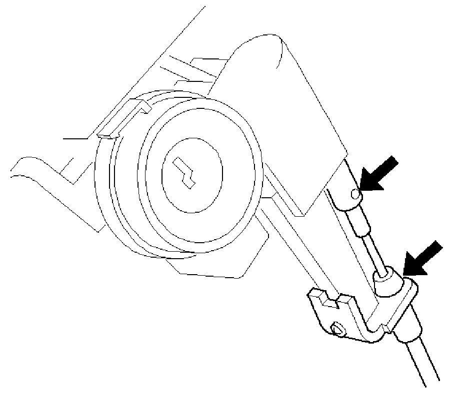

2. Remove knee pads, cluster upper cover, center cluster assembly, rear console, and front console.
Picture 1

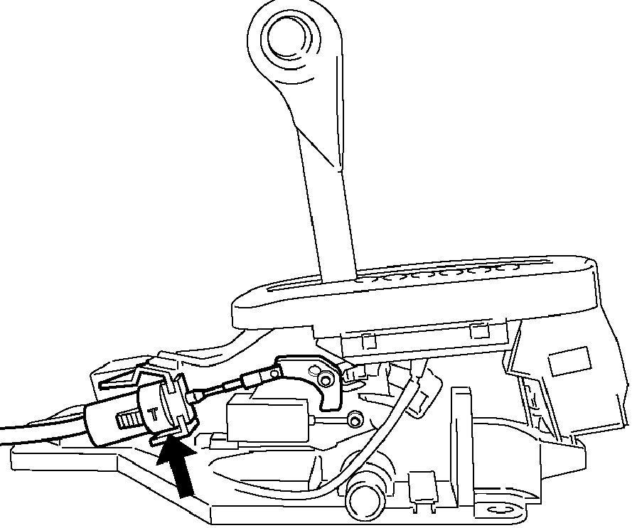

3. Disconnect inner cable from selector lever assembly then push claw and disconnect cable assembly.
Picture 2
4. Disconnect lock adjust.

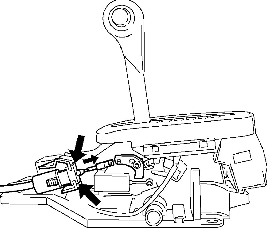

5. Remove instrument panel lower cover and steering column cover.
Picture 3
6. Remove spring pin and disconnect inner cable.
^ Disconnect outer cable from bracket.

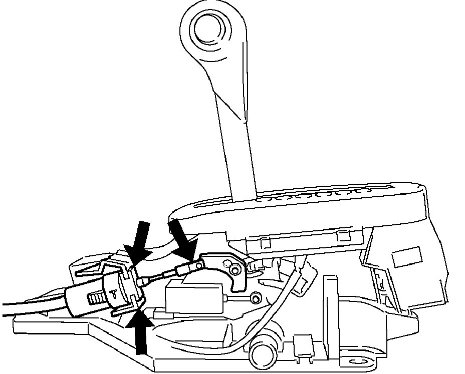

3. Install steering column cover and instrument lower cover.
Picture 4
4. Install adjust body of cable assembly to bracket in selector lever assembly.
^ Install inner cable to lever, pulling inner cable with outer cable.
